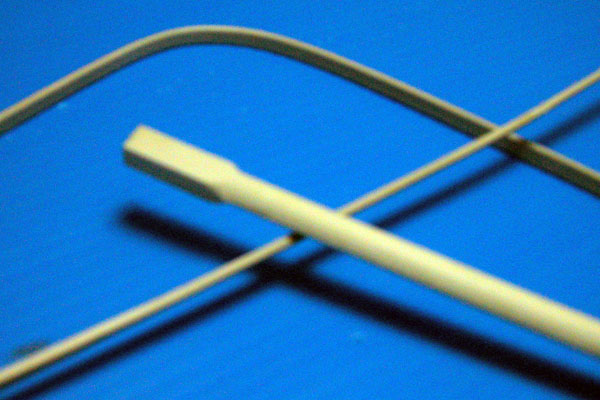

And I suppose we can add "solid sheet with lightening holes" to the list. I guess we could also be talking about stab cnstruction.
And let's not forget the Asian option: Steamed bamboo + bamboo chopstick! (Experimental but VERY resistent and VERY light!)

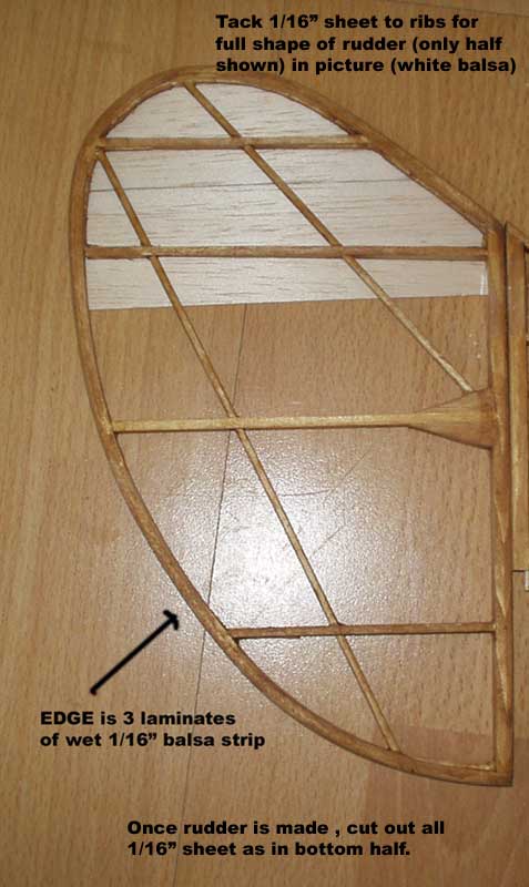

There is also my favourite way for "rounded" tailsurfaces Don. Build the ribs and spars as a conventional wing. Then "tack" 1/16" balsa sheet between ribs where the edges are curved. The 1/16" sheet follows the edge curves of the tailsurfaces. Once done I then soak 1/16" x the thickness of the tail, strips of balsa and glue 3 laminates to the ribs and 1/16"sheet using thick cyano(one laminate at a time). The CA dries very fast as the wood is wet so you only hold in place for a few seconds as you work your way round the outline. Once dry..the 1/16" sheet is cut out so only the spars ribs and edges are left...sand to shape. Very strong as the cyano hardens the edge laminate. Thats how I did the curvy profile of the Jenny and Batboat. Proctor use cane/bamboo for the edges but I didnt have access to any ..and even if I did ..would probably do it the way I did..

Donnie, I'm having trouble visualizing this. You wouldn't have a photo would you? The Nieuport rudder doesn't have much in the way of "ribs" or "spars" In fact very little structure for such a big surface.

Don..I knew I was toiling trying to explain it..Picture tells a better story ?

Well my first effort at Donnie's technique was a total cock up. All I ended up doing was wasting half a bottle of CA and several hours of time. At the moment I'm sortly tempted to go back to the old fashion Guillow's arrangement of curved pieces. In short the balsa would NOT bend even when soaked and cracked all over the place. In pure frustration I tried a bit of "gorrilla" construction whereby you just CA the h**l out of it, zap with fixer, and sand the crud out of it. I ended up putting the mangled result out of its misery by tearing it to pieces. At least that part was fun!
Time to go do something else for a while.

Don..are you sure its balsa you are using ? Ensure the sheet you cut the balsa strips for the laminate has straight grain running the full length .. for a tight bend .. slowly pour a kettle of boiling water over the strips ..then leave soaking wet for half hour or so. You should be able to tie a knot in it then without it breaking. If its really tough old balsa .. throw it in the bath over night ..then the kettle trick. Because the balsa strip is only about a 1/4" wide x 1/16" thick .. ive never had to use amonia in the past..but it works wonders too .. just slow down and let the balsa get waterlogged get waterlogged
