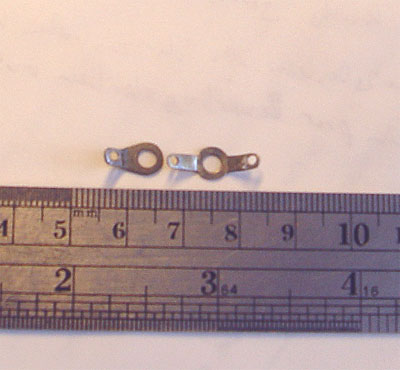

Very interesting thread here! Only recently I discovered an alternative use for solder lugs as attachment points for wire bracing.

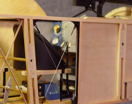

I used some in the cockpit area of my EIII in an effort to improve the scale illusion/
The double sided ones could make for ideal 'junction' fittings, i.e. where formers and stringers join and the wires have to be anchored.

those solder lugs look to be a very good solution... didn't realize there was such a thing! (Still trying to find them.)

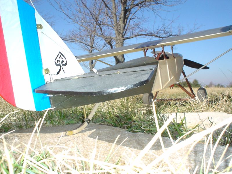

I developed some hardware on this model using a lot of ideas generously contributed by folks on this forum.
I'll point out the bits that I did on this plane in case it gives someone a good idea.
The control surface hinges are straps of thin brass sheet wrapped around the leading edge of the elevator (and rudder) which is aluminum tube. The tube acts as a joiner for the elevator halves. The trailing edge of the stab is reinforced with 64th ply, and the straps bolt through the trailing edge of the stab using 00-80 hex bolts from Microfasters.
The tail skid swivels and tilts (but is not controlled). Skid is sprung with a spring, not bungee! The "shoe" is a piece of brass fastened with a bolt. THe skid tilts on the brass tube post using a bracket made of thin guage steel snipped from a paint roller tray. A bolt holds the steel bracket to the skid. The brass tube is drilled through such that the steel bracket is retained and allowed to pivot on a A piece of thin music wire. I may have a picture of this before covering....have to look for it later.
The tail is braced with Fireline using AL tube for ferrules and fish-hook eyes are used as attachment points.
I have more pics of the front and the UC parts, but I'll have to hunt for them at home. Anyway, none of this very "scale", but I think it looks cool!

Nice model! It's got that vintage look to it, even if it's not scale it looks like it could've flown sometime during the 1920's.
It would seem you've put a lot of work into it, any pics of it 'in the bones' would be appreciated I'm sure/
I'd also be interested in the specs.

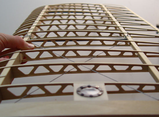

I've also included a pic of my E.III wing (1/5 scale)

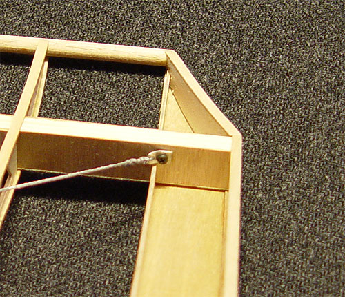

How about some close up shots of those attachment points? Or you could just make it convenient and put ALL those lovely construction photos in one thread!

The wings were a part of the model I thought I'd do up as scale as I'm capable of. Not entirely consistent with the rest but oughta give me plenty of practice for future models.
I'll do that thread, rest assured, but as we're talking fittings, might as well include a pic or two here.
The internal wing bracing is not steel wire, instead I used a sort of braided nylon thread (dipped into silver paint) that I deliberately did not pull very taught (in the interest of wing warping).
The attachment points are simple bits made from 0.4 mm sheet aluminium and attached to the ply spar webbing with a small bolt (CA'ed in). The thread was also just CA'ed onto itself/ no crimping of metal tubes. No real attachment points at the anti-compression bars...just routed through.
Rather crude actually, but simple to make. (Bear in mind it's just the 'shine-through' effect with the transluscent covering I'm going for)

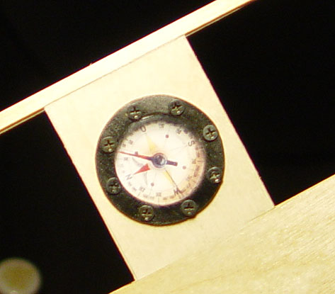

I'll also have to dissapoint you on the compass...wont' have an actual functioning one. I printed out the 'bamberg' compass photo you sent me to a corresponding size on photo paper.
I then tried to creat the illusion of an inset compass using a combination of painted ply, small bolts and PET-bottle plastic. Looks okay from a distance.
Sorry for the bad pics...somehow can't get the macro to work on the !#$ camera.
Trev, as long as you've gone this far, you might as well add the in-and-out fabric that criss-crossed the length of the wing. It would weight next to nothing (bits of black crepe paper might even work) and would make the wing look even more fantastic and even more authentic than it does now.
The compass really does look good! I'd say it's time to start getting some covering on that puppy! Remember that according to Dave Platt once you've covered the model you're exactly half finished!!!
About the model... this model has a span of only 36", it is powered by long-can 400 electric mounted to Mini-Olympus gear box. On 9.6 volts provides more than adequate performance for "scale-like" flight. (If you have never heard an electtric model flown on the Mini-O...some folks complain about the noisy gear box, but it actually makes IMO a pleasant "engine" sound). Prop is 9" diameter. AUW ~29oz. I think wing loading worked out to about 16oz/foot. The model flew well, but sunk quickly at dead-stick and needed to be flown in to landing pretty fast. Gear placement worked well and did not have too much trouble with handling or nose-overs.
I have a couple of pics "in the bones" but they are pretty lousy. Nothing remarkable about the construction, it is basically slab-side construction of front of 1/16" balsa, with the rear fuselage being an open truss constructed of 1/8" pieces. The vertical tail outline was achieved using 1/16" balsa laminations.
The cabane struts are spruce, glued into the fuse, but attached to the wing by 2-56 bolts into blind nuts in the wing. Landing gear struts are spruce, attached to fuse by small steel brackets and #0 screws. Landing gear is sprung with bungee cord.
Hmm, let's see what else. Wing struts are basically just for looks, they are aluminum tube with 1/8 dowel inside for extra rigidity. The attachment points are simply #0 screws through the flattened ends of the ALuminum tube. Problem with this is the Aluminum could bend or break very easy on then ends. The "outboard" aileron placement was achieved using a centrally mounted servo acting through wire links and bellcranks.
