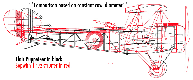

But what really struck me is that the Puppeteer looks to my eyes to be a bit more generic than the Legionaire which is a pretty good copy of the Nieuport 17. The Puppeteer which is intened to be a sports scale version of the Sopwith Pup -- looks a bit more like the mother (Sopwith 1 1/2 Strutter) than the whelp! And given that over 10,000 Puppeteers have been built (according to the Flair website) I figured I might as well do something a little different and try kit bashing it into the Strutter. The diagram below shows the side view of the Strutter superimposed on the side view of the Puppeteer.
The length of the fuse from cowl to rudder post is very close. Even the position of the wings and the location of the UC axle are nearly identical. It should be a small matter to relocated the gear attachment points, add the two-seater cockpits, and maybe reconfigure the rear turtle deck a bit. The wing span is a more Pup-like but I can live with that.
I'll do up a scale-shaped rudder (maybe with a 10% enlargement) but I'll basically use the kit wings and stab as is, with only some modifications to the tip shapes. Other possible alteration include the use of more scale side fairings on the forward fuse, the addition of the famous W struts (of course) and the addition of the scale air brakes of the original on the inboard edge of the lower wing. No matter what I do, it'll still end up as a sport scale model but perhaps one with a bit more jazz!

A quick comparison of the wings shows the Puppeteer's wings to be no more than 10% wider on the cord and about one rib bay shorter on each wing half. It would be easy enough to just add a rib to each side.
On the horizontal stab/elevator, the scale version is just a bit wider but at least 20% longer. If I go for the greater wingspan I'll also increase the size of the stab. Conveniently, the (positive) scale incidence on the Strutter is about the same as on the Puppeteer. I'd want to be reworking the stab seating area to be more scale as it is one of the distinctive features of the fuse and gives a bit of a curved up look. This shape allowed the incidence of the tail plane to be adjusted in flight -- which also explains the characteristic gap between the top of the stab and the bottom of the rudder fin. This arrangement was also seen on subsequent Sopwiths like the Tripe.
