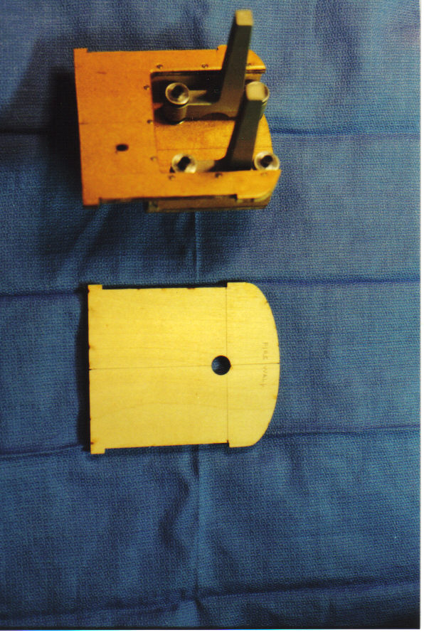

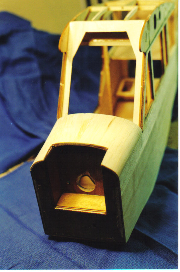

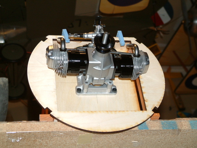

Like this? I used 1/4 inch on all of it, butt jointed, epoxied, and screwed thru the joints with #0 screws, then a layer of fiberglass (1/2 oz) on the backside of the joints. It's probably overkill; it's only a .65 bolted to it. The stock firewall is next to it in one picture.

Depending on how much of a recess you need, you can just cut a hole in the original firewall large enough to allow the mount to fit into, then laminate another piece of ply on the back. With a 1/4" ply firewall this would give you a 1/4" recess. The laminate on the back need not be as large as the original firewall. Continue the process and each layer will yield another 1/4". This method is heavier so use it on airplanes that will need nose weight anyway, like WWI biplanes!

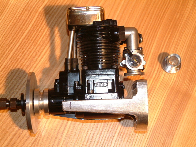

Here is something else that I was going to try on the Hanriot, but it just didn't work for me. I was able to reduce the overall length of the Saito 180/mount combo by sliding the motor back on the mount, after removing the velocity stack from the carb. Is your Saito similar? The front hole of the engine lug is in the back hole of the mount. The location of the front hole in the mount is marked in black. This saved me almost 1/2" but it still wasn't enough...
If the first picture is still here it is because I don't know how to delete it....the second picture is the Saito....

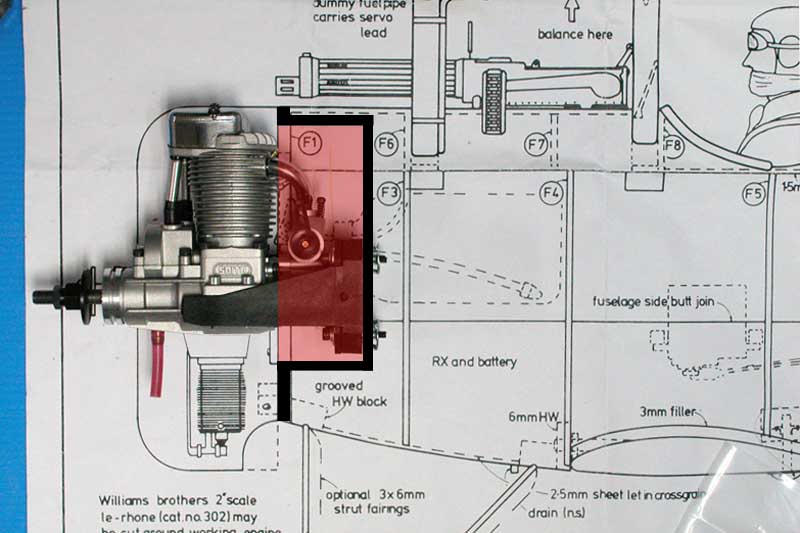

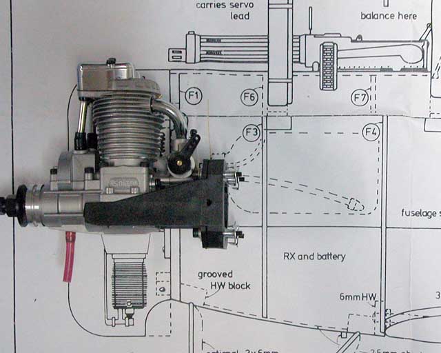

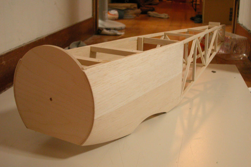

Another question is the size and shape of the box. I'm having a little difficulty getting my brain around this. Does this diagram look about right? I also wonder whether I shouldn't just build in a whole second firewall and just leave the current one as a "false firewall." I'd still be able to put the battery and possible also receiver forward of the new firewall.
