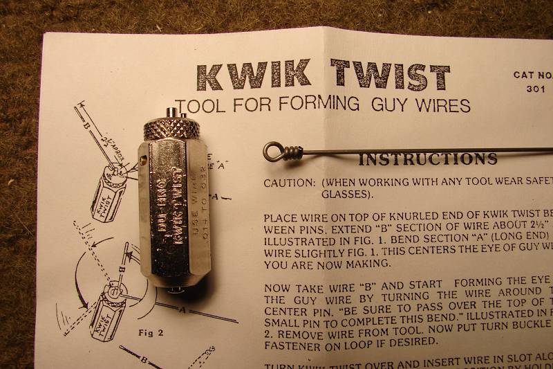

I have a restoration project going on a 1/3 scale bi-plane. It uses flying wires and turnbuckles by Dubro. As you can see in the pic the flying wire/turnbuckle assembly is very nice. I pretty sure the wire attachment was done with a Dubro Kwik Twist. I've ordered one. But have no idea how this thing works and what size wire the wrap, if it's a separate piece or if the music wire is wrapped around itself. Can someone give a short primer. thanks.

Thanks a bunch. That anwered a lot of my questions. Made me feel so indadequate []
Question #2: Does anyone have an idea of what kind of tool will make those beautiful full circle loops in the end of the music wire. Needlenose pliers won't do it, I think.

I doubt you'll have much luck trying to bend regular music wire into such tight loops unless you anneal it first. It might be worth heading over to the hardware store to pick up a bundle of those soft wire twists the construction guys use to hold stuff in place. It would be a simple matter to wrap that around a nail or something even smaller.

Making the barrel wraps is not the problem. Single strand fishing leader will work good. It's the loop in the end of the music wire that will be hard. I had not thought about heating it. That may be the solution. Does anyone know. Guess I will have to do a test when the wire gets here.
Another question: maybe music sire is not the best thing to use? don't know, this stuff is all so new to me. So much to learn, so little time.[&o]

splais, if you heat music wire until red it will bend pretty well. After it's bent let it cool slowly. Music wire is the wire of choice here unless your flying wires are flat , airfoil shaped or cables.

Well my flying wire tool came today. The Dubro Kwik Twist. It is very easy to use, works on music wire up to .032" (.8mm) and makes incredible flying wire ends. I made a perfect end on my first attempt in just a couple of minutes.
