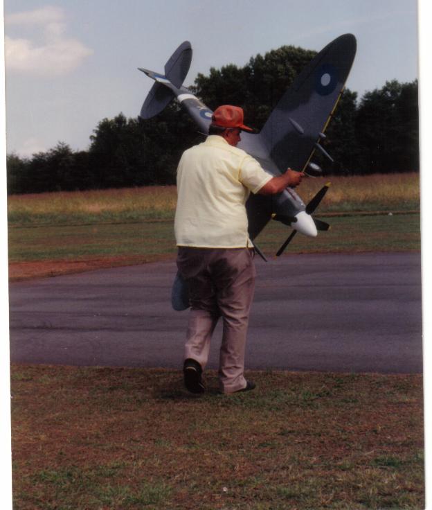

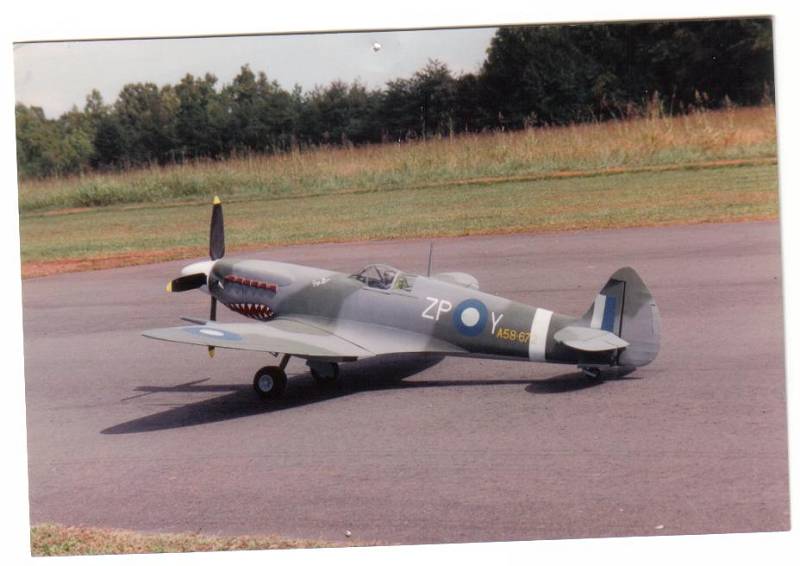

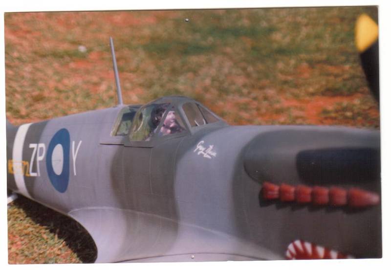

I had a Dave Platt Spitfire. Built great but didn't have any flaps probably didn't need them. It had the largest wing surface of anything I ever built. Didn't get to fly it.

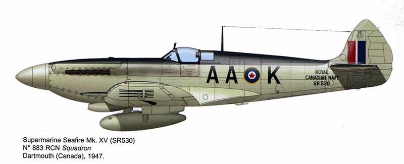

I've been doing some light research on the Mk XII which Dave based his kit on and found that there aren't a whole lot of schemes to duplicate. However, I did find out that the Royal Canadian Navy utilized a derivative version of the Mk XII designated as the Mk XV. I think this is the aircraft I'm going to duplicate as one doesn't see too many of these. Anyone know the color codes for this or where I could find them?
Al

I think I would try Warbirdcolors or Vangard for the new acrylic paints. The color scheme is one that was standard post war and Korean war for both Canada and Britain naval planes, being extra dark sea gray over sky. There are plenty of sources for the correct color, I just think this new acrylic paint is the best.... Of course, that's just my opinion, I could be wrong.

Nice choice Al, the Seafire XV is a favorite of mine as well and offers a much broader variety of schemes. It would probably be hard to locate but Scale R/C Modeler ran an article many, many years ago on a couple of gents who built Seafires out of the Platt kit. There are several Seafire XV survivors around the world so I'm sure somebody somewhere has done a walkaround type pictorial of one. I noticed that none of the Aero Details series of books on the Spit covered the Seafire variants so it is my hope that they will release a volume dedicated to them eventually. I know at least one of the plastic model companies, Hobbycraft I think, makes a 1:48 scale kit of the XV as well which may be a viable source for color documentation. Love to see a thread on it when you get started!
PS- This one is being restored to fly by Amjet at Anoka County Airport in Blaine, Minnesota.
More pics here: http://www.midwaysailor2.com/amjet/seafire.html
