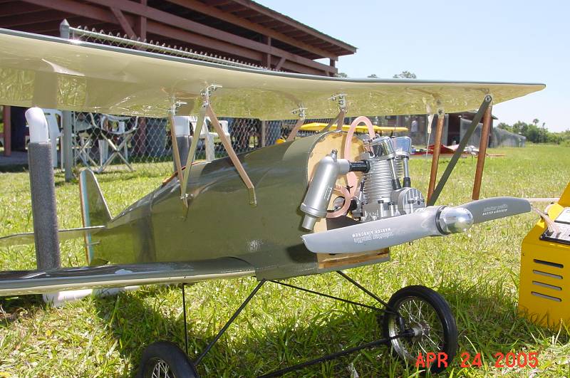

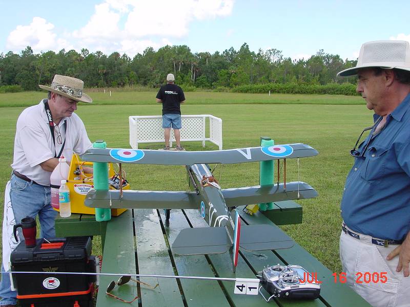

Mike,
As you can see I have built the Modeltech SE5a. I will answer all of your question in a later message once I have an opportunity to take all of the measurements.
Bob

Mike:
Here is the first bunch of numbers:
The wing depth is 1" +/- .0625. Both are airfoil design. The center 5" of the wings are straight and this center section is fully sheeted with .0625" balsa. Dihedral begins at 2.5" out from wing center and raises the wing 1.5" at the outermost rib which is 2.125" from the tip. Both wings span 49.5" with a chord of 8.125". Ailerons on both the upper & lower measure 2.75" x 7.25". The TE & LE tips are radius-ed 2" on both wings. The lower wing is held in place with a .25"x.5"1.5" hardwood tongue attached vertically to the center LE and goes in the slot you may have noticed in the wing saddle of the fuse. This tongue protrudes only about .5" with the remainder securely mounted in the wing. Two bolts at the TE fix the lower wing. The wing separation is 8.5" measured from the bottom of each wing at the LE. The wing stagger puts the upper 2" in front of the lower. The upper wing has a -1 degree incedence to the lower.
The wheels that came with the ARF are 5" diameter. I replaced them with 4.375" which is a more scale size.
I did not have time to take the measurements on the tail feathers but will do that this evening.
Your observations of size relationships are correct. Like the Sopwith Camel, the SE5a was short coupled with a narrow wheel base and like the Camel was prone to ground loops and nose overs.
The previous responder was correct I think, that it would certainly be easier to buy the full kit - But hey - where is the challenge in that?
More to follow.
Bob
More to follow.
Bob
Bob,
Thanks for the iniatial measurements. Those are some fine pics. I notice the changes in props as well as wheels. I don't recognize the engine make but it appears offset as the drilled holes in firewall. Do you have a finished weight, any ballast?
A plan type builder stopped by and after an hour or so of looking and sketching announced, 'No Problemla' Gather some more data and materials a bit of help from some experienced builders they may fly.
From the looks of Bob's plane a kit would be nice but it is not in the cards at present.
Are the outer struts hardwood? Dimensions? I have some .12"thick basswood and .15" yardsticks, no hardwood or spruce.
The dimensions listed for the cabaine struts are they c/l hole measurements or OAL?
How does it handle? Anything you would change in the tail feathers and wing dimensions if you were building them regards size? Disregard that it is a 'scale type' plane.
