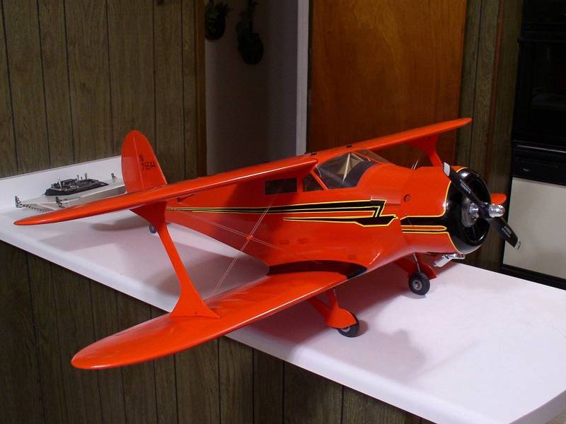

I built and posted a few times on my Royal Staggerwing. Here are a pair of links to the threads:
http://www.rcuniverse.com/forum/m_15...tm.htm#1623237
http://www.rcuniverse.com/forum/m_18...tm.htm#1880100
I used the Hangar-9, 60 size P-51 or P-47 retracts and they will fit the stock wing with only slight modification and no bumps portruding on the upper surface (unlike the ones referenced on the Royal plans). As a plus, they are now being shipped with hard struts and lock adjustments that were not available when I built my D-17. They held up great on our rough southern grass field and never gave a moment's trouble. If you have any other questions, drop me an e-mail and I'll send you my phone number.

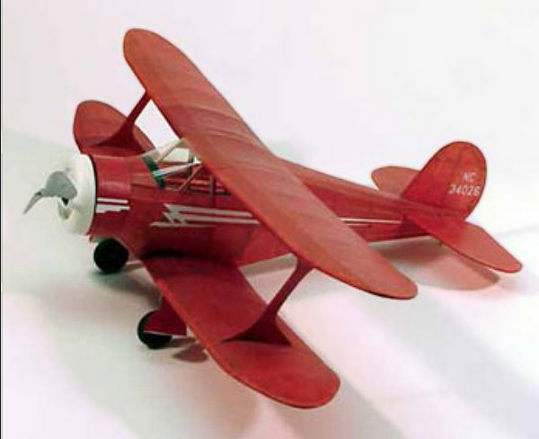

I love the D-17s so much that I am building a tiny Dumas Staggerwing (17" wingspan) for electric power and 3 channels. I'm attaching a picture of both just for the heck of it...
quint

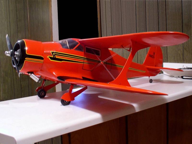

By coincidence the Century 21 fabric matches the paint chip color often used by Beech on the D-17s. I had a harder time getting the colors right on the interior upholstery, but luckily the Navy Aerospace museum is located at the Pensacola Naval base and is close enough to me for visits to their D-17 on display.
I used the Robarts, medium size retractable tail wheel, but would opt to use the large size if doing it again since the plastic on the medium unit is too soft for regular use on a 10# plane. The rigging is 80# test monofilament fishing line since the full size Staggerwing had it's turnbuckles hidden in the wing/fuse and required a smooth rigging on the model. Here is another 'in the bones' and one taxying just before her maiden flight

Hi Quint, Your plane is sooo nice . I noticed though that you didn't bother with
the rear strut on the gear or the flap on the well cover. Was there a reason?
