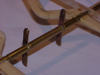

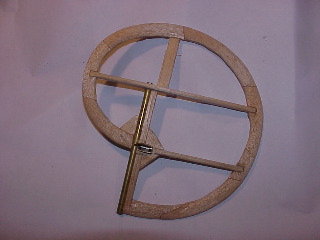

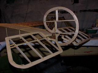

ill try to include a picture or two of what i did. I purchased my first rc airplane 4 years ago with the intent on making a static display model. I purchased the 80" balsa usa eindecker. when i unrolled the plans i realized it was not to scale and just a close approximation. (my naivete). so i proceded to redesign the whole thing except for the wing (which i modified too). this took a couple months to draw out everything from three views i found and looking at old photos. The tail assembly i made should work for a flying model since my intent was to have all controll surfaces, propeller and rotary, moveable. I used brass tubing for the tail assembly. maybe this helps.
Old 07-11-2003 | 06:54 AM
Joined: Jun 2003
Posts: 43
From: Portland, OR,
Default kit bashing a balsa usa eindecker 40
another
Joined: Jun 2003
Posts: 43
From: Portland, OR,
one more
