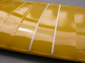

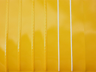

I am developing a rib stitch tape.
It is easy to apply (peel and stick). You just cut to cord and rib width and apply over covering, on to rib and then apply the finishing tape. Works with painted and iron on coverings.
It is available in 1/6,1/5, 1/4,and 1/3 scale, of full scale 2" spacing. Custom sizing will be available upon request. Any added info on different types of scale stiches are greatly welcome.
If you are interested or have any input, feel free to email me at:
[email protected]
I will have pics available in the near future.
ZZ
Well, I now have the rib stitch tape ready.
I have attached a photo of what it will look like.
You can see the white strip on the right has the top backing still on. The other strip shows the backing removed and the stitches are exposed. The finishing tape I used was J&J 1/2 medical tape with a pinked edge. It is 1/4 scale.

*SIMULATED RIB STITCH TAPE*
Application is as easy as cutting to cord length and rib width. Peel back the first backing and apply it to your wing panel.
When you are ready to apply your finishing strip, remove the second backing from the Rib Stitch Tape, which will reveal the Simulated Rib Stitches. The double sided adhesive will help to keep your finishing strip in place. Apply your finishing strips and your project is now ready for your finishing color scheme. If you chose an iron on covering that you will not be painting, that's it! You are done! Stand back and admire that finishing touch of scale detail on your project!
Check out the photos samples using Johnson and Johnson 1/2" medical tape as a finishing strip. It has pinked edges that is close to scale. If you use a filling base coat you can blend the strip in to lessen the detail of the pinked edge if needed. I left it sharp on the samples for photographic purposes. Note that there has been no sanding at this stage.
