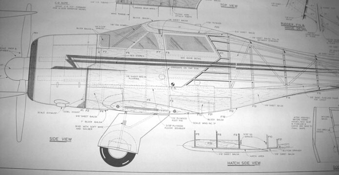

I am building a 64" Staggerwing from Sid Morgan Plans. The CG is shown on the attached photo of the plans (CG dot on door). Although all models are not the same, where is the CG on the Byron model? Another modeler built the Stagerewing from RCM plans and his CG is near the leading edge of the top wing.

Taking measurements from supplied drawing I'd put the c.g. balance point ahead of the little hatch. Have plenty of elevator throw on expo for first flights. Incrementally move c.g. aft to your liking.
