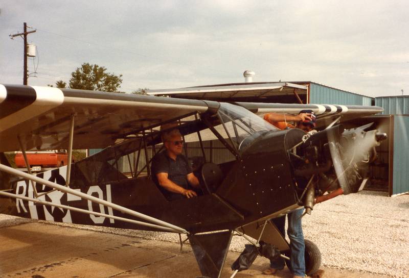

Old 09-05-2006 | 09:06 PM
BOB MOORE's Avatar
Joined: Jan 2004
Posts: 274
From: Nederland, TX
Default RE: False Rib Stitching
Here is an L4 Cub that i restored
