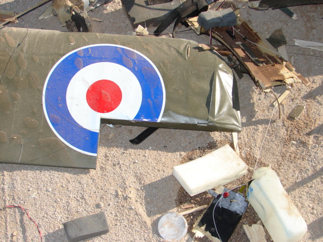

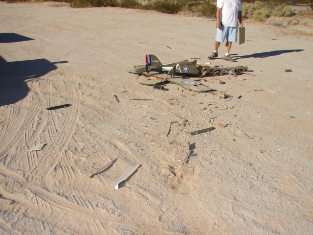

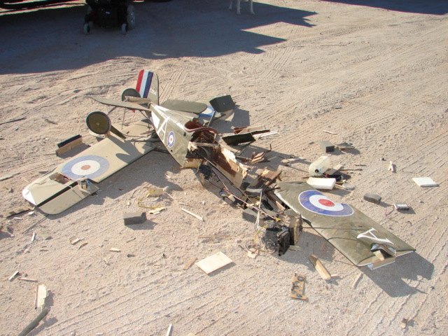

Well, my venture into WWI scale aviation has come to a screeching hault. My beautiful S.E.5a is no more - as you can see. On her maiden flight on the second turn around the field I watched helplessly as the elevator came off and she went straight into the ground from about 200 feet. I may be a long time before I purchase another plane built by someone else; but it sure was fun while it lasted. Just a shame to see this beautiful plane in this condition. []

I am staring with mouth agape......I am so sorry.

Oh Man!.. Dang Steve, sorry to see that. It was a decent looking plane and I'm sure it would have been an excellent flyer. Sorry bro.[sm=sad_smile.gif][sm=sad_smile.gif]

That sucks! It was a really great looking plane. At least you have some interesting souvenirs to hang above the workbwench as an example of why you should build it right the first time! I hope this isn't your last attempt at early aviation. They are really great fun when they work!

On her short maiden flight she lifted off beautifully with little trim required. I made two passes before the elevator came off. she also taxied very well with the steerable skid. The plane obviously was lost, but the engine was also completely destroyed. Post crash examination showed that every hinge in all control surfaces had popped out. They were glued with a glob of some brown stuff. A closer examination showed this plane may have been older than thought. Things like the cotter pins in wheel axles were rusted. For a plane that had never flown this indicates a lot of hanger time. Maybe the glue just dried out, don't know. I should have been more leery of this planes flight worthyness, but it looked so good. During setup and ground testing I had two pull-pull cables come loose (replaced whole thing), two hinges come loose (repaired and checked all poorly-obviously), and had one exhaust stack fall off. But it is hard to tell just how good or bad a finished plane is put together. It was fun; I guess the search begins again; I don't think i'll find another plane like this one was for $900 though.

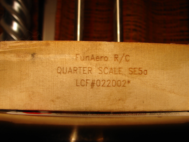

Well, things have gotten interesting. I always wondered about what Funaero said about my BalsaUSA looking an aweful lot like a funaero. Apologies are in order. take a look at what I found in the wreckage. So I got a plane supposedly built BalsaUSA. Even got the manual and plans; that turns out to be a Funaero, serial number LCF022002*. Just one more weird thing. The guy I bought this from allegedly helped the guy who built it. All water over the dam now; I'm already looking for a replacement because I liked this one so much.

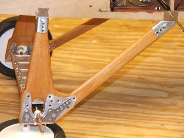

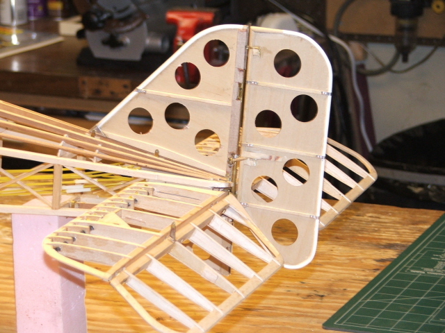

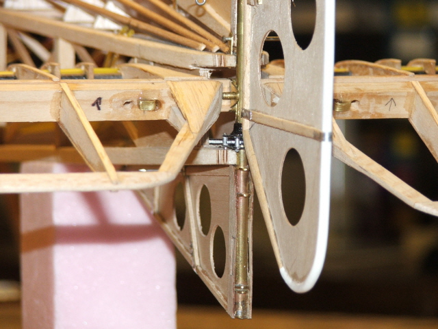

Thanks Bob. Looks like I missed the obvious. Here are a few shots of where I'm at so far.

Steve, excellent work!!!
That looks like Dennis Bryant plans but his are for a 1/4 scale plane. Who's plans are you using?

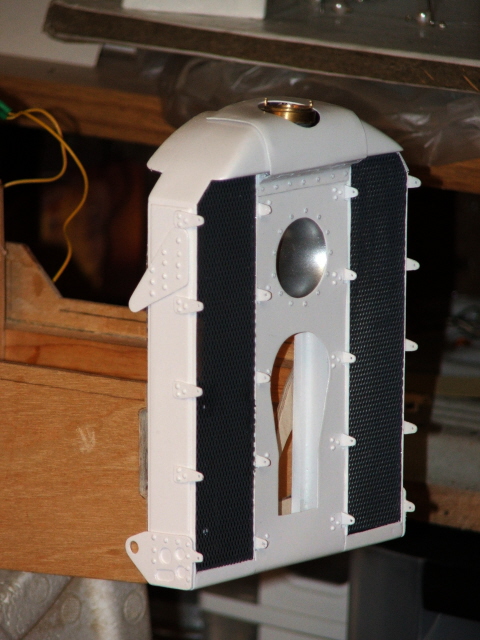

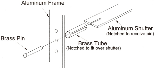

Your radiator looks super. Id' be interested in your technique for construction. And thanks for posting!

The plans for my plane are my own. I built a Top Flite kit designed by Mike Platt and used his plans as a starting point. Most of the changes I've made are for the details I want to do.
The radiator is made with two plywood boxes (one for each side) mounted on a lite ply back plate. The top is carved balsa. The fronts are a brass mesh I found at Michael's craft store, inset into the ply boxes. The center and top cover are aluminum. Side brackets are 1/64 ply. Rivets are small pins. The shutters are aluminum with a small slot cut into each end with a jig on my bandsaw. The brass bushings (also cut and slotted on the bandsaw)are placed over the slots on the shutters, forming a small cavity.Thick CA is injected into the cavity with an insulin syringe. Brass pins (cut down) pass through the sides of the frame into the cavity.

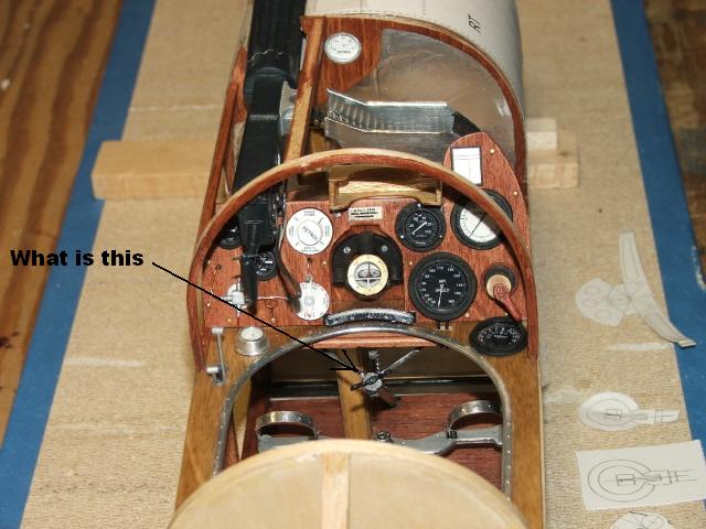

Also, does anyone know what the long tube in the center of the cockpit is for? It's not in all of the planes.

No idea what that item is, but I have seen it mounted to the pilot's left vs between his legs. A good source for photos is
[http://memorial.flight.free.fr/indexuk.html]
look in the Gallery- old photos tab & theres a black & whiite without the "item" there. In the panoramic cockpit view, I think it was visible on the left (I must be missing a plugin or something, can't get it to work for me).
Maybe Arizona Modelers would know?
