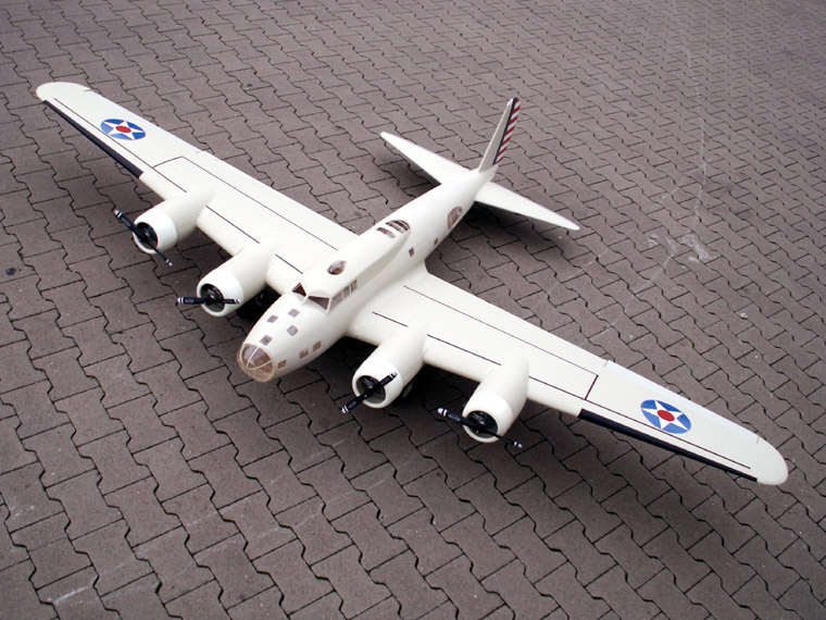

This is my CD-Scaledesigns Boeing B-17 C prototype. As you can see she's ready to go. Just a few small things to take care of, but hopefully we'll have her ready in December(-ish).
Chris

Hi Hockey,
here are some basics;
scale: 1:10th
wingspan: 124"
power: four O.S. 52 four strokes
six channels
Robart retracts
working flaps
weight: 33lbs
Design work started March 2003 on AutoCad. Prototype build was started October 2003. Traditional wood construction overall, glass covered, includes vacuum formed canopies and details like superchargers and exhausts. No additional weight was needed, the model balanced perfectly off the drawing board. There are still a few lose ends we need to take care of, but we're hoping the maiden will be in December.
