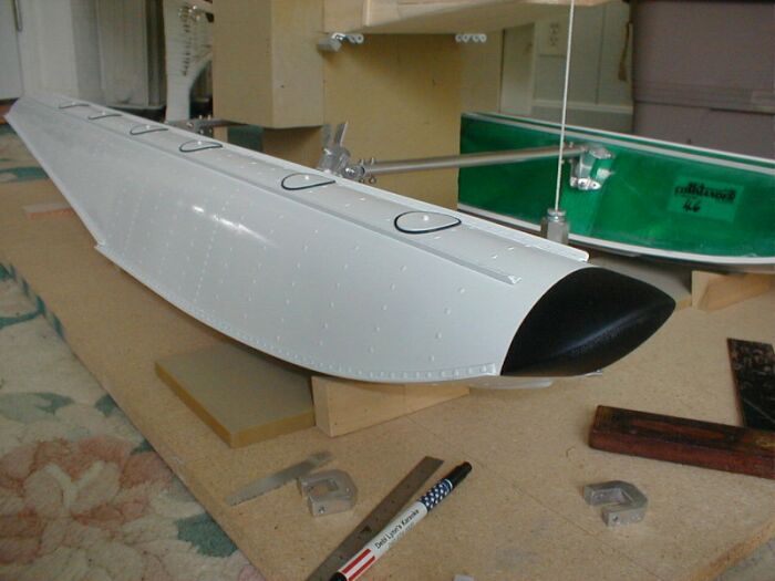

How do you make scale rivets on a plane is there a special tool you need?

If it is just the raised head type, take some RC-56 canopy glue open it up and let it get a little thick then you can take a tooth pick and dip it in and touch the surface and make them, I like to use a needle fill the tube with wood glue and let it drip out the end and touch the surface, I cut the sharp point off. With a little time you can make tons of them. And with defferent size needles you can have any size you need

I take the nozzles that you can buy for cyanos, and fit it over the spout of an aliphatic glue bottle. Then go along the line squeezing out little glue rivets, once practised you can achieve up to 20 rivets per minute. I tried both the soft setting (canopy glue) and hard setting sandable aliphatics, the hard setting was much better as the soft setting can flex during cleaning of the model and then paint comes off. Both glues shrink considerably as they dry, so do some tests first to find the correct wet size of drop needed to get the correct dry drop.

I have done both glue methods and have at times had problems with when they dry they shrivel and have non rounded tops and other times they were perfect.
any ideas on this maybe i need to dilute it more or i dilute it too much? I figure i need to just be more careful on my dilution measurements. I use elmers glue and dilute it about 25% with water giving me a 25:75 ratio now most of the times i just guess and i eventually get it right but am curious why i seem to get a lot of rivets i have to replace because of the crinkled heads.
A couple times I went to extremes and bought w bazillion pins cut the stems short added a little glue and pushed them into the surface. needless to say this took forever but the results were stunning.

I prefer to drill and place scale rivets from www.microfasteners.com I attach with a pair of tweezers and ca.
time consuming? Of course..but were looking for scale right? And the size is consistent. I've never had any luck with the glue method..too much shrinkage.

Ok Dany Please Please dont think I am picking But I see from one of your shots the little concave rivets I have trouble with and am just using them as an example to show the probs I have. in your picture http://www.pbase.com/image/3987364&exif=Y there you have a lot of nice looking rivets and if you look close you can see that several also have shrunk in a spot giving a concave look rather than the nice rounded head.
Again my question is what ratio does everyone mix their glue and water with to get rid of this problem?

When I do rivets there are two things that I do to obtain relatively consistent and uniform rivets. First I use R56 canopy glue mixed 50/50 with water. This glue seems to resist the shrinking that wood glue exhibits. The second thing is the tool. I use a 20-gauge needle with the tip ground flush connected to a small plastic squeeze bottle. It doesn’t take long to get the hang of forming uniform rivets. Anyway, it works for me.

thanks Bob I'll try the canopy glue i never thinned it before as a lot of people say they use it straight out of the bottle. will try 50/50 this time. just liked using elmers as its so darn cheap and i have it handily around the house hehehe.
