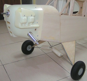

Old 04-01-2007 | 11:51 AM
EF
Joined: Feb 2005
Posts: 564
Received 21 Likes on 19 Posts
Default RE: 1/4 scale sig cub engine ?
Interesting and a little confusing for me...[sm=spinnyeyes.gif]
I am building the Clipped Wing Sig Cub at 1/4 scale, and have a Magnum 91 already fitted nicely.
This decision is based on my Precedent Aeronca Champ that at 108" span and 10.5 Lb., flys great on an old OS 61 FSR two stroker with a 13-5 APC. Takes off with authority, needs 50% to maintain level flight.
However, I've read quite a few posts indicating I may be pushing it a bit...so I started considering a Magnum (?) 120 in place, though wouldn't realy like to fit a new engine...
So now I understand that maybe I am OK with the 91? I might add I build rather light (started in the hobby with free-flight sailplanes...) and fly off asphalt. The CWC will be covered with Dave Brown's Skyloft (after happy experience with it on my Sig Smith Miniplane).
Comments?

Old 04-01-2007 | 12:42 PM
Wayne22's Avatar
Posts: 5,394
From: Strathcona county, AB, CANADA
It will fly just fine....Mine was built extremely light, and I ended up adding a ton of ballast in the nose with the smaller engine. It still flew fine. I was trying to think back on all the 1/4 scale cubs that I have flown, and I think only 1 had a 120 on it, and it was on floats... the others were anywhere from a Saito 91 to a G-38 ...........

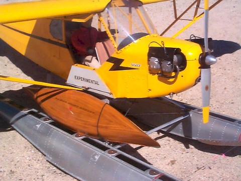

Old 07-29-2007 | 09:27 PM
iron eagel's Avatar
Joined: Jul 2004
Posts: 3,275
From: Middleboro, MA
We have one at our field with the os twin nice set up sounds cool.
If money were not an issue I would like to try something like this...
It would look real scale. LOL

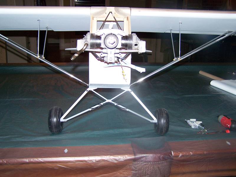

Old 08-03-2007 | 07:39 PM
Wayne22's Avatar
Posts: 5,394
Give me a minute here and I will dig out a nice picture of one...... The owner says it is not a very powerful engine...I think he mention that the single cylinder 120 had more power...... Sure flew nice and sc...er.....realistic...with a very nice exhaust note...

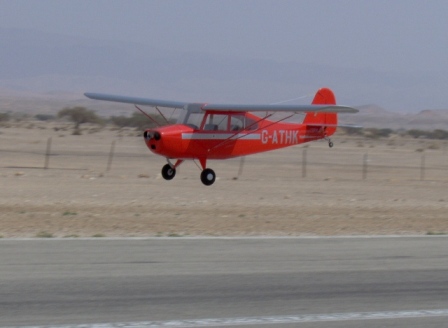

Old 08-23-2007 | 08:51 PM
My Feedback: (16)
Joined: Nov 2003
Posts: 946
From: monroe, LA
guys we always powered our cubs to go straight up but here in the last few weeks i built a g.p. arf cub, put a new 52 magnum. it was so much more fun with the smaller engine, you have to use full power to get it moving so it has the straining sound like the real ones do. my friend that i putt-putt around with pulled his o.s. 70 and put an old saito 45 on his. lot's more fun and it really gets the wing loading down.
hey iron eagle, the wrights did crash!! orville crashed during an army trial while carrying lt. thomas selfridge who became the first person ever killed in a plane crash. i spend too much time reading!!!
this my sig clipped with magnum 160
