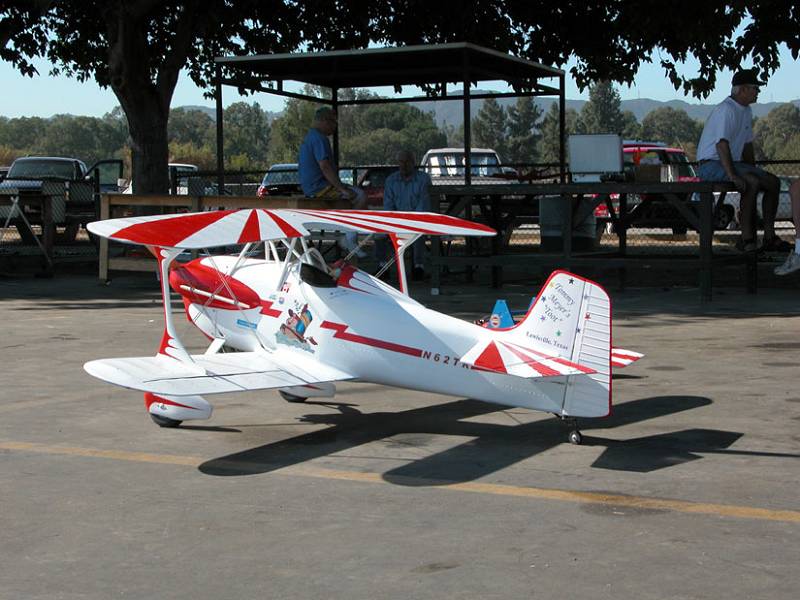

I built the Little Toot from Mammoth Scale Plans a few years ago. It was an enjoyable build. The plans are fairly easy to work from and the plane flew well. The only real problem I encountered was with the wing incidences. The plans have way too much positive angle. The first flight was quite interesting. Once the angles were reduced, the model turned into a real nice flier.
