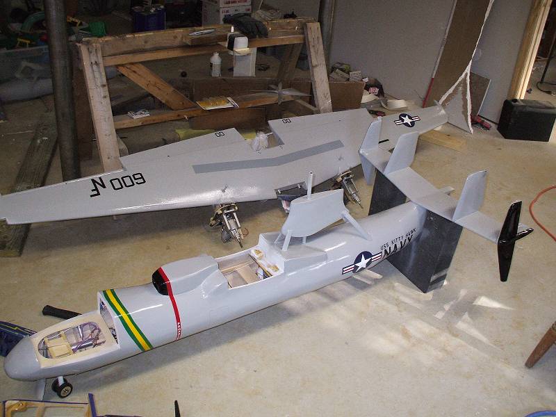

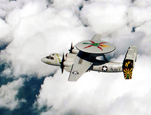

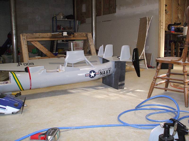

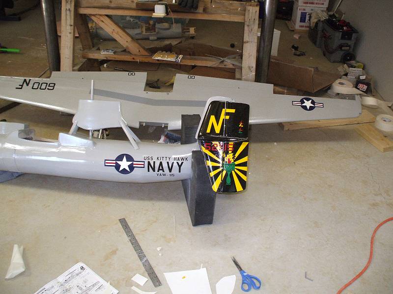

WOuld this be considered scale-enough?
I'm trying to finish this 100" E-2C Hawkeye project. Its been a year this month, that I have been working on it.
Mike

Looks close enough to me. Mighty fine. Give us some info---scratch or plans, what does it weigh, whose retracts. What are you motivating it with? will the radome spin while in flight?

OK, here are the general specs:
- plans blown-up from a 70" set of plans I got off ebay.
- 100" wingspan
- Final weight TBD
- 2ea Saito 125 4c
- props: Zinger 14x6, 4-blade
- Custom cut Tru-turn spinner in a flat black annodized color
- Custom Centuryjet retracts, 90degree rotating, with brakes
- Robart air tanks
- Jet model products air valve
- Gear syncronizer
- Curtex lighting system, nav, strobe, landing
- Custom decals from http://www.callie-graphics.com
- Working tail stinger, to prevent scuffing rear belly
- Twinsync engine syncronizer, with onboard glow
- Macspro custom exhaust: running inside the engine nacelle
- JR rx/servos
- working flaps
- Klasskote paint: light gull grey and black in a gloss finish
- Fiberglassed with WestSystems resin
- Geez, this is tough to remember everything I put into this....
Radome remains static during flight.
This month makes one year for this build.

Scale enough for what or who. If you compete then it needs to be scale enough for the judge. If you build for your self then it needs to be scale enough for you. Mine are never scale enough for me but thats life and drives me to try and do better each build. Just wish I had more time, skill and patience. Either way I do enjoy the journey.
Its a nice bird!
Is it scale enough for you?
Carl

Everything sounds possible except the folding wings. I have a tail hook that could drop down, but I opted not to incorporate it. Unless you plan to use it, its just something to look at. I would be afraid it would snag and rip the aft end of the fuselage off.
As for the drooping ailerons, I will play with some mixing in my JR 9303. I might be able to make it happen.
Mike

DO you think you would be able to see the rotation in the air? The radome turns at roughly 6RPM.... with this in mind, I opted not to make it rotate. Build smart, build light. If there is no real effect gained from an option, leave it out.
