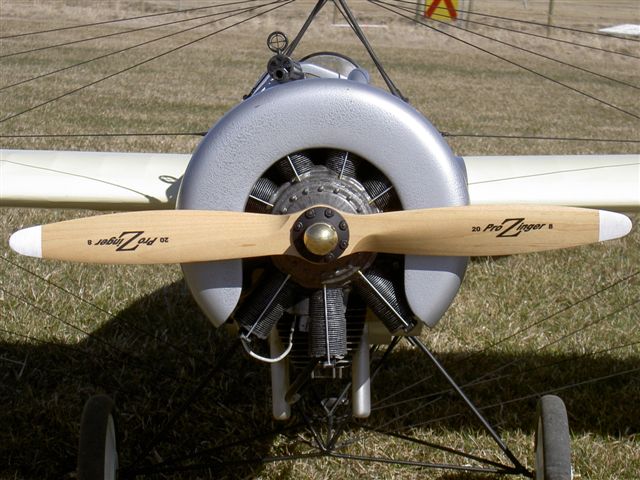

Thanks for the reply and your input . It seems there are not many that have built this particular kit as you are the only person to respond so far. I have ordered a set of plans and the building manual from Proctor and will look them over before I make a final decision on this kit. I had imagined a larger than standard servo would be needed for the wing warping. Thanks for confirming that part. For power I was thinking of using the Saito 220 and kit bashing one of Mick Reeves 1/4 scale LeRhone radial kits to look like an Oberursel as I did with my scratch built E-III shown below. Was there any particular part of the construction that presented a significant problem for you or did things go pretty much as expected? Again, thank you for your input.

Believe it or not, I did end up scratch building this plane from Proctor plans. I reduced them 20% so I ended up with a 80" wingspan. I had 2 flights on it with a Saito 115 for power and after cleaning all the "glo snot" from between all the wires decided that electric power had to be the way to go.
She is now powered by a Turnigy G-60 500 through a Turnigy 85 amp ESC using 5S, 4000mAh, 40c batteries. It is a very good and smooth flyer with very solid response to inputs.It's not what I would call an "every day" plane due to the amount of time required to assemble and disassemble all the wires and such but it gets a ton of attention at the field and is a real pleasure to fly. Forgot to mention that the all up flying weight is only 10 lbs.☺
