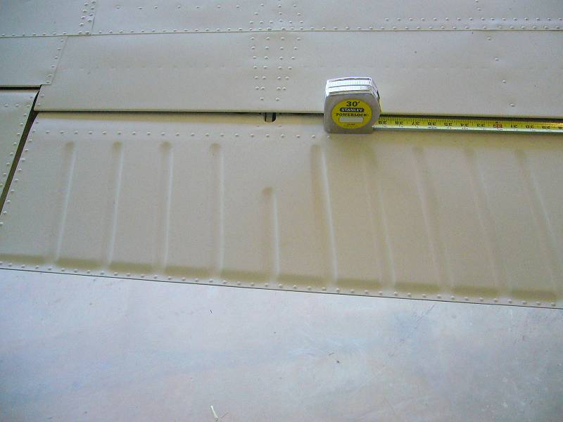

Old 10-23-2007 | 07:08 PM
Posts: 296
From: zionsville, IN,
Default RE: Bonanza
Which version you building 33 (straight tail) or 35 (v tail). I own a '68 E33A full scale and can get the dimensions if you'd like.

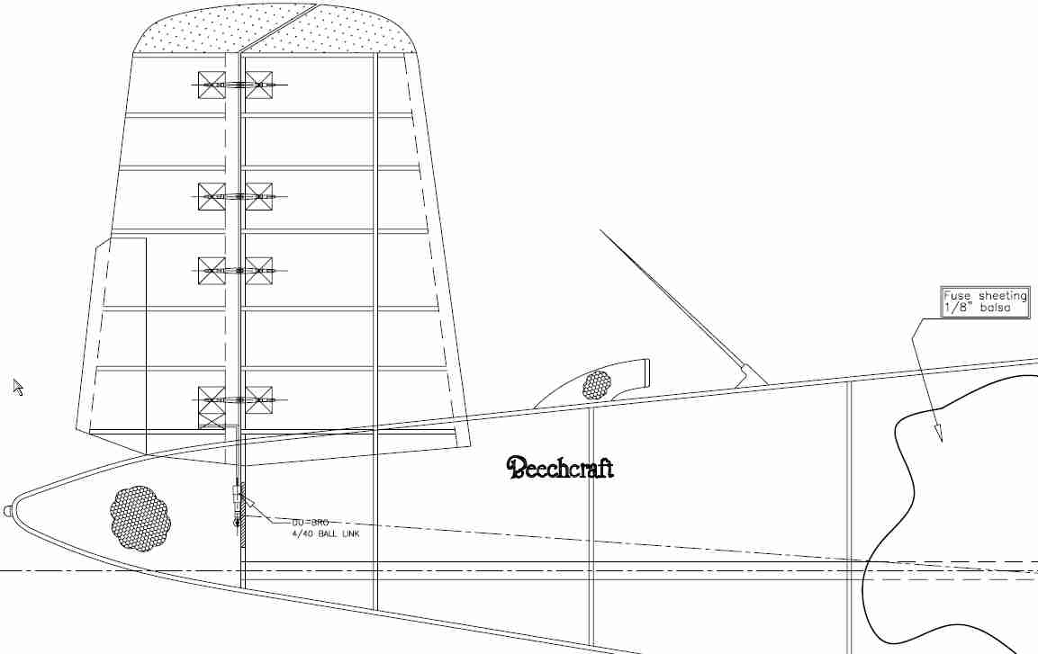

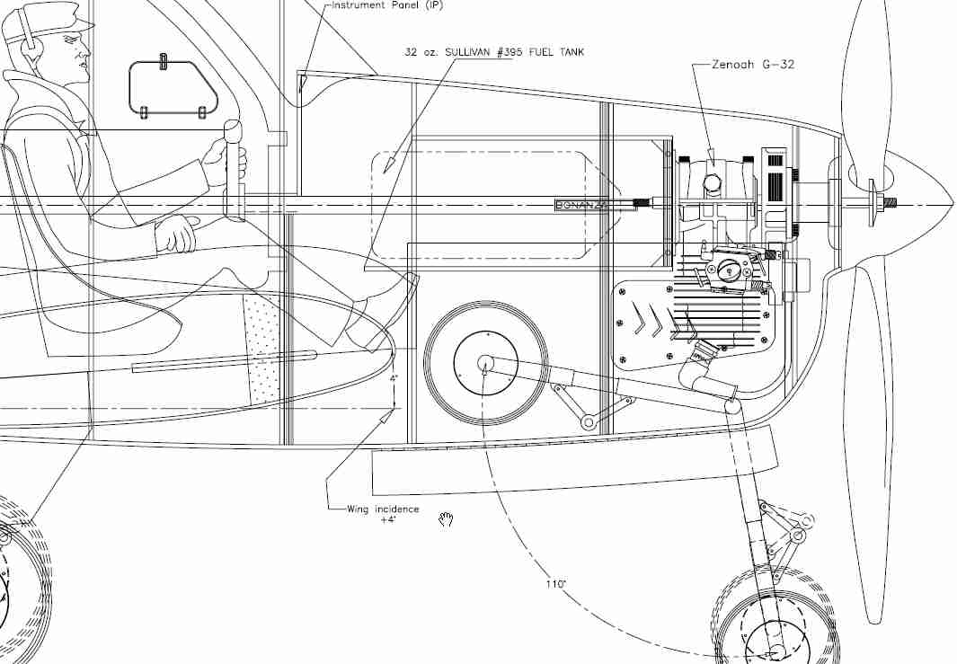

Old 10-25-2007 | 04:12 PM
chutt's Avatar
Joined: Nov 2003
Posts: 159
From: CuritibaPR, BRAZIL
Default RE: Bonanza
Hi all!
Here is some images of my Bonanza´s plans.
Andre.

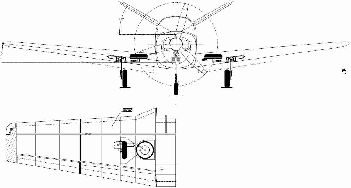

Old 10-25-2007 | 04:14 PM
chutt's Avatar
Joined: Nov 2003
Posts: 159
Default RE: Bonanza
Here more images...
Andre.

Old 11-11-2007 | 06:28 PM
Posts: 296
Default RE: Bonanza
Jetmech
here they are. Sorry for the delay...
ID:	801675   Click image for larger version
ID:	801676   Click image for larger version
Old 11-11-2007 | 06:30 PM
Posts: 296
Default RE: Bonanza
more...
ID:	801681   Click image for larger version
ID:	801682   Click image for larger version
Old 11-11-2007 | 06:32 PM
Posts: 296
Default RE: Bonanza
flaps
