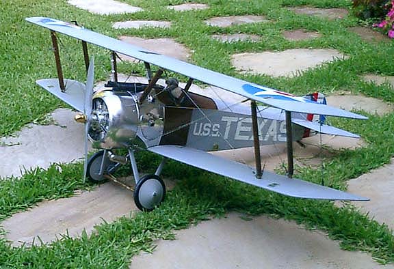

After lurking around for months watching related threads, I finally ordered a Pup kit from CD Scaledesigns. It will take a while for the kit to arrive but I have been collecting data for several years on this plane. I have the Windsock Datafile already and lots and lots of internet pix. I will probably build the RAAF replica version because I love the look of it. On the other hand, I have had some radio issues with my metal clad VK Camel and, until I sort those out, will also consider other schemes (some of which might also have the metal issues).
I am very interested in Pup B202 of which I have some pix of a scale model, but nothing on the real plane. Anybody know anything about this plane, particularly about documentation?
Other possibilities are N5192 and N6452 which I love but am worried about doing that engine turning properly.
My goal is to do a relatively fast build, not getting into total detail like I did on the Camel, or like Abu's incredible Snipe. I would hope to complete the build by May or June, using a Saito 65 or 72 with Spektrum radio. This is one reason the RAAF plane is appealing, it has a simpler covering without all the stitching, etc. (could even be done in iron-on film but I probably wouldn't).
Comments, info and advice are welcome, please.

[/quote][sm=thumbs_up.gif] I think you'll love it!
...but am worried about doing that engine turning properly.
This is really simple enough with a circle of scouring pad CA'ed to a dremel filing tool. Use a pencil to lay out some guide lines and off you go.
The great thing about Chris' kit is that even if you do a basic build you still get totally scale outlines.
I have a feeling that the 72 would be "too much engine" for such a light model as the Pup. I felt it was right for the heavier (and larger) Snipe (plus I can use the weight up front) but I'd go with either the Saito 65 or even just 58 on the Pup. Or are you doing the 1/5 scale version? Sure wish I could use a Spektrum radio here in Japan. []

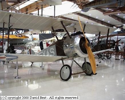

Randy, I am a member of the San Diego museum for just that reason and spend lots of time there, particularly hanging around that Pup. I also refer to the Shuttlesworth site, Don Coe's Pup build thread on RCSCALEBUILDER and Don's Snipe build for Sopwith detail discussions and ideas (also your great Hanriot thread).

I've taken about a thousand photos of that bare-bones Pup replica at the San Diego Aerospace Museum and have used them throughout my Snipe build to guide my thinking about Sopwith manufacturing techniques. I usualy get down (from Orange) for a visit each time I'm in the US. Hey, maybe we can even meet up there during my trip at Xmas time!

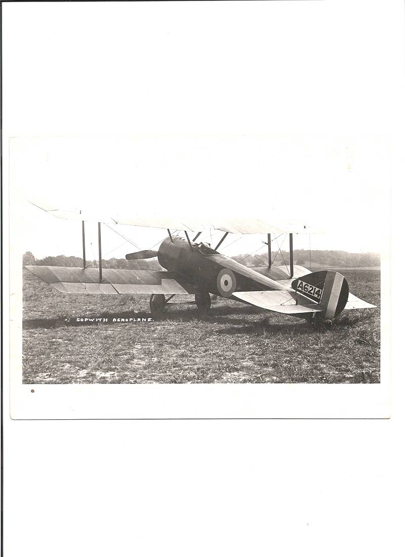

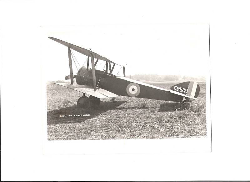

Here are some original Pup pics from 1917 that I got for my documentation for the 1985 Nats and the 1986 Masters. I sent to the Imperial War Museum in England for them. Black and white for sure, so color selection is the same guess for everyone . And these pics are clearer than they appear on line. This planes' combat days were over when pics were taken, but she survived for training purposes. The machine gun is gone but the lines and chutes are still there and a curved windscreen has been added. There is no center section cut-out and the cowl has a very interesting front. I can't tell you how many Pups I've built with this scheme and number but I always liked the "kinda used look". This looks like a fantastic kit you are attempting.Wish I had one in 1985, I had to draw my own plans and build from scratch. Was it worth it??.................Regards Jack

Those are great old photos of that Pup and, yes, scratch building is worth it.

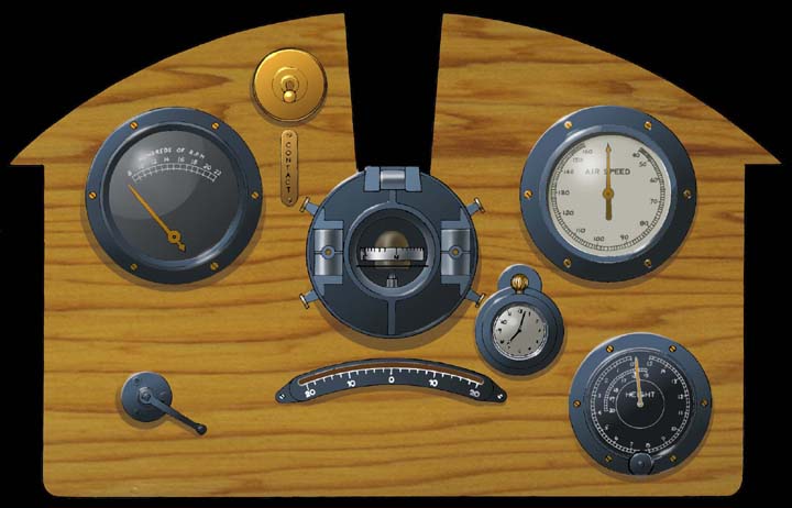

My engine came today. Fast shipping! This tends to whet the appetite for building but the kit won't be here for a while yet.
Since I have nothing to do I decided to try playing with the instrument panel which I will "fake" at this time with a printed graphic rather than an actual 3D effort.
I scanned the IP layout from the Windsock Data file, found some wood grain with Google and started a Photoshop try. Here it is so far after about an hour or so. It is scaled to 1/4 size but can easily be reduced to 1/6th for printing if it comes out okay.

Looks VERY good! I might recommend though finding an image of actual stained wood to use as a background. Something dark and rich.

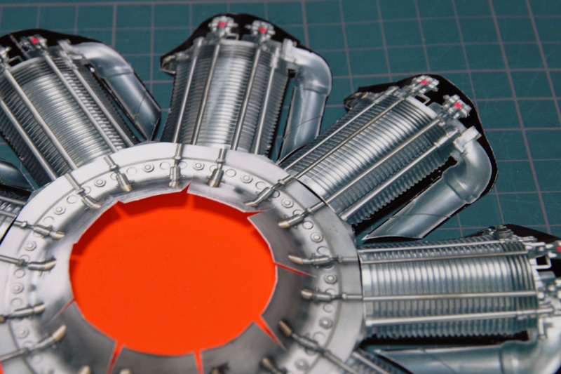

What I find myself interested in is the idea of simulating a 3-D effect with printed graphics. So for example you could print out an extra copy then cut up the parts and mount on balsa supports to give it more depth. I'm thinking of doing this with the engine on my Snipe. It's a technique artists refer to as a "tole."***
(***Thanks to Allen for the correction on this word. I believe he may have been the person who originally mentioned the idea to me)

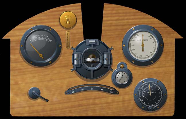

Added some shadows on the compass and got a better, more accurate, wood grain...

I love Sopwiths but the colors are rather uninteresting, other than for some strange training Pups which are a bit garish. As a result, my next scale project will probably be German. There is a great Albatros at the San Diego Museum I could do, or a Siemans Schuckert D.III, of which there are some great color schemes.
Strange that the supposedly uptight Germans had such fanciful and creative looking airplanes.
