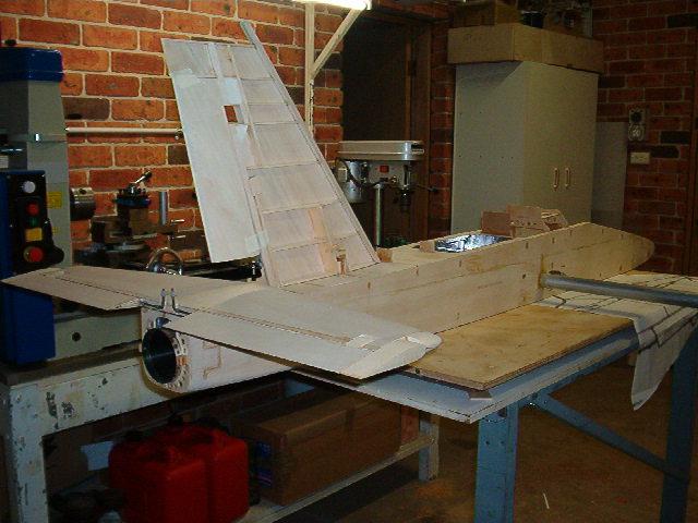

With the top sheeting on part of the box it becomes more rigid so the sides can be pulled in at the nose & formers fitted.
When I build fuselages I put marks on the middle of the formers with a pencil & draw a line down the centre of the building board. If the formers will not be sitting on the board I extend the centre marks down with little balsa tabs like you can see on the front former. When the sides are joined I tape them top & bottom to hold them together while the glue dries, line the lines on the formers up with the centre line on the board & hold them there with bricks. No more banana shaped fuselages!
As this model relys on the wing tube for alignment I block the tube up every time I am working on the fuselage to ensure it all stays square.
#29
The little tabs sticking out through the top sheeting are to support the rudder & elevator pushrods. The stainless steel ring below supports the outlet of the jetpipe & the back end of the outer pipe. Two small scews will go into the timber blocks to stop the ring sliding through the former. - John.

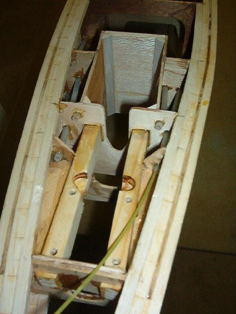

I've started on the wings. The first job was to make some sockets for the aluminium wing tube. I began by marking out how long I want the sockets to be on the wing tube. Then I smeared vaseline on the tube & wrapped 2 layers of sandwich plastic around the tube making it longer than where the socket would be starting, applying more vaseline between the first & second layer. The outer surface of the second layer has no vaseline on it.
I then wrapped 2 layers of 4 oz woven mat around the tube, applied polyester resin & then scraped off as much resin as I could.
The first one took some getting off the tube so I applied more vaseline to the second socket layup. Once it was sanded smooth on the outside I pulled out the plastic wrap, cleaned the inside out with acetone & sanded it inside with a dowel with a square of sandpaper taped to it in the electric drill. The result is below, a perfect sliding fit and it weighs about 1/2 oz.
There is also a short piece that goes through the fuselage. This will help spread the load of the wing tube & make it easier to slide through. This one's not quite set yet but I can tell already it will be easy to remove from the wing tube. - John.

Wing ribs are now cut except for the plywood ones (run out of wood) and the tailplane is started. I was not sure of the spar positions so I will cut them to suit later when I'm ready to fit them. The elevators have seperate mass & aerodynamic balances. Retracts are on the way, Robart 630 heavy duty jobbies with a 95 degree retract angle. The Macchi main gear retracts outwards like a Spitfire or ME 109 so the greater angle is needed so the gear can follow the extra angle of the dihedral. - John.

The turbine manufacturer, Wren, now recommends a larger distance from the engine nozzle to the jet pipe, this will be moved back.

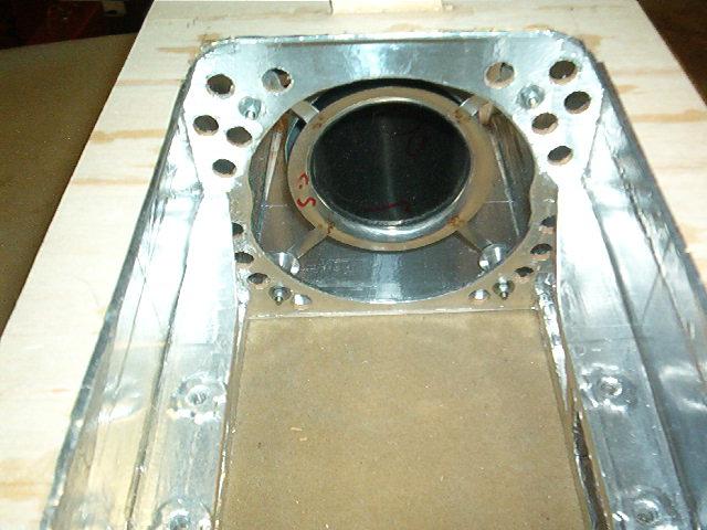

The manufacturer of my turbine (Wren) have informed me that a stronger jet pipe for my model engine, the Supersport, is now recommended following a couple of failures of the standard pipe with this more powerful engine.
I now have a new pipe & am fitting it to the model, this was originally a difficult job so thankfully the new pipe is almost the same. The manufacturer of the pipe has also suggested it be relocated rearwards 20 mm. I'll machine up some spacers rather than move the former. The pipe & the outer pipe will have to be trimmed 20 mm at the other end.
Fin & rudder are under construction, the two fin spars sticking out of the fuselage were wrong & had to be modified, D'OH! - John.

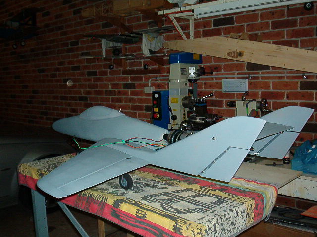

I've reached the point where the old thread is finished & the RCU thread begins in 'real time'. The trainer is racking up the hours & flys great.
The Macchi fin is half built, new pipe installed, rear fuselage lined with fire resistant aluminium tape & fully sheeted. I have also fitted the nosewheel retract & sorted out the mounting, the original formers (spaced for Rhom Air units) were wrong of course & had to be moved/modified. The nosewheel will not retract forwards like the full size but backwards. Much more room & much simpler steering linkages are the reasons. - John.

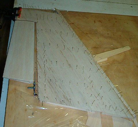

Views of the work done since the last post. The fin is now fully sheeted, once the tip is added I can sort the hinging, counterbalance & shrouds & it will be put aside while the wings are built. - John.

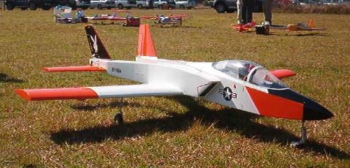

I bought an damaged ARF Bobcat 50 with 2 turbines at a bargain price & have been working on that for a couple of months.
Now it's flying & only needs paint I'm back on the Macchi.
Now, where was I up to....................
One thing that's come to light is that the Bobcat is a slippery little sucker & was difficult to slow down until I fitted an airbrake. The Macchi has a belly mounted airbrake & I was not going to make it functional so I'll have to have a rethink.

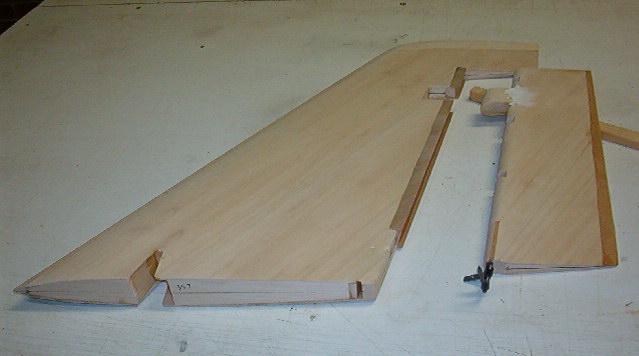

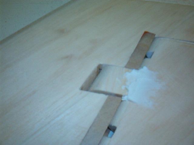

Started back where I left off, the fin & rudder. Fitted the rudder hinge shrouds tonight, made from .5 mm ply. I recessed the edge of the fin & glued these on. Also finished sanding the rudder mass balance. Also shown is the rudder horn made from 3 mm piano wire & the two lower hinges. - John.

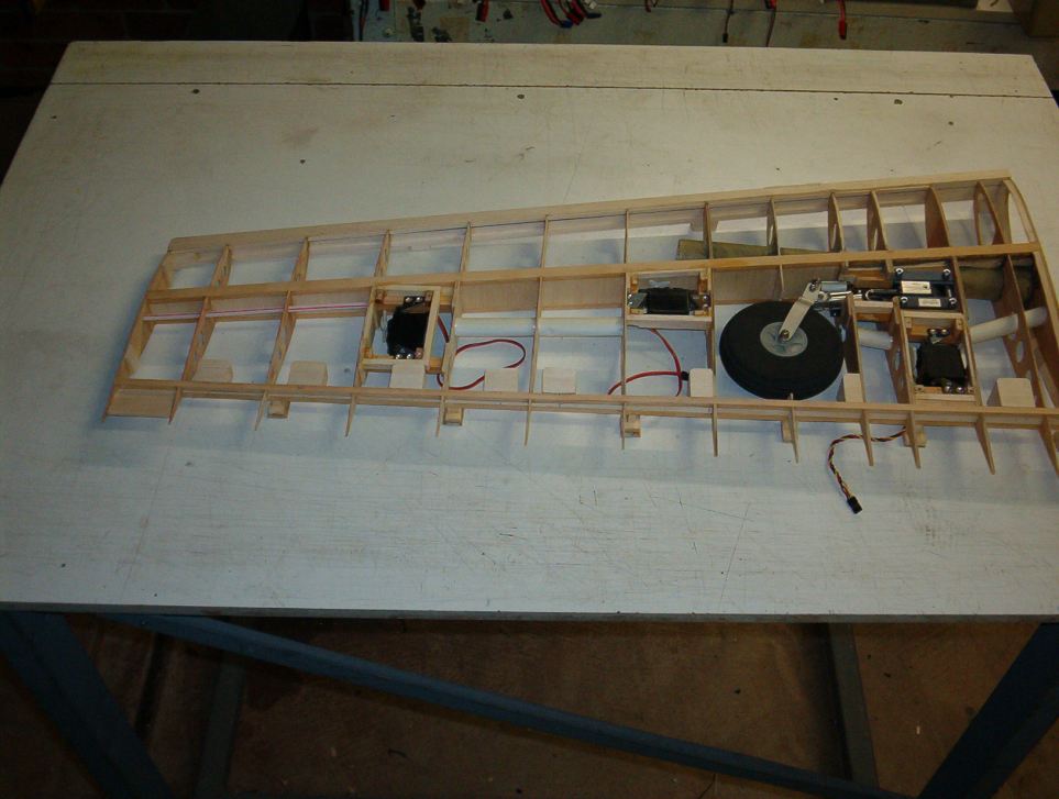

More progress on the wings, both panels framed up, wing tube sockets in, servo pockets & screw blocks for hatches in.
I made a mistake with the retract rails & the legs were not vertical so I made some small wedges to sit under the retracts,

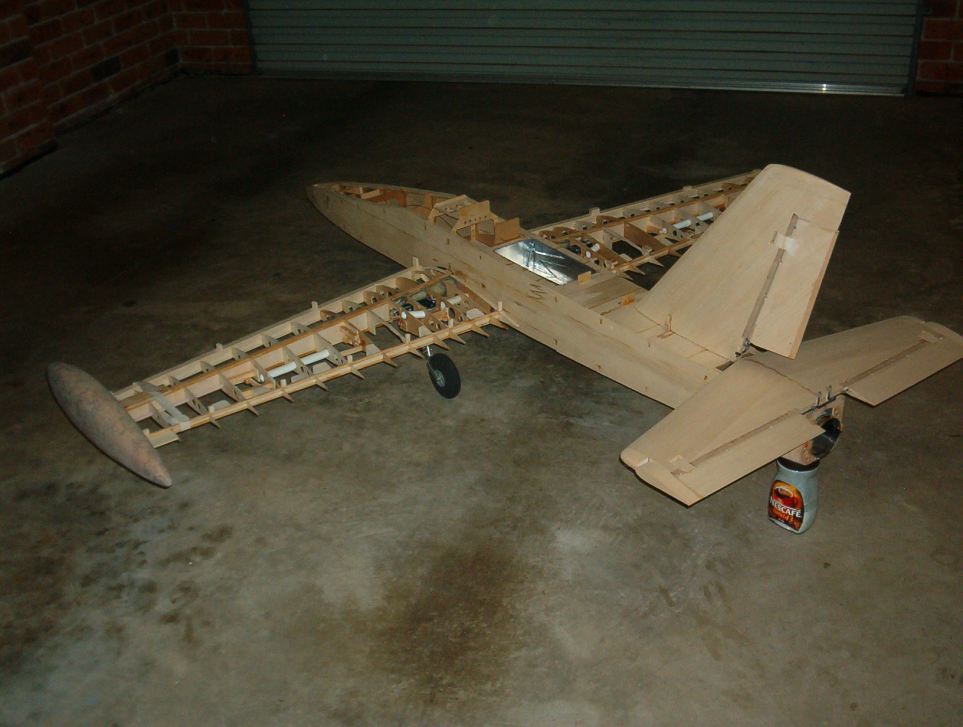

Finally, when you put all the bits together it starts to resemble an aeroplane!
I considered small air tanks in the tip tanks for the retracts but came up with another idea,
cap the ends off on the wing tube & use it as the air tank.
The weight of what you see here, minus the wing tip tank (which is the plug for the mould & quite heavy)
is 8 pounds including the retracts & dual wall jetpipe. - John.

Hopefully the weight will be less than the trainer I built, it's about 9 KG plus fuel. I cannot get
over the weight of some jets, I thought the trainer was heavy, most jet flyers think it's remarkably
light. The wings are now sheeted top & bottom.
The engine is a British Wren Supersport, approx 8 kg thrust.
The BVM Sabre mentioned above was a bit of a flop, not enough engine power for it to fly properly.
I was hoping that stripping out as much weight as possible it would fly on a Wren 44 turbine, about
7 pounds of thrust. It's now refitted with a much more powerful engine, a Jetcat P-60 with about 13
pounds of thrust so all should be good now. - John.
