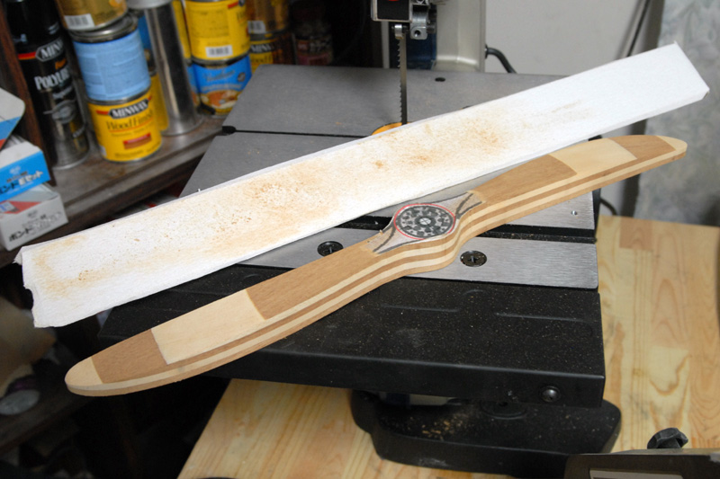

So on to modeling the prop. The first step was to create the laminations. There appear to be 5 laminations (dark-light-dark-light-dark) so for a scale thickness I needed 5 sheets of 3/16 hardwood. I went with three sheets of mahogany and two of basswood because that's what was available in the hobby shop (in Southern Cal). After appliying liberal amounts of Titebond I clamps them together and let them dry overnight.
But then it was time to fly back to the Japan so the laminationed wood was stuffed into my suitcase. Once back in the Japan, I printed out the final propeller outlines (actually I had to split the image in two to fit on my A4 paper), I sprayed the wood with 3M spray glue and stuck on the drawing.

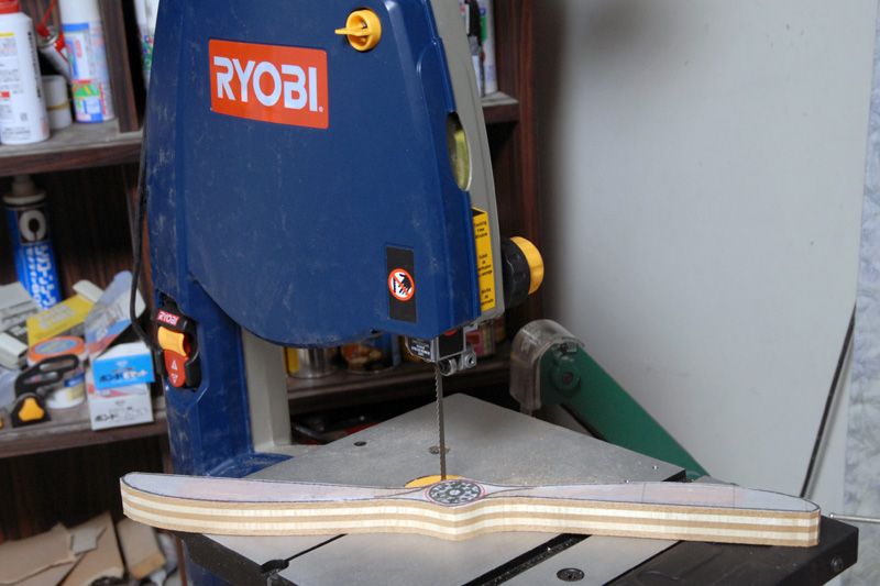

The first step was to cut out the outline with the Ryobi 9" band saw that I picked up with "Christmas money." Yes, I hauled it all the way back to Japan with me!
Man, is that one sweet little power tool for $99! It cut through the laminations like a hot knife through foam. Doing this with my scroll saw would have been a tough job.

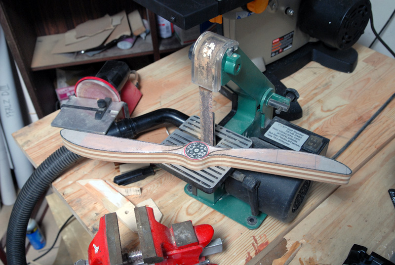

Next I used my cheapy Harbor Freight 1" belt sander to sand the rough cut piece to the outlines.
Then, I flipped the piece on it's side, and drew on the profile using the drawing as a template.
Then I used the bandsaw to do a rough cut to that profile (which is conveniently flat on the back).
Next, I used a sanding bar to fine-tune the profile which reveals bands of the different colored wood.
After that, I marked out the curves for the laminations as per the photo and added marks to guide my cutting.
Then it's whittling time! First I carved down the back side of the blade. This face is mostly flat.
Next, I used the sanding bar to shape the front of the blades, The wood was actually quite easy to same. I knew I had the right curves when the laminations started to look like the photo. There's still a lot of fine-tuning to be done as well as finishing and making a hub but I've enjoyed all the research and carving and it was a fun little Xmas project.

BTW, if I had gotten the profile wrong, the bands of the laminations would have worked out all wrong. Actually based on some eye-ball photometry I had worked out what "must be" the profile in order for the laminations to appear the way they do in the photo. It was really satisfying to find that the profile from the datafile matched my "imagined" profile almost exactly.
It was a surprise to me how the geometry of the propeller blades produced completely different patterns in the laminations on the front vs. the reverse. The pattern on the back of the blade reflects that fact that this side is essentially flat with an essentially equal angle through all the laminations. The pattern on the front reveals how the blade has an airfoil curved surface which is much flatter towards the tips and very steep (and thick) towards the hub.
This prop would have been designed to spin at about 1400 rpm. It's quite thick compared to the props we use on our RC models -- something on the order of a 18 inch prop with a pitch of 15-16.
I'll add also that carving the prop is not at all hard. Once you get your head around the ways things curve (e.g. which is the leading edge and which the trailing edge) the actual carving follows very natural lines. Whittling and sanding the wood seemed like the most natural and intuitive thing in the world. Actually the different colored laminations actually help in this regard since the pattern revealed during sanding can serve as a guide. The lines should curve smoothly. I didn't really have any idea what the reverse would look like but I noticed that once I had sanded the surface flat I got more or less equal bands.
Rough sanding was easily accomplished with an aluminum sanding bar -- followed by some 80 grit sandpaper wrapped around a 1" dowel section. I was also surprised by how easily the "hardwood" sands. The 80 grit paper cut right through it. In fact, I didn't use anything but sanding to shape the front of the blades. Besides, it was also fun to see sawdust in another color besides "balsa!"

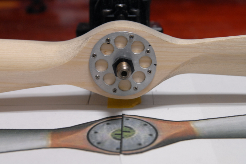

Hey Don, your prop looks great! Your hub will be fine just make sure the bit doesn't "walk". I use a punch to mark the center of the hole which keeps the bit from walking. I don't know why I am telling you this because you probably know. Oh well, just my two cents worth. Good luck with this project.
Actually what I should probably do is drill all the holes first (using the drawing as a guide glued to the metal/ply) before going to the effort to cut it out. Even with the center punch I've still had problems with holes being micro-millimeters out of position which in such a tight pattern can cause problems. I had this problem with the hub on the prop I made for my Snipe. I ended out "evening out" some of the holes with a rat-tail file.
Actually, come to think of it, the pattern I posted isn't even the hub for the Mercedes 180 -- it the pattern I used on the Snipe prop! [:@] That hub has 17 hole to drill but the image I have of the hub on for the Mercedes has two circles of lightening holes for a total of 25 holes!
