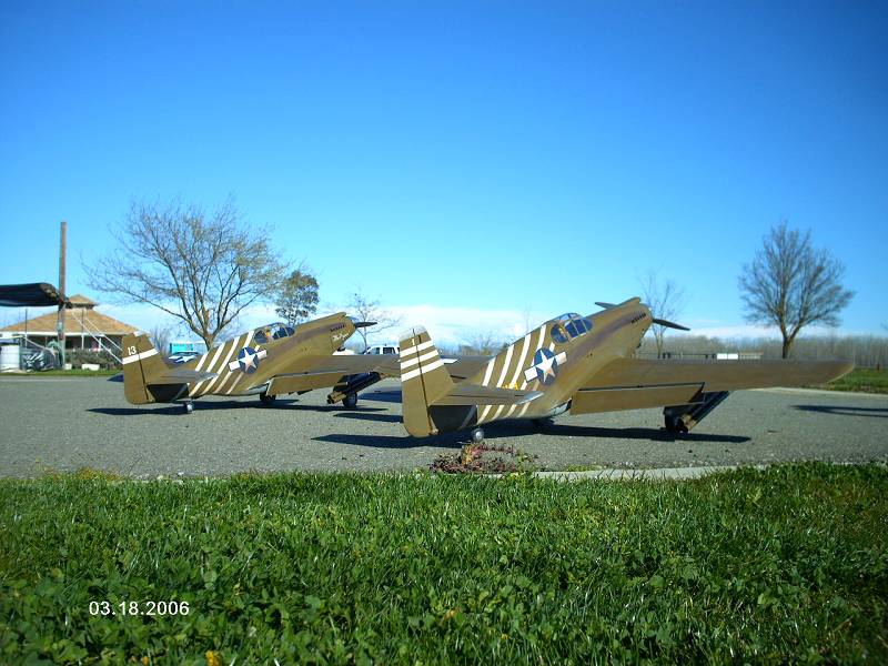

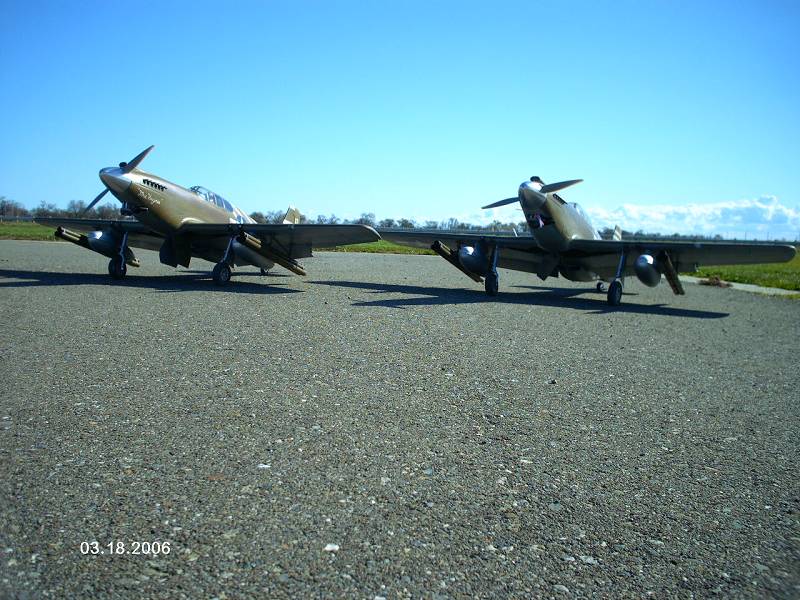

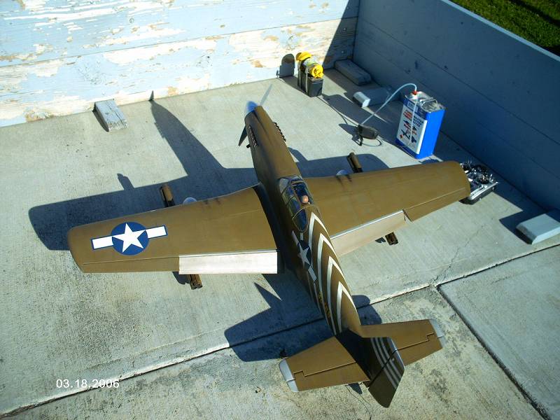

Hey how is it going nice to see some one else do this mustang here are some pics of a friends and my a models in 8 th scale. What scale will yours be?
Tim

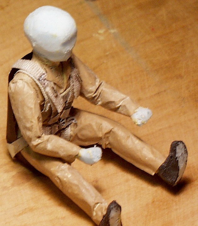

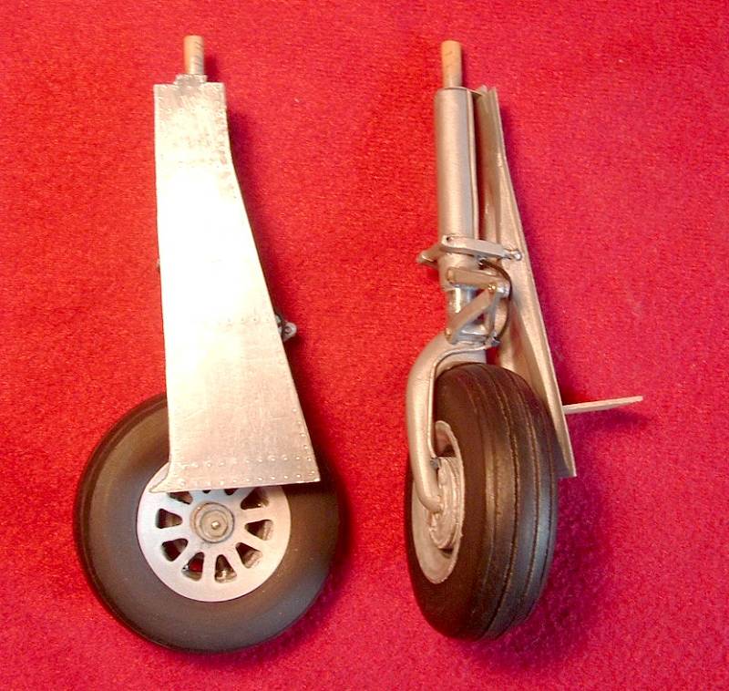

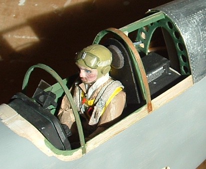

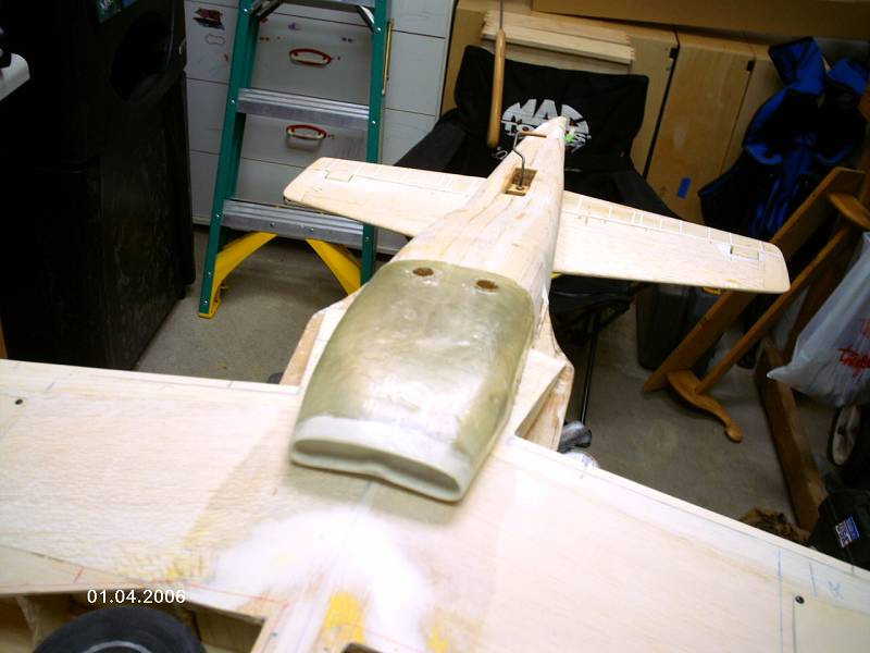

Awesome airplanes! I'd like to know which plans/kits they were from as they're some of the best "A" 's I've ever seen. I was thinking about putting some 500 lb.'ers on mine but I've already gone way over the line (Yes, I need a life!)
Mine began life as a desire to build a "throw in the car, go fly cheap" aircraft but it's evolved into such a detailled, extraordinary ship that I'd fly it, maybe, once a year for fear of dumb thumbing it. "Gravity always wins, it's just a matter of when"
I'm enclosing some pics in progress. The static, struts/wheels are hand-made of balsa with the outer rims Dremelled beer can bottoms. The doors are of aluminum inside and out and the links made from styrene. (No! I'll never do that again!) The mains as well as tail gear/doors assembly come off for flight with pop in doors for where the main strut covers go. So far she weighs 14.5 oz. w/all aboard but I'm shooting for 16 oz., once "aluminized", for a wing loading of around 10.75 oz./sq.ft. We'll see?! It's got an .049 mounted but I've got a .10 that's dying to go in her. With Mylar, (32,000 psi tensile strength), she's stout!
"Charlie" was to be the subject of an article for MAN on building fully articulated pilots and connecting controls to the throttle, stick and rudder pedals. He's carved from foam, jointed with thread and dressed in Saran Wrap which gives it the scale wrinkles.

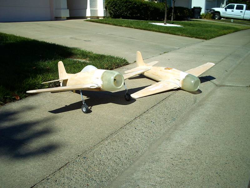

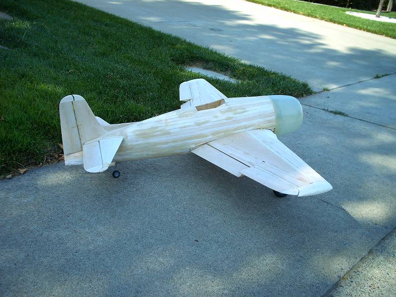

Im glad to see someone puts some effort in detailing small planes too. These planes came fom the idea to make nice every day fun flying scale planes at about 40 to 60 size but in an 1/8 scale format so when you have a p 47 next to mustang you can see the true size difference. These are and were drawn with my friend Mark they fly great. We had hoped on making kits from them but there are many obstcals in doing so. we have been working on bearcats as of now to be as scale as we can get them for the average modeler. keep up the good work. Tim

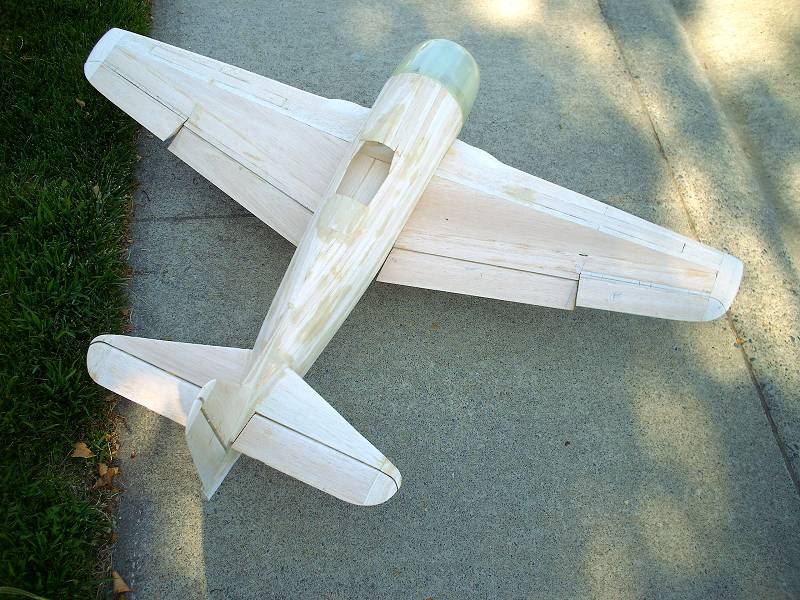

coulpe of pics of bearcats

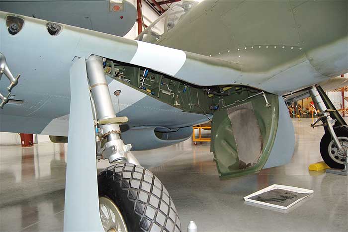

I'm curious, do the inner doors on your P-51's cycle (Per full scale) and what type of engineering went into that?
(Incidentally, for the uninformed, the "A" variant inner doors locked in the up position when finishing cycling and the flaps/inner doors didn't droop from oil pressure drop as they did on all later variants.) Many modellers miss that small, albeit very important, static detail.

When the D was introduced the wing was thickened to allow the 50 cal machine guns to be mounted apright to rectify the jamming problem that the B and C had and go to 3 guns per wing side.
I believe this to be an urban legend. I've spoken with several very well versed Mustang afficianados and, to my knowledge, none of them have ever found any official documentation that states that the airfoils used were different on the D than they were on the earlier Mustangs. I've also read reports by several folks who have restored and/or worked on both B and D versions of the Mustang and they agree the airfoils are the same between the two. If anyone has any documentation to the contrary I would love to see it.
The leading edge extension was increased on the D wing and the inner gear doors are slightly different as well as the revised armament to round out the changes to the wing.

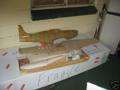

OK guys , I have a Brian Taylor P51 B with the vertical stab extension. What is the story behind this model? The kit is pretty old and the fiberglass fuse is pretty heavy. It is a 60 size plane, Any interesting pics of thismodel out there?

here s th?e pic of the P51B with the vert stab extension. hey dont I get any grade for my trivial pursuit answers

Sorry madmax, you get a C+ because the doors remained the same on the B/C and did not change until the D model Mustang. The Squadron Signal 3-views you posted are notoriously wrong in that respect!

You may want to reassess my grade Sometimes your sources should be questioned. According to my sources, the B doors were changed because the area at the leading edge of the inner doors had to be deepened in order to properly meet the deeper sheet metal of the Merlin engine's installation. (That's also the reason the LEX were changed.) Notice on the attached photos where the leading edge intersects the fuse. on the XP-51...also notice where the leading edge appears to "break" downward, relative to the gear leg. The "B" wing breaks immediately inboard of the main strut and angles more downward. Now look at the depth difference of the fuselages where the leading edges intersect the fuselages. (A Picture's worth a 1,000 words.)
Learning's a wonderful experience, isn' it?
