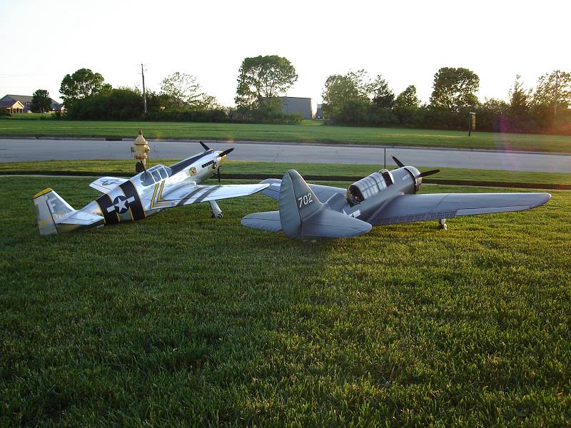

I have been given a TF P-51 Gold Edition kit to build the B model and I wish to do a little cosmetic work to make it look like the A-36 Apache as well as add functional dive brakes to the wings.
Rather than reinvent the wheel, I thought I'd ask in here first to see if anyone has already rigged up the mechanism for the dive brakes in
this plane.
So, are there any working examples out there for me to reverse engineer??

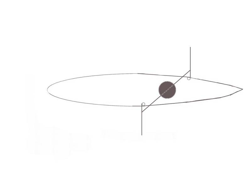

I have been looking at the images I can find on the intardnet and think that I can rig up a set on my own to use for developing the final working versions to go in the plane.
I have noticed that the lower brakes open swinging down and forward as the uppers swing up and aft.
I think this may cause a balancing force between them that will help keep the servo loads reasonable.

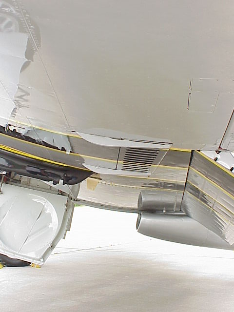

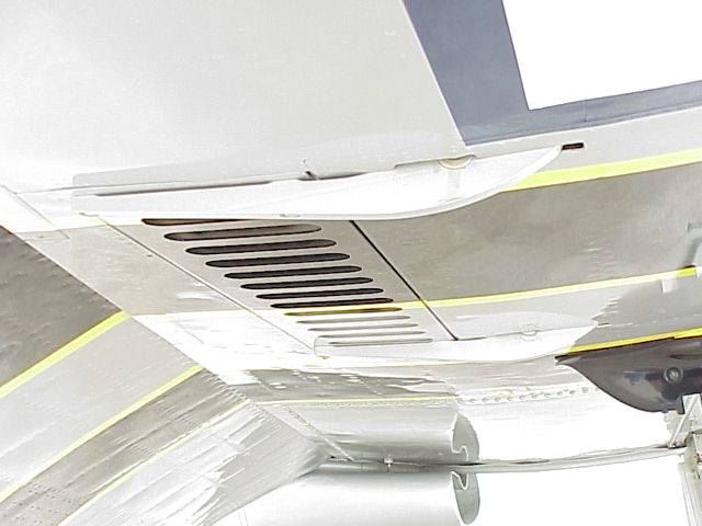

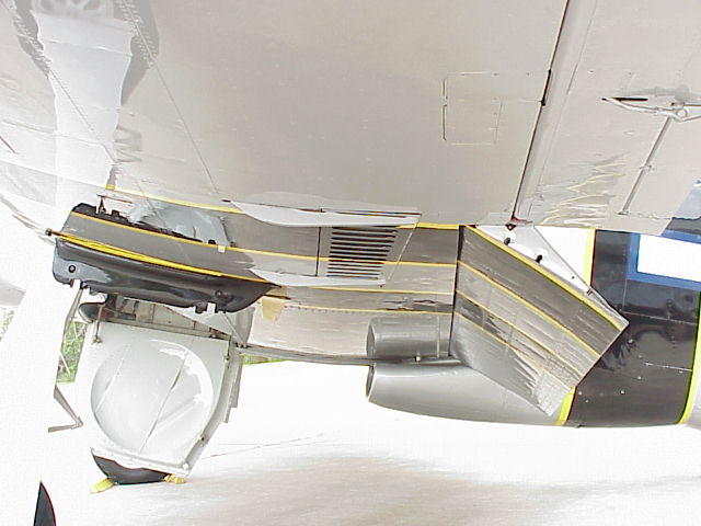

ORIGINAL: Tommy_Gun I wish to do a little cosmetic work to make it look like the A-36 Apache as well as add functional dive brakes to the wings. Thanks
Tom Freidkin's A-36 Apache was located three miles South of me for years. Here are a few dive brake and a few other area images to give you some 1:1 real world close-ups for your conversion. Its not a perfect doc set, but then again...it was free : )
Thanks FM!
Thats exactly what I need.
I had seen some but not all of these images on the web.
Are there any images of the brakes deployed?

All the diver brakes on A36's were eventually locked closed because of the problem it poised with aileron control and buffeting it created for the wing. Its going to be simple to replicate as you need only place a plate between the rib at the level of the skin on the top and bottom. Attach an aluminum bell crank turned sideways and drive both top and bottom brakes from a single servo in the center of the wing. Why a single? Well...two might not load up equally and result in a problem of no aileron control.
The cowl alteration will leave you with an exposed two cycle or four cycle head unless you use an RCV and its probably the best to use because it affords more torque for the three blad prop at such a small diameter.

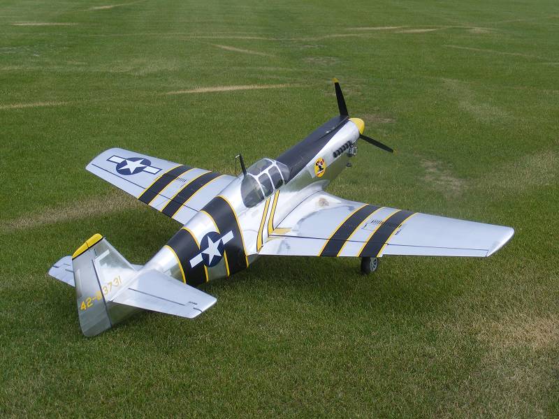

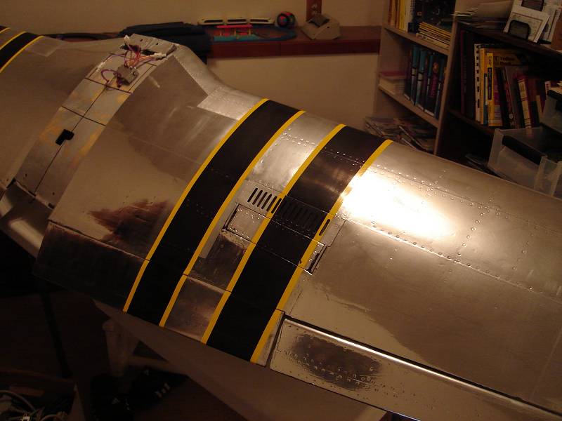

WOW! I wish I would've run into you guys sooner. I'm currently finishing an A-36 converted from a 1/5 scale Pica kit. I plan to test fly it next weekend, all I have left to do is hinge and hook-up the linkages for the dive brakes. Tommy Gun, I will post pics of my linkage system once I get it installed and working. It was based on a two servo set up, one servo in each wing driving the top and bottom brake. I found that this set-up allowed the dive brake to flex when deployed, two additional servos easily fixed this issue.
Oh yeah, my model is finished in the colors of Tom Freidkin's A-36. Only difference being, I wanted to do a natural metal finish versus the painted silver. I wish I would have had your pictures about a month ago when I started working on the markings.

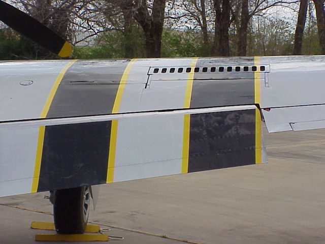

I've had those photos in the Walkaround section of ScaleAero for many years. Its got some holes which fell victim to several server crashes but for the most part is intact. Tom's A-36 is actually a composite rebuild from multiple airframes. Its no longer here in Houston. It along with others Tom had here moved to Chino with his many others. His hangar in Chino can be seen online.
Almost forgot to post this...Tom's A-36 is painted silver, not natural aluminum to protect it. Don't know what the current finish is since it was being stripped down to bare essentials and reassembly. I'm guessing its still painted considering the rarity of the bird.
Note the hinge direction of the dive brake on top of the wing vs that of the dive brake on the bottom of each wing... It opens 180 degrees out from the opposite side of the wing. Can you imagine the pressure against the top dive brake? I can imagine this could become problematic and be a constant maintenance point... I took a moment to point to the hinge point of the top brake.
Its interesting you made your dive brakes functional. I understood they were of little positive influence and were wired shut by ground crews to prevent their ill effects.
Now, having stated that, I revisited resources to provide a back-up of what I was saying someone else claimed... : )

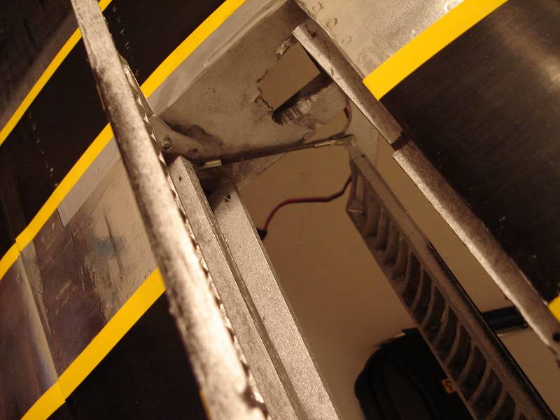

As I understand it, his A-36 is currently being re-restored. When it came back from the Flying Legends show in Duxford, it was never reassembled, just stored till work could begin on it. I don't know how they are planning to refinish it. Personally, I'd like to see it in a war-era scheme (OD over Gray). Several A-36's based in Siciliy completed 200+ missions, one in particular had the mission marks starting at the nose and running all the way down the left side. Might be interesting to see full-scale.
Wind pressure on the dive brakes shouldn't be an issue. There is a rod that connects the top and bottom brake within the wing. As the top brake is is opened, it pushes the bottom brake open. The wind helps open the top brake, and pushes the bottom brake closed. Since they're linked together, the wind pressure on both brakes should cancel out leaving little load on the hydraulic cylinders driving them; or in the case of the model, the servo. The "Allison Mustangs Walkaround" book by Squadron Signals has a good diagram of this system.
I chose to make the brakes operational, because I like models that function the same as the full scale. If they prove to be problematic, or a maitenance issue (both likely) I simply won't deploy them. And this way, all the static pictures can show them open helping distinguish the model as an A-36, not a P-51A.

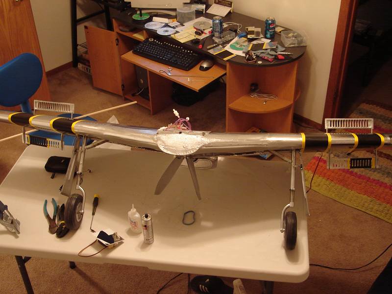

Apparently I lied. I didn't intend to, but I did. My dive brakes are not functional, as of yesterday. When I tried to instal them and get all the linkages connected, I ran into a problem with clearance. One of the rods linking the top and bottom brake was interefering with the servos driving the brakes. End result, I couldn't get the top brake to close tightly. I was very nervous about that top brake being blow open by the wind, so I decided to abandon the idea of functioning brakes and screwed them down. I did take some pics before I locked them down to give you an idea of what my set-up looked like. Maybe they will help you avoid the problems I ran into.
By the way, Tom's "Boxing Parrot" was the emblem for the Eagles Squadron; the RAF's squadron of volunteer US pilots prior to the US entering WWII. What a cool emblem to have as a personal logo. The bird can stay, just paint the plane O.D. over gray.

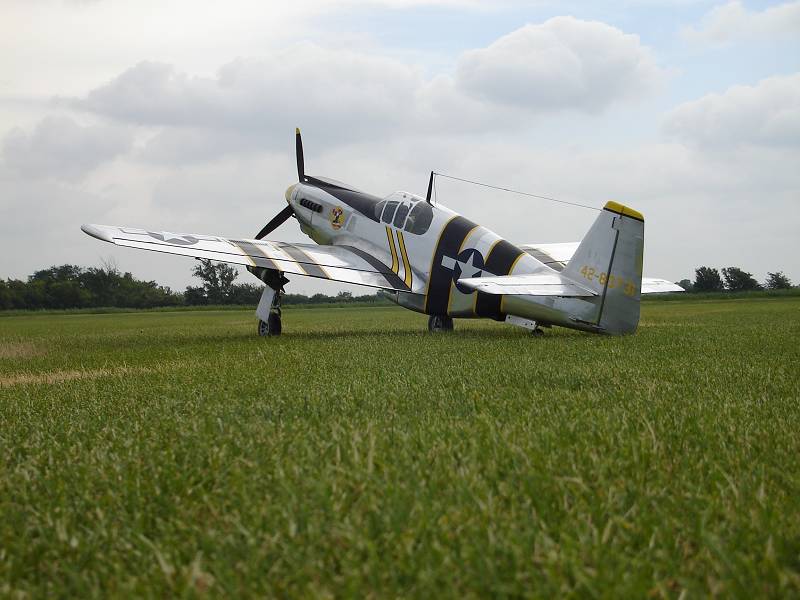

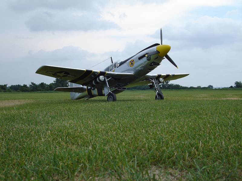

Test flew my A-36 this morning. Sweet flier! Little slow with the 3-blade, but very stable.

Thanks for the shots of your dive brake assy.
It looks like you did a fair bit of engineering there.
I hope you are able to figure a work around for your linkage.
Nice job!
Here is my first draft of what I am planning.
This would use a small retract servo at the outer and inner end of each dive brake bay.
I have not yet worked out the geometry for the linkage, but it looks workable to me.
