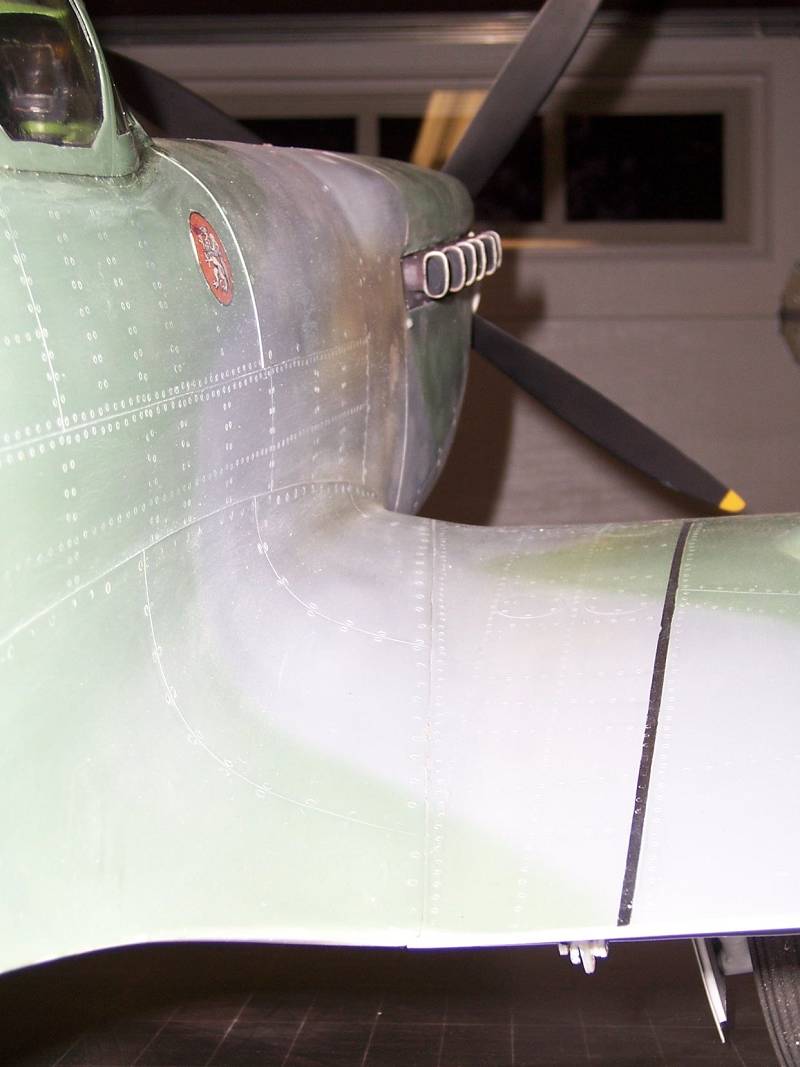

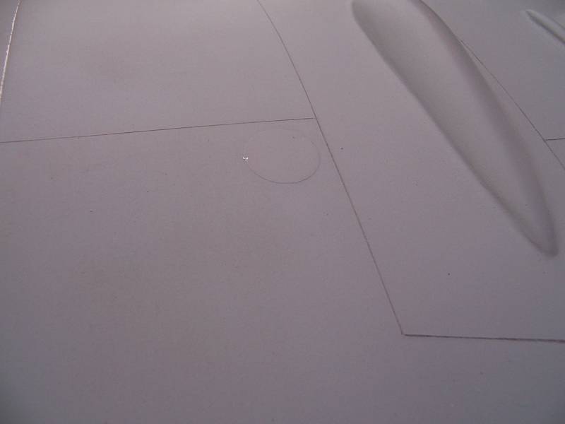

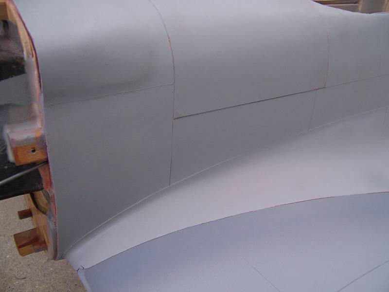

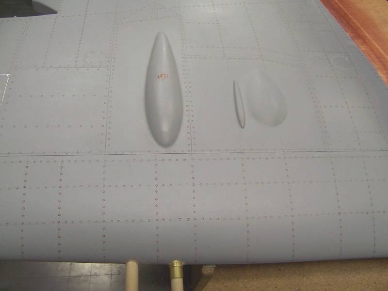

I used these techniques on a 1/7 scale Spitfire with good results.
Panel lines and rivets done in the primer coat, once the surface is ready for priming.
Lay out the panel lines using a flexible plastic rule and a pencil, working from your reference drawings/photos.
Work on one major surface at a time (lower wing, upper wing, left fuse, right fuse, ect.).
For butt joint panel lines, use 1/64" chart tape and lay the panel lines out. Use a high build primer. Spray several coats over the tape lines, feathering the primer towards the center of the panels. Once dry, remove the tape. This will leave a groove in the primer. The adhesive will tend to stay in the groove. I use a small scraper (grind a small hook in the back of a #11 blade with the tip broken off) to remove the debris. Lightly sand with 320 grit to get rid of any roughness.
For lap joint panel lines. Use painters masking tape layed out on the low panel along the panel line. Spray several coats over the joint, feathering the primer towards the center of the high panel. Once dry, remove the tape. This will leave a ridge in the primer to simulate the joint. Lightlysand with 320 grit to get rid of any roughtness. For thicker overlaps, such as around the nose fuel tank on a Spitfire, I use several layers of tape, and instead of primer, I use auto body spot filler in a tube spread on with a small plastic spreader (a phony credit card works well). Once dry, remove the tape and lightly sand with 320 grit.
For flush rivets, you need to make a special tool made from brass tubing. You need to find a way to attach a 1/16" brass tube to a soldering iron (in my case I used a trim covering iron and nestled tubing up to the size that fit inside the mounting tip).
After you have primed the plane you can start the process. Lay out all the rivet lines and rivet spacings using a rule. Now press the tip of the tool into the primer to melt a ring into the surface for each rivet. Lightly sand with 320 grit.
The plane is now ready for color coats.

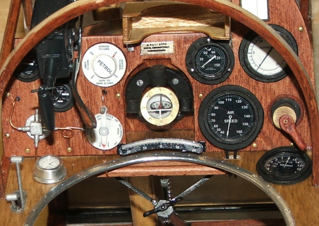

What I would like to know/see is how the instrument panels are made..
I have seen pictures on here of several WW1 planes with beautiful instrument
panels...

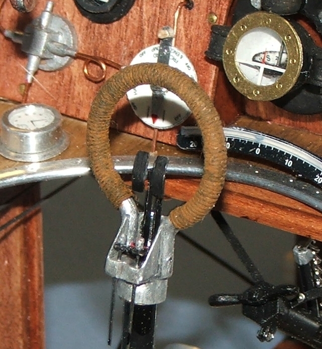

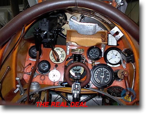

#31

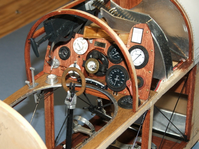

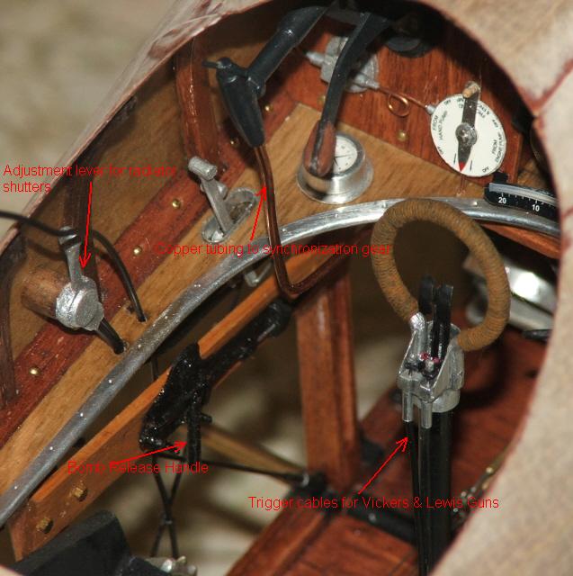

Instrument panels. As with anything scale, you start out with pictures, drawings, etc. Then with a clear picture in your mind, figure out how to duplicate each peice. You can buy instrument faces and bezels for some scales and eras.
For my SE5a, I decided to make them from scratch. I made the faces using Model Cad. I used pictures of each instrument and drew the face over it. With Model Cad you can print the finished drawing any scale you want. For the bezels, I used various peices of tubing ( copper, brass, plastic, ink pens, whatever I could find that was the right diameter) Most of the bezels had a small inner ring and a wider outer ring. I glued a peice of clear acetate to the back ot the smaller ring and glued the face to the back of the larger ring. This gives them depth,and looks real.
The compas is made from a peice a dowel rod. I shaped it by turning it in a drill press and using sand paper to round off the end. Then I hollowed it out with a dremel tool. I drew the dial ring with model cad, cut it out, wrapped it around, and glued it with CA. Next I made the center supports,and suspended it with a fine music wire through the center. The cover is clear acetate with a brass ring I made with the trusty ol dremel tool The diameter of the compas is 1/2".
The rest is just bits & peices of this and that. Be creative and above all, have fun
Steve

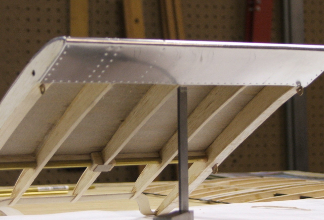

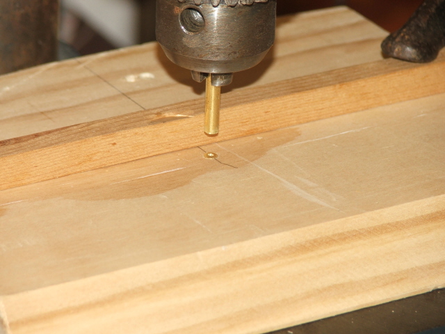

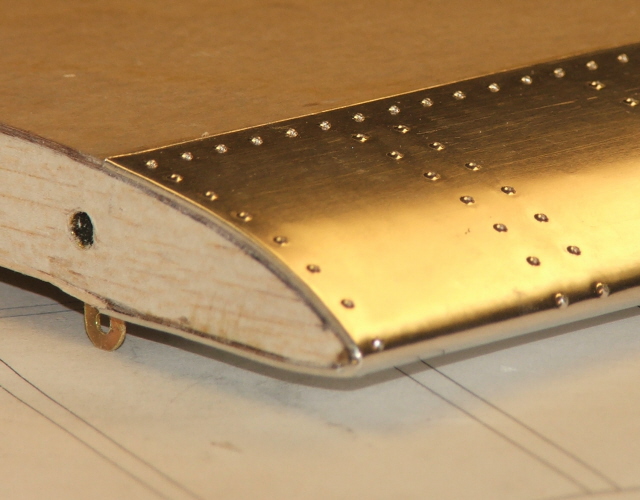

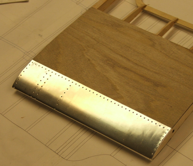

#34
This is a great thread, but unless it gets posted to daily, it falls back and gets lost in the " OLD Threads Home"

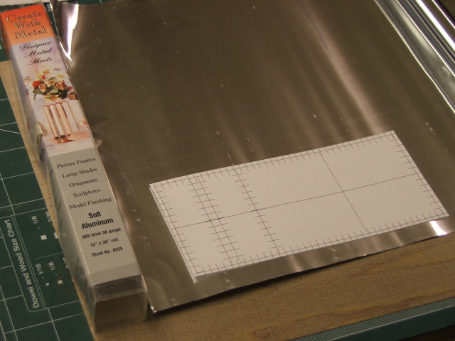

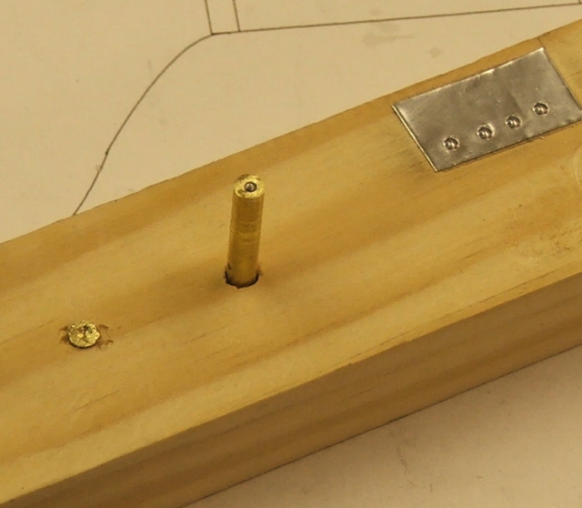

Anyway, How To Make Rivets.
There are a lot of methods for doing rivets, From glue drops to Punching them out of pop cans and glueing them on. I haven't seen anyone use this method, so here goes.
To simulate a riveted wing tank, I made a die and pressed "rivets" into .005 soft Aluminum, and then used contact cement to laminate it to the plywood sheeting. The material is very light (3.2 grams for a 28sq.inch piece) and easy to work with.
I made the die from 5/32" brass rod and 3/64 music wire. Take a peice of rod 1" long and drill a 3/64 hole about 1/2" into the center. Take a piece of 3/64 Music wire and round over one end( I used a dremel cutoff wheel). Mark and cut the wire so that ii fits into the brass rod with only the rounded part sticking out.
The second half of the die is made by cutting a peice of the rod about 1/4" long. Inset this peice into a wood base so that it sticks out about 1/32". Use a 1/16" dril to make a shallow indent in the center of the rod.
The rest is easy . Chuck the 1" peice in your drill press, and clamp the base peice to line up with it. Use the drill press like an arbor press(Don"t Turn It On!!) Just place your material between the two peices and press.
Using a two pard die makes crisp, clean" rivets " without bending the metal around them.Make different size dies for different size rivets.
I draw out the rivet pattern, and tape it to the aluminum. Just press through the paper

I love the look of those rivets, but at 3.2 grams for 28 sq. in., that comes out to nearly a pound for a plane like the 1/7 scale TF Spitfire. For smaller details, or on a larger scale plane, it might be ok.
Scott
Scott
#37
Hi, Scott. You're right. I wasn't thinking in terms of covering a whole plane with aluminum. For WWI stuff, most of the plane is covered with fabric. There are just a few areas where I need a riveted metal look.
