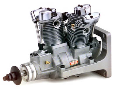

With the long, thin cowl how about a Saito 200 inline twin? - John.

Traditionalist or not, you may need to reevaluate your stance on 4-strokes. In the field of scale models, 4-strokes are the dominant engine type. Check out the models at TopGun and I think you'll be hard pressed to find a 2-stroke. The two main reasons for this are: 1) thrust and 2) sound. A 4-stroke engine, while not running at the same RMP of a 2-stroke, is nevertheless capable of producing more prop-turning torque.
And a good 4-stroke (for example, from Saito or OS or a Laser) is as reliable as they come.
Also common wisdom would probably say that for an 80" biplane you'll need at least a 90 class 4-stroke and for anything approaching aerobatic performance a 1.20. You might want to have a look at the Saito 100, 123 or the newly introduced 115.

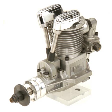

I took a look at the Saito engines. The 150 or the 180 may also be an attractive choice. Ever see them at work?
Did I mention the Ag Cat's wings are metal covered? I'll use balsa, but I am considering covering the wings and airframe with metal. I have a lot of experience working with metal.

Here's a photo of Engine possibilities. I'll get the photo of the 150.
I do hope suggestions and conversations keep coming.
Charles

A fellow club member has a YS 140 & it has been no end of trouble, a real PIA. I find this curious as the pattern flyers love them & competition flyers cannot afford unreliability.
This is the Saito I suggested, two cylinders in line so it's easier to fit in long thin cowls (like yours). I'm not a Saito groupie, I just use what works which is usually OS but most people I know with Saitos are delighted with them. John.
John,
The twin you suggest is, most likely, wider at the head, than a single cylinder engine. The engine will also be inverted. So now I have two cylinders to deal with and not one. Two plugs that can fowl and not one. Not to mention twice as many moving parts.
With all this said, I'm electing to deal with ony one cylinder. I'm currently thinking the YS 170 4S.
But it's a fine looking twin.
Thanks for the reply.
Charles
Charles
