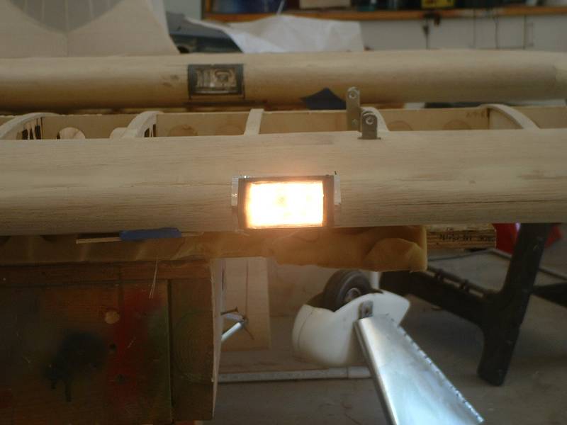

hi heres what im doing in my 40% waco the landing lights are modified fog lamps i got at a parts store .i like to be able to see the lights when i turn final they are halogen operated on 8.4 lipos , vern
