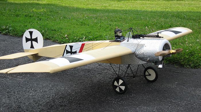

Hi abufletcher,
You're the one that told me how un-scale the BSA kit was and told me to just build it and have fun. The bird came out nice and it's a pleasure to fly. It's now one of my favorites.
Bob

And you've done a great job on it! [sm=thumbs_up.gif][sm=thumbs_up.gif] I often think that the RC model version of the eindecker has taken on a life of its own and become "real" in its own unique way that no longer depends on historical accuracy.
PS. Can we get a close up of that pilot!

Here's the pilot close up:
http://www.rcuvideos.com/video/Eindecker-40-Pilot
I had fun building it.

Pure fun! [sm=thumbs_up.gif] What's the trick to the mechanism?

wicked cool . is that a skull ?? .... I suppose you could have him looking up and down as well.

It's just a micro servo mixed with the rudder. I know, I'm not normal[sm=wink_smile.gif]
