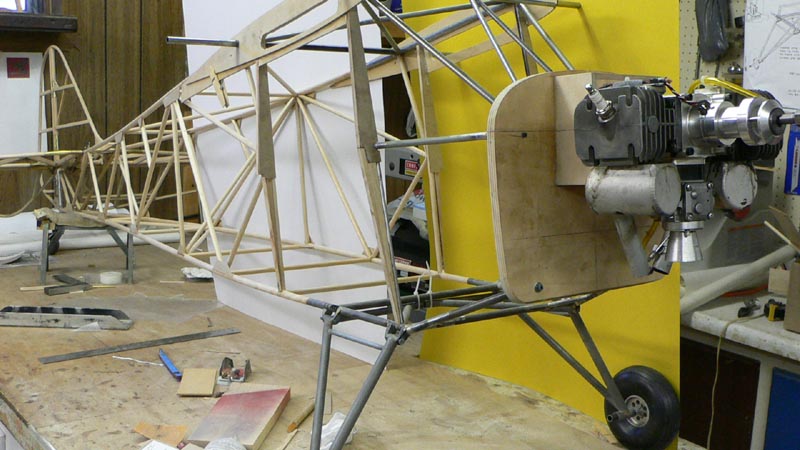

Hello There:
This My 1/3 Taylor-Craft Fuse. done with 3/8 Dowel Front done with 4130 steel tubing.
Very strong and lite used Cyno for all joints.

Your Taylor-craft fuselage is very inspiring! I'm off to the store to pick up some doweling (both traditional and bamboo) for some experiments!

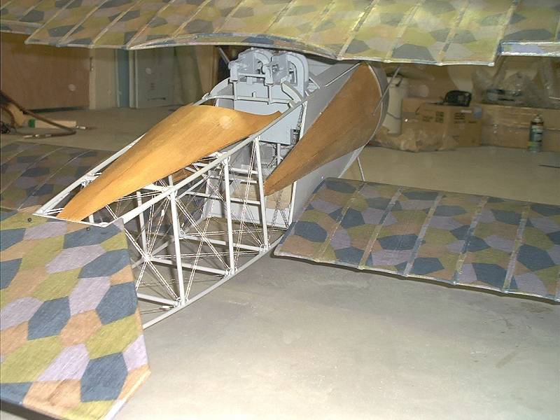

Dowel construction is neat, I like it. Proctor's E-III is built with 5/16" dowel as Don mentioned, and a small 5-point brass fitting is pinned between the joint. Cables are then installed, and the structure gets very rigid.

Wow, I had no idea that Ramin was an endangered spieces!! It is commonly used in kite making, and that's where I usually get mine. Don, will be hard to describe the 5-point fitting, but would be very easy to see how it works IF I had a picture for you. Imagine a junction at the longeron, crossmember, and upright. 4 wires would be there, and a fifth would be your internal cross wire. Yes, the Proctor E-III does use these internal cross wires, very strong structure when completed, perhaps overbuilt.

Hi Don. Here's a picture that might help.
Steve
Old 11-06-2008 | 11:26 PM
abufletcher's Avatar
Joined: Feb 2004
Posts: 15,019
From: Zentsuji, JAPAN
Default RE: Dowel construction?
Thanks for the photo, Steve. I hadn't been thinking that there were wires making diagonals through each "cube" of the structure. That's an awful lot of wires! At the size I'm working with (1/6 scale) I don't think I'll try actual fittings. I like the idea (from someone here on RCU) of using kevlar cables except that kevlar isn't available here. I'm not shooting for the level of (internal) detail on Dave's DVII.
