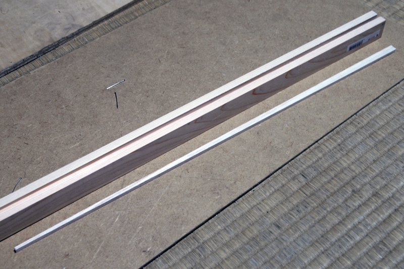

Does someone have a neat trick or (homemade) tool for cutting diagonally through thicker balsa (say 4-6mm)? I'd like to be able to cut tapered balsa spars (for why, see my DrI thread) but I'm not having much luck cutting them square with my exacto knife. I always seem to end up cutting at a slight angle. And trying to sand them level with a sanding bar after cutting is next to impossible.
So imagine this situation. I need to make a balsa spar that tapers from about 3/8" down to 1/8" over a distance of about 20 inches. The taper is only on one side of the spar (thus forming a greatly elongated right triangle). It's critical that all the sides be square all along the spar. And I need to be able to make four absolutely identically tapering spars.
Any ideas?

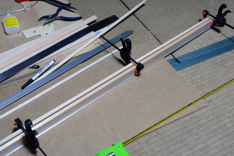

Ah! One problem with the laminated spar idea: I need a straight surface rather than a "step" because this side will get a 1/64 ply cover. I could probably make up a "sandwich" of some kind which would hold the spar stock and let me sand down to the edges of the jig. A couple of flat bars of aluminum and some bolts ought to do the trick.
Since I'd need 24 of these tapering spars on the DrI box spars, making up a jig would be worth the effort.

I appreciate all the suggestions everyone had and they definitely got me thinking. I ended up making jig that allowed me to sand the cut balsa spars to a uniform taper. Mission accomplished!
