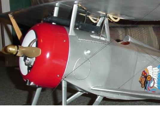

On this VK Nieuport I use a .56 saito with a recessed firewall glued to the rear of the forward Cabain struts. I mounted the engine inverted and put the servo for the throttle as well as the battery forward of the firewall. The .56 is overkill but I am swinging a 13x5 wood prop and when these photos were taken I only had to use a brass spinner weight to get the CG in specs. She jumps off the ground with plenty of rudder control and climbs like a rocket. Most of the flight is at 1/2 throttle. I was worried about the 4 cycle running inverted but have never had a problem with the Saito cutting out. I use 15% nitro with a OS F type plug. I just set it up for a good idle on the bench and then mounted it inverted. No problems since then.

A floating 3 point full stall landing is the way to go. If you glide it in it will be on its back nine out of 10 times as you have the gear under your cg and the weight up high.
Once you fly the Nieuport You will be hooked on VK kits
I have since gotten another one and plan to use Model Aviation Magazine plans avialable from 1980 to convert the kit to a Nieuport 24 bis. I also have a Camel and the 1 and 1/2 Strutter
