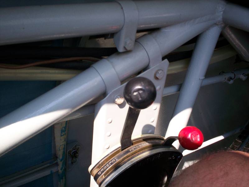

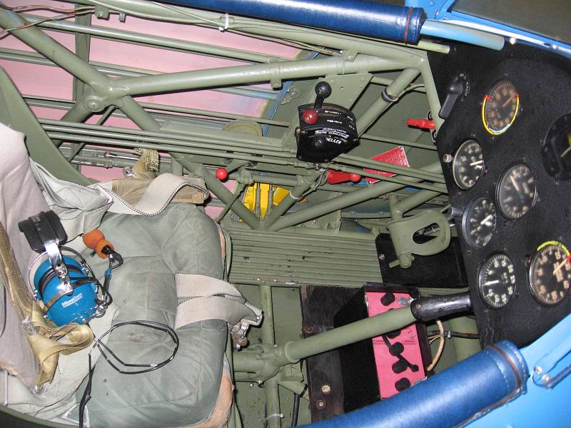

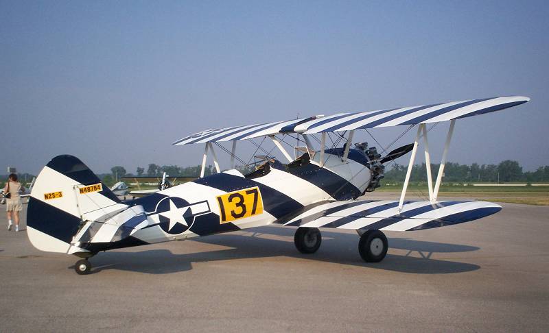

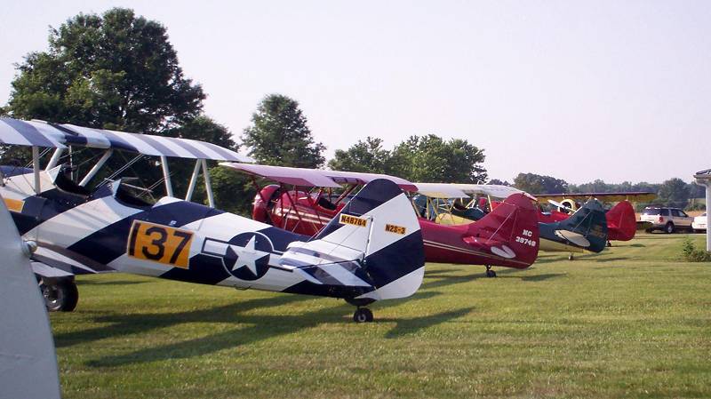

The fuel gauge glass is roughly 3/4" diameter and about 8" long. The knobs on the throttle quadrant are about 2" for the throttle and about 1-1/2" for the mixture. These are guesstimates based on comparing them to nearby items like wing tapes and fuselage tubing. It's been about a year and a half since I rode in the blue/white one, with the "Recall" one on our wing, over downtown St. Louis.
Jim, you're from Il? The pic of the Stearman parked in the grass is at a grass field in Belleville, east of St. Louis.

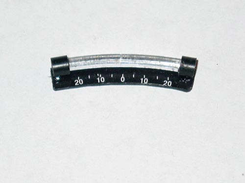

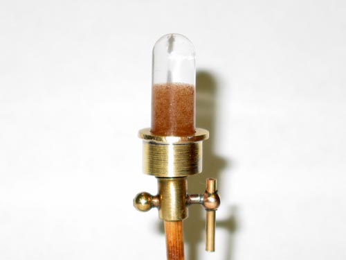

Jim I have a way of making glass rods from resin if you're interested. Here's a sample of something from my Camel build.

How did you make the parts out of resin? I could cast the fuel gauge out of epoxy but my epoxy is yellow color. I could order some glass tube from Small Parts. Let me know how you did it.
Jim

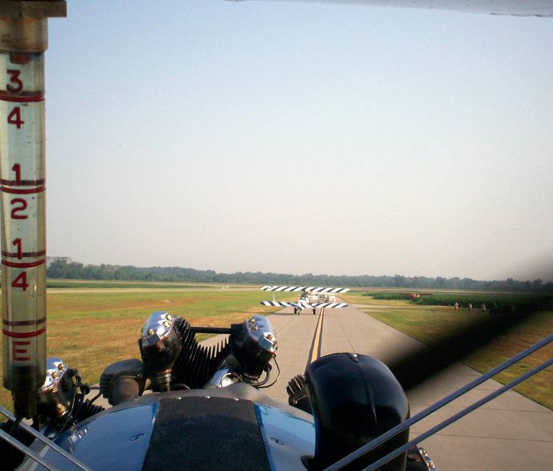

I actually live in western NC. I was at the American WACO Club fly-in in St. Louis (Creve Coeur Airport) in July 2007. There were a bunch of Stearmans there also. I have a few more Stearman pics if you're interested. Here's another of the rear-view mirror and fairing from the front, like Thrushdust mentioned. On Saturday, there was a fly-out from CCA to a residential airpark in Belleville where one of the WACO owners lived. It was awesome flying over downtown St. Louis. We had to stay below Class B airspace so we were at about 1200 feet. There were radio towers to our south that were higher than we were.

Jim I used a product called Cast'n craft, Clear casting resin. It's available at Michaels crafts.
The IMPORTANT part is finding a suitable tube or shape to cast your parts in. For the domed shaped part I used a pill capsule of the right size. I used a syringe body for the bank indicator. You need something that you can pour the resin into and then you can either push it out or destroy it. That way you'll have a smooth outside wall on your part. Other wise the resin won't be smooth.
For what you want you could use a plastic drinking straw or similar object.
Give it a try, its easy and you'll have exactly what you need.

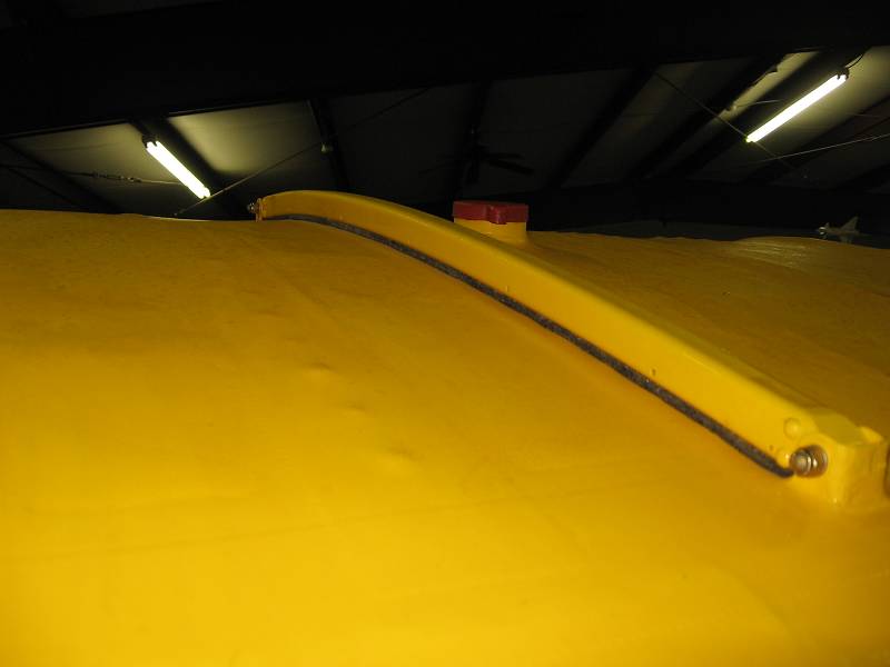

Thanks, that would be great. I am also interested in the rib that runs down the center of the top wing center section. how tall is it and what is it for?

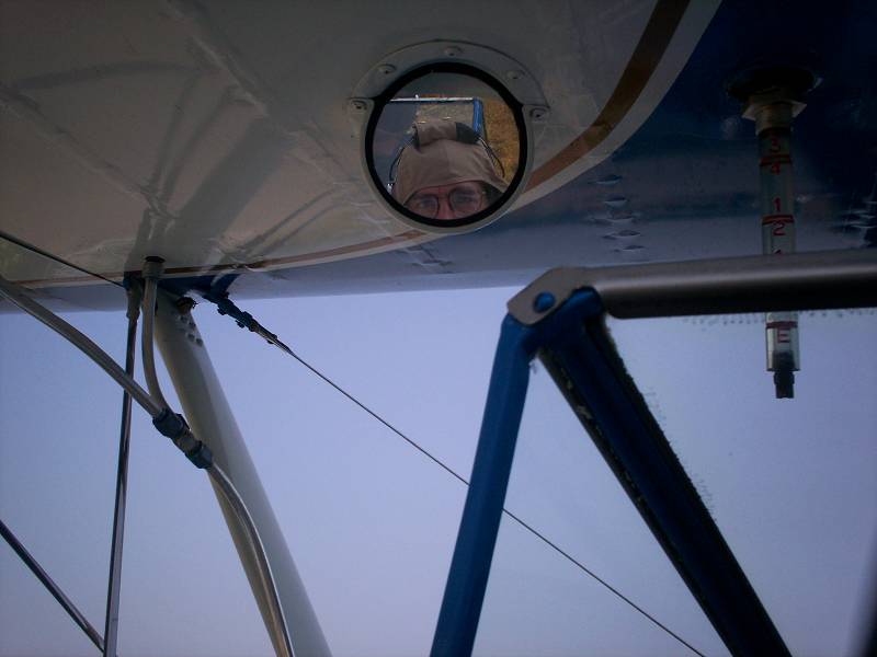

Old 02-26-2009 | 04:57 PM
Posts: 1,677
From: Olathe, KS
Default RE: Stearman
Jim,

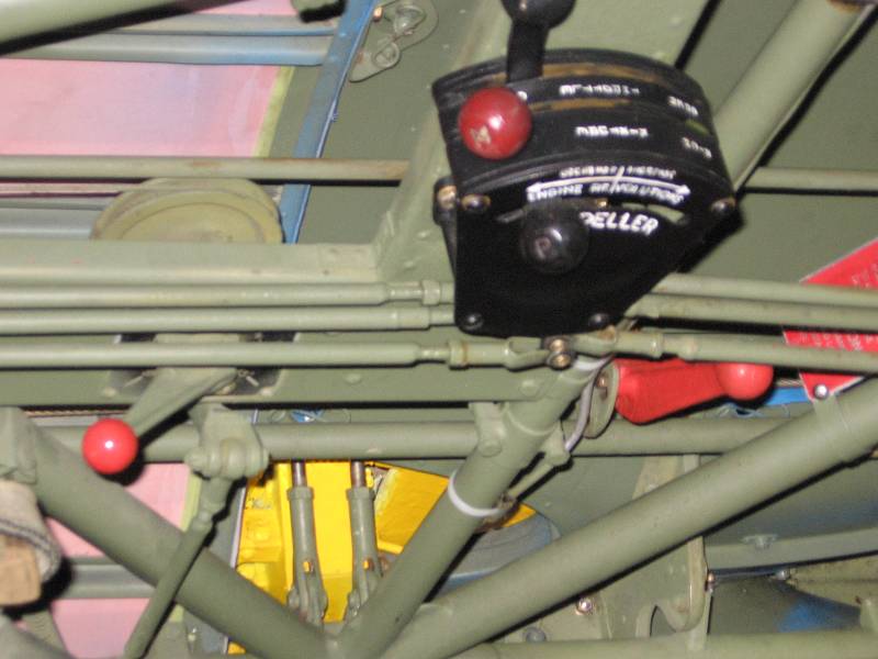

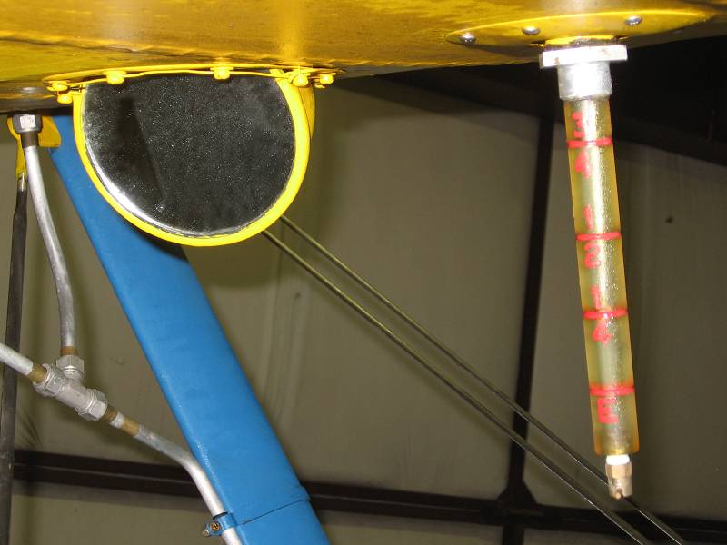

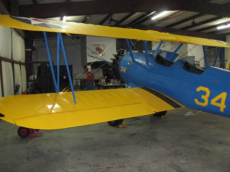

I just returned from the hangar. Here are the photos and measurements. BTW, the round thing under the top wing is the mirror used by the instructor to view the horror on the face of the student. The fuel guage is a clear tube hanging vertically. You can see them both in the photos. The face of the mirror is 4 3/4" diameter with a metal ring around it that has a a 5 1/4" O/D. the ring is about 3/32" thick. The morror housing is cone/bullet shaped like an old 30/40's headlight bucket. It is 5 1/2" deep from front to back. The fuel guage is a clear tube 6 1/2" in length and about 3/4" diameter. It goes into a plug about 1" from top to bottom. The throttle knob is about 1 1/4" in diameter. The ridge is actually a removable curved square piece of channel that is 1" square on top of the wing that is bolted to two square mounts. This appears to be a support for the fuel tank that is in the center of the upper wing. I do hope all this helps out.

The support bar on top of the wing was originally there to help hold the fuel tank in place. The tank bay was open and after it was discovered that rain water was collecting in the center sections and rotting them....an AD was issued to cover the section. One of the very few AD's ever issued for the Stearman airframe. It is built like a tank.
