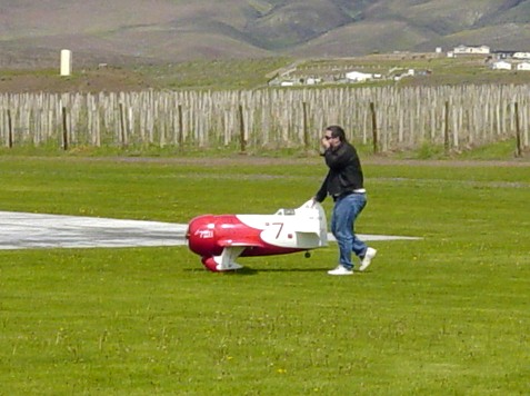

I think if its your plane, and you want to do tail touches with it, go for it! Its yours do what you want. I have seen the fiberclassics go, its pretty sweet!!

someone is offering me a Gee Bee that is about the size of the on in the picture. Should I take him up on it?
