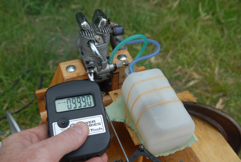

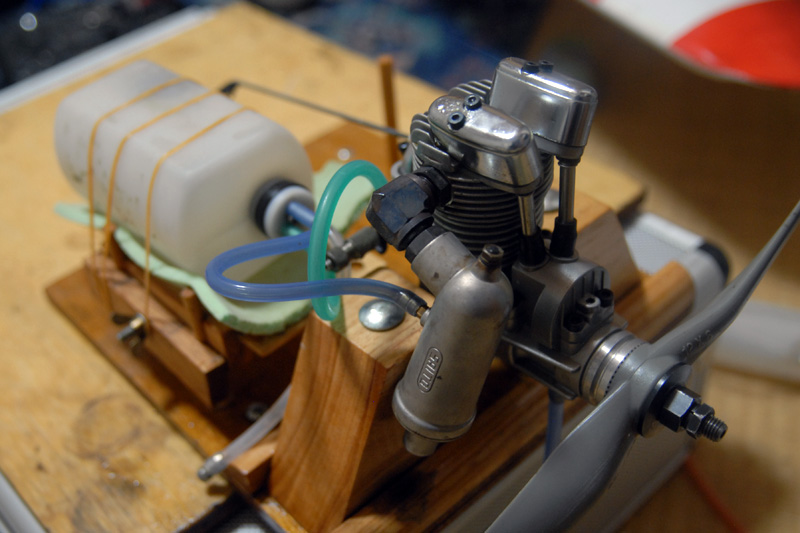

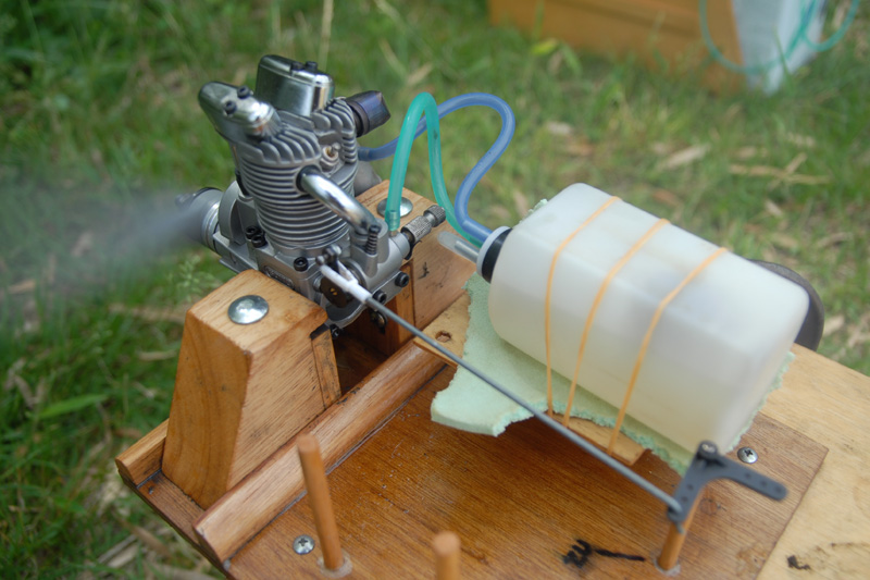

And the result was that that the engine seems to run perfectly with the same tank and plumbing combination used in the model. I even tried moving the tank up and down relative to the carb during the run and encountered no problems. No overheating problems, no smoke after the run, and the engine was cool to the touch a couple of minutes after the run. In short it performed perfectly.
So what does this all mean?

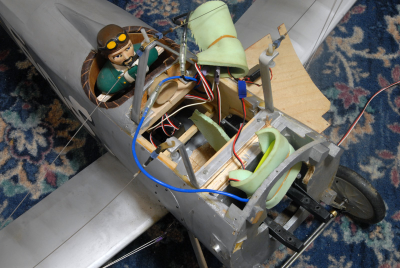

Upon inspecting the model, here's what I think. It appears that there many have been a constriction on the fuel tank tubes as they passed through the hole in the firewall. Minor shifting then starved the engine for fuel. So I enlarged the hole, reinstalled everything and will give it another shot. If this isn't it, I'm all out of solutions.
I also added a guide tube for the driver that I use to adjust the hex bolt in the end of the needle valve. I had one already but it was too big and the driver couldn't find the nut when the engine was running. Doing it this way is more of a hassle than just having a wire extension (or the old trick of using a small allen wrench) but I wanted to try this out since that's what I'm doing on my more serious scale models, where it's not ok to have a wire sticking out the side of the model.
Of course, there's not gurantee that this is the problem on the Puppeteer as well, but it at least gives me a place to look.

Now that I know what to look for, I inspected the fuel lines on the Puppeteer and found what I believe is the problem. The Puppeteer is constructed differently from the Legionnaire with no hole in the firewall. Rather the engine tank bay is open to the engine area. So it wasn't a constriction of the tubes passing through the firewall. Instead it looks like the fuel line got "kinked" like a garden hose and thus the same ultimate effect as on the Legionnaire. By clipping off a 1/2 inch of tubing made this unlikely to happen again.
Odd that such similar problems would crop up on two models at the same time. Probably speaks to poor plumbing skills.
