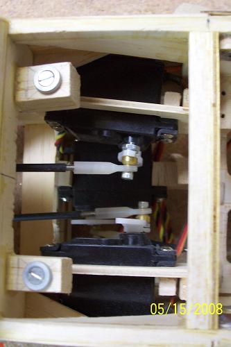

The problem with connection at the servo end is this: because the interior of the 1/6 scale camel was very congested I could not align the servos appropriately to run pull-pull cables directly off the servo arms unless I put at least one of the servos pretty far back in the fuselage, where it would not be easily accessible for adjustment anyhow.
So I used a method that is sometimes used in larger models - the pull-pull cables are run around spools which are driven by short pushrods from the servos. The spools are positioned to allow symmetrical pull-pull cables for the rudder, and reasonably even cables for the elevator, but they are behind the hatch region where the servos are.

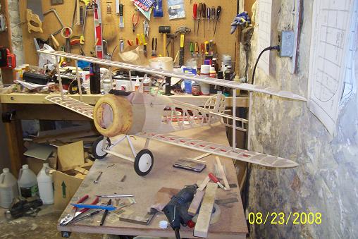

Default RE: Shorter clevis for pull-pull?
In the pix I posted you can see the spools and the cramped servo compartment. The rudder and elevator servos are mounted sideways, and beneath them you can see the aileron servo (a Hitech high-torque model) which drives all four ailerons via another spool. The ailerons are in a closed loop just like the full-scale Camel.
If you want to see the complete build saga, I have a "vanity web site" at [link=http://www.mts.net/~mhultin]Phil's Airplane Pages[/link] and the Camel is In My Workshop. Follow the links.
I am just finishing the painting, only have two more roundels to do on the upper wing and then clear-coat for the whole plane. Then its assembly and rigging.
Frankly, now that I have got this far I would not use this servo-driven spool method again. I just needed to modify my plans to make a longer fuselage hatch so that I could place the servos more appropriately, but I didn't realize that when I built the fuselage.

It may not be the most convenient installation, but you can be proud of your solution! In fact, thanks for posting those photos as I may need to do something like that on one of my builds. It's always good to try something new and different.

The one nice thing about the capstan (thanks TFF) method is that I was able to maximize the servo travel and the leverage. The diameter of the capstans matches the spread of the control horns, but the location of the pushrod and its position on the servo were chosen to produce the desired maximum control surface throw at nearly the maximum travel of the servo. It also ensures that there is no slack on the cables because they pay out exactly in proportion to the travel.

I checked out your build pages and it looks very good. Excellent work on the cowl. It does look like you might need significant weight up front though so best to plan for it now.

I figured I could screw lead plates onto the firewall if necessary, but in fact my initial check of the balance point on the uncovered airframe didn't seem like it was that tail heavy - if anything it might even be a big nose-heavy. With all the servos, fuel, battery, receiver etc. forward of the lower wing T.E. (i.e. no more than 9 inches back from the CG which should be near the lower wing L.E.) the tail isn't all that heavy.
Still, we shall see now that it is covered and painted.
