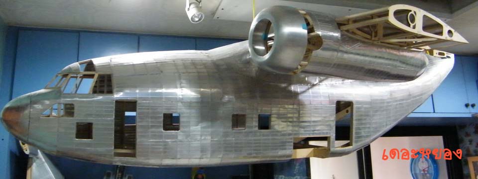

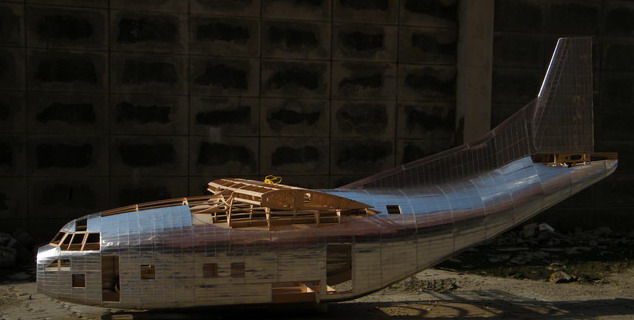

my project...nextyear finish
1/10 scale
aluminuim sheet skin

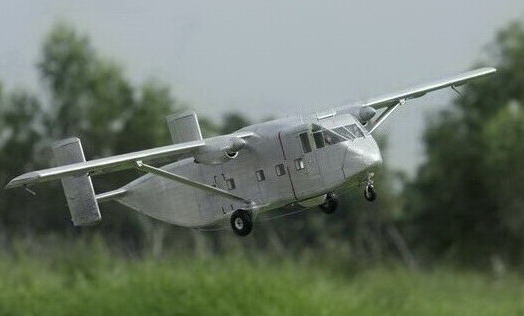

last year ....... same project to fly
short skyvan sc-7

Fabulous work, please keep us informed on your progress. What weight and engines do you expect to use?
My own research found a wing angle of attack of about 7 degrees, which I could hardly believe. It appears that you have the correct airfoil and angle of attack. Do you agree on 7 degrees?

....short and c-123 design by myself short 1/8 scale wing span :90" weight : 5.8 kg
motor towerpro 670 kv prop 13*8 lipo 4s2p.
c-123 provider...i think weight 8-10 Kg my design wing span :120" and design fro electric
airfoil 3418 nacaprofile angle of attack 3 degrees
all yuo see my story from thailand and in structure from c-123 provider ...this link http://www.rcthai.net/forum/showthread.php?t=224684

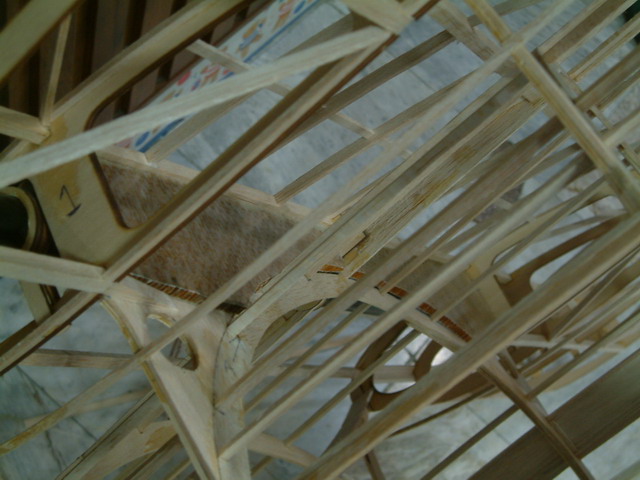

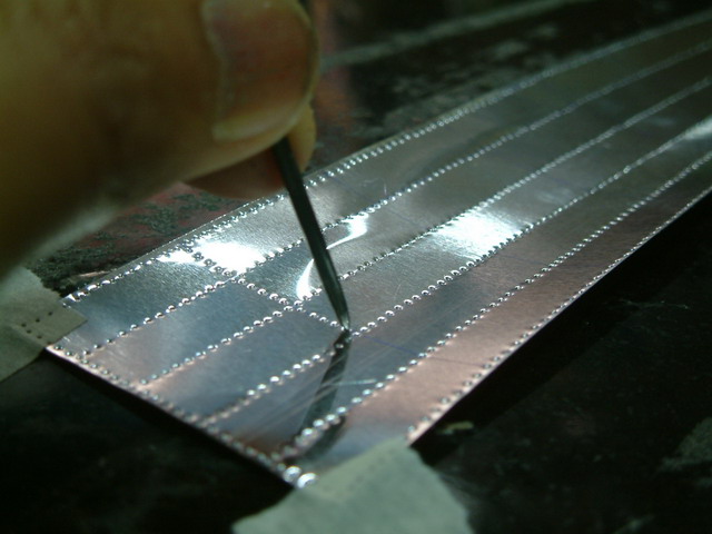

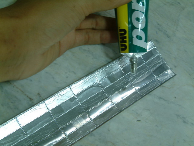

yes... i mixing... balsa structure and plywood mixing fiberglass ...... skin aluminium sheet fix by UHU pol
more pic. http://www.rcthai.net/forum/showthread.php?t=224684

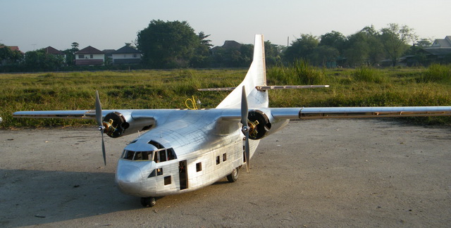

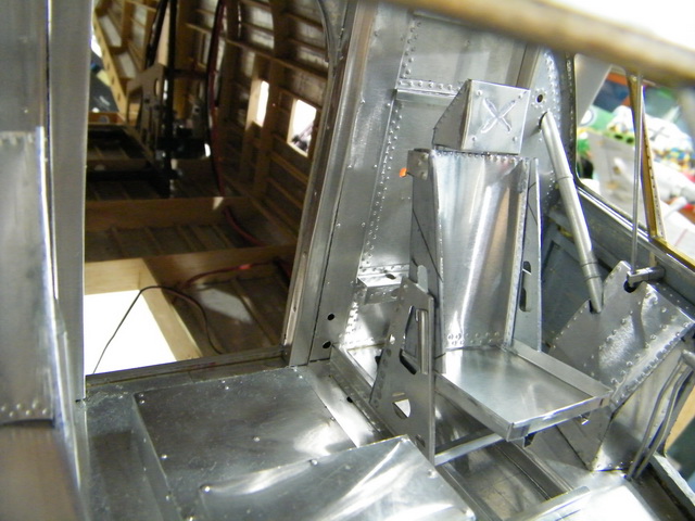

now...today
c-123 provider
thanks

How thick is the aluminum that you are using? What kind of aluminum sheeting are you using?

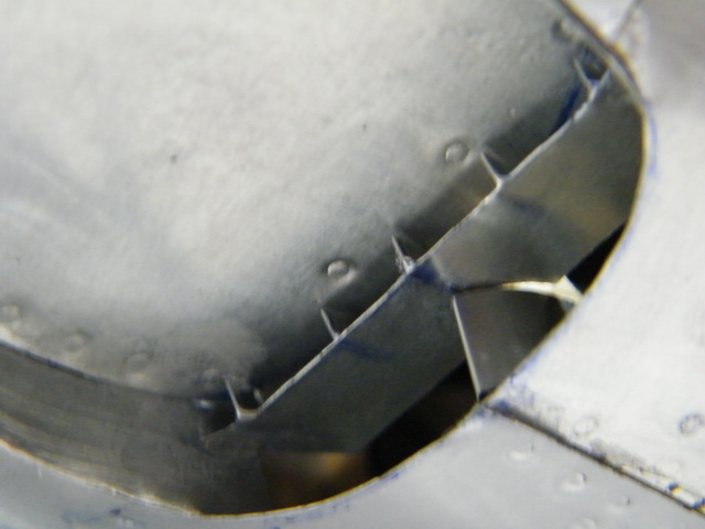

Old 09-08-2009 | 07:05 AM
THE.YONK's Avatar
Joined: May 2009
Posts: 9
From: , THAILAND
Default RE: Scratch-built C-123 provider
aluminium sheet thickess 0.2 mm ... aluminium sheet for added to the interior work in thailand

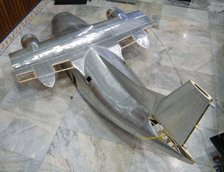

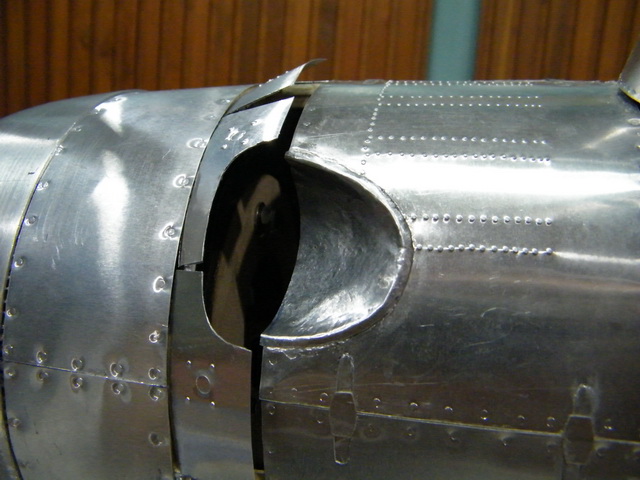

now...skint work 90% and interior work 60 %

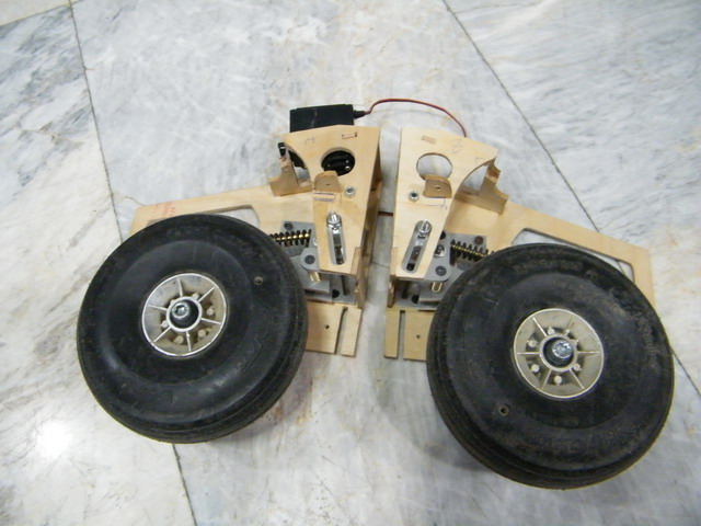

main gear
[youtube]http://www.youtube.com/watch?v=K17MlgPmCo8[/youtube]
[youtube]http://www.youtube.com/watch?v=Ubbhj5gaMr4&feature=related[/youtube]

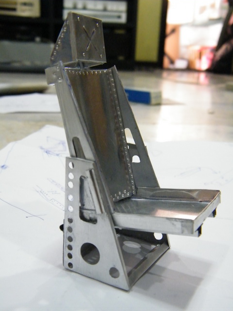

chair
[youtube]http://www.youtube.com/watch?v=J2nHjer08RI[/youtube]

Old 03-13-2010 | 06:36 PM
Joined: Aug 2005
Posts: 4,196
From: Mississauga, ON, CANADA
Just Dynamite work!!!, your aluminum to wood trick is great, i didn't knew UHU would be good enough for this kind of job!. Keep it uo, i'll be watching with great interest...
