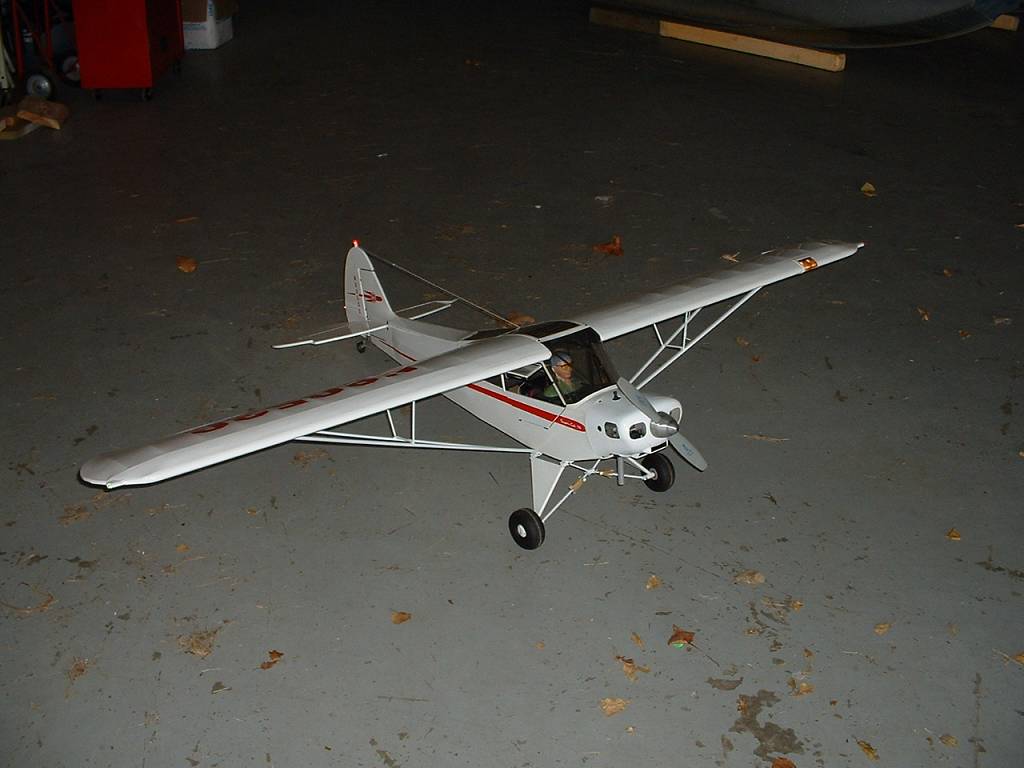

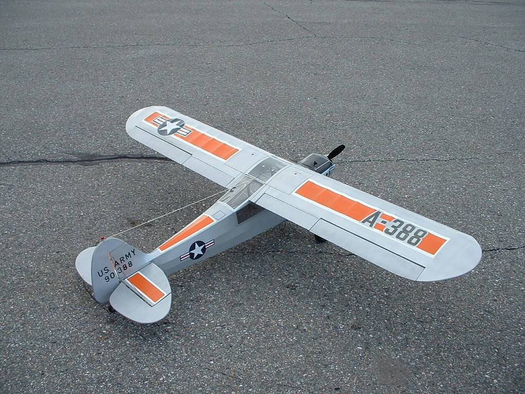

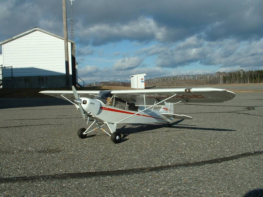

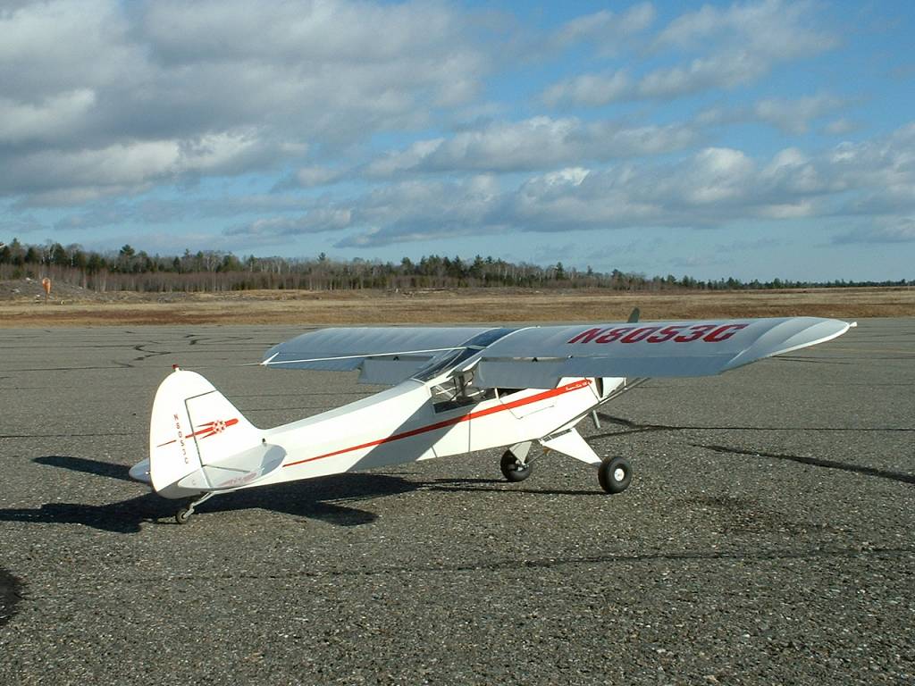

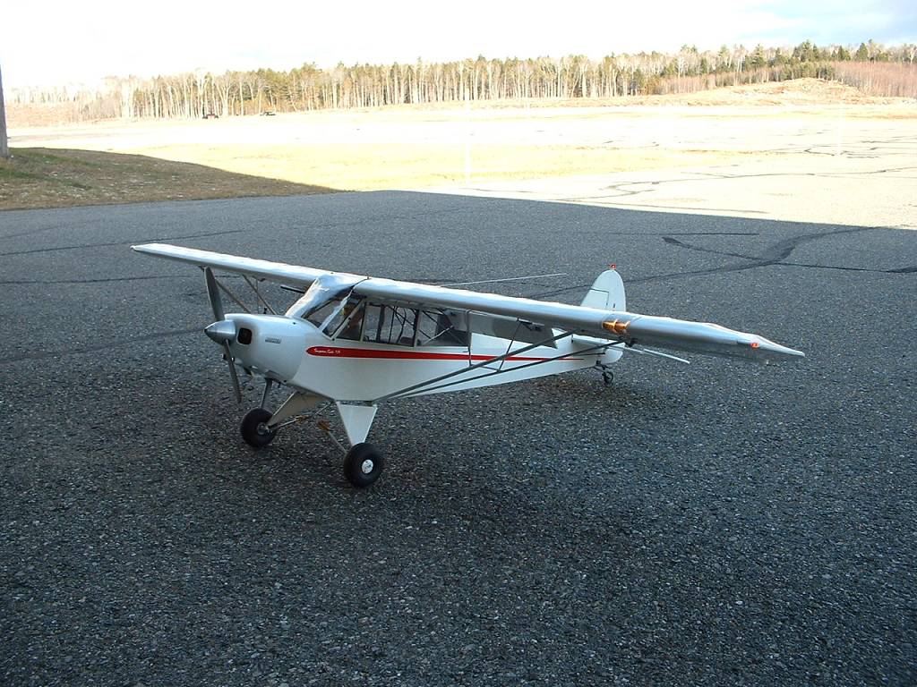

Super Cub conversions can be a lot of fun. I started with a 40 size Great Planes J-3, a 3 view, and some pictures about 15 years ago as a winter project. I wanted a Military Super Cub, the L-21B. Not only did the cowl, tail, and wings need to change, I wanted the greenhouse glass, working nav and landing lights, and an operating door. As I studied the drawings it became clear that the cowling, boot cowl, firewall windshield, rudder, elevators,and horizontal stab would be changed. The more I looked, the more I found. It ended up being a most enjoyable challenge with decent results. The following pictures are of the finished product. The first one shows it in its first color scheme which I flew for about ten years. When it needed an ovehaul I recovered it in a civilian scheme for something different. It has been powered with the same magnum 52 fourstroke for about 13 years. The first two years it had an OS 48 fourstroke. Good luck with your conversion. I have a 22 year old Balsa USA 1/4 cub that I fly on wheels, skis and floats and just love it. Jeff

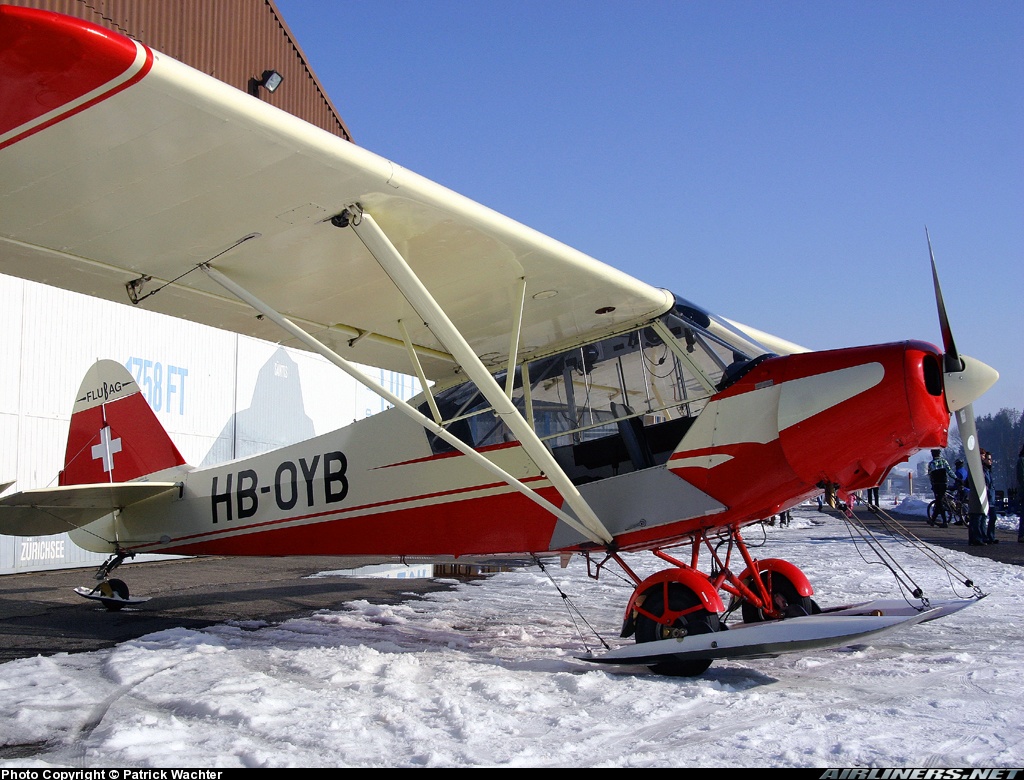

Joined: Apr 2005
Posts: 6
From: windham, NH
Default RE: Converting a J3 To a Super Cub
Great pictures of your super cub, man all that glass is a callenge for me but will do my best.

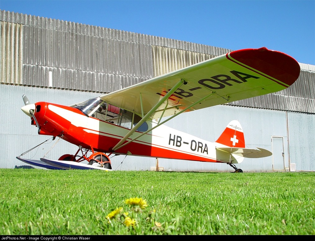

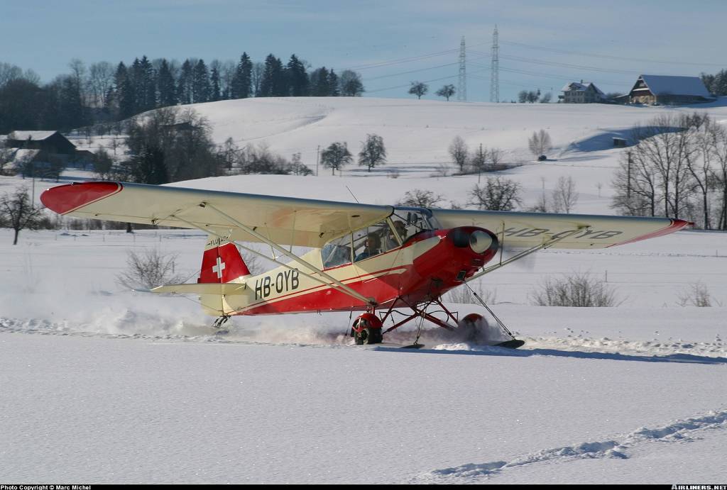

I may have found the plane I will model mine after, built in 1952.
ID:	1325611   Click image for larger version
ID:	1325612   Click image for larger version
Old 12-03-2009 | 12:18 AM
Joined: Apr 2005
Posts: 6
From: windham, NH
Interesting that I noticed the plane Im considering is HB-OYB.
The middel one is from the same people but has the round window.
Located in Switzerland.
Here are a few more shots.... be sure to enlarge them full screen Shes a buity!
William

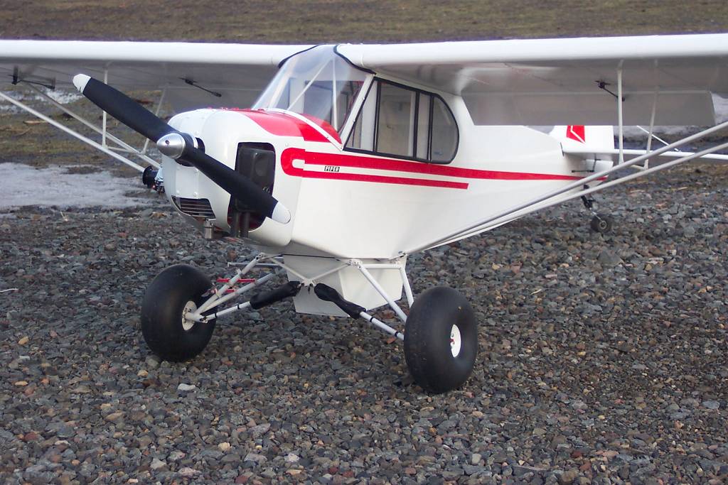

Joined: Mar 2008
Posts: 28
From: La Grande, OR

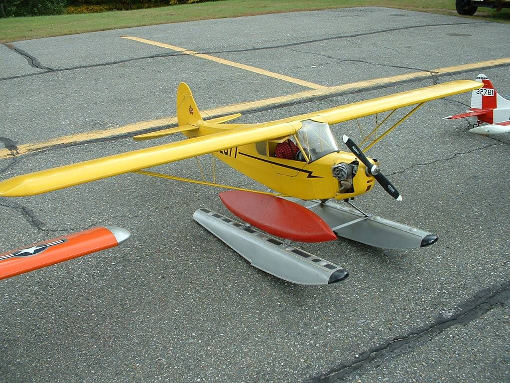

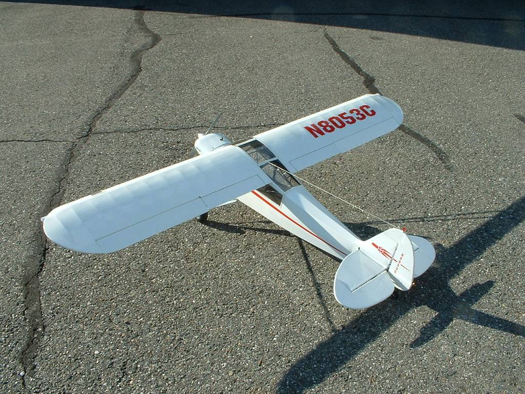

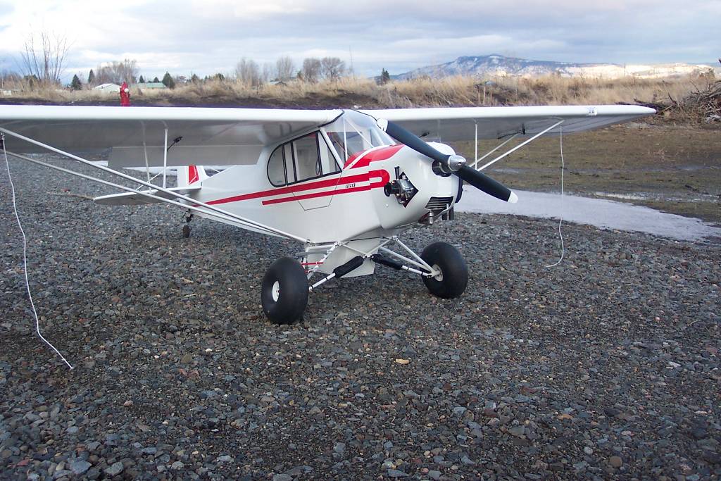

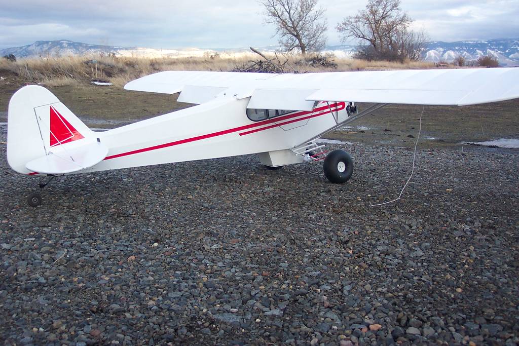

Saltydog56 I started my project as a J3 but toward the end decided to go the super cub route. My cub is nowhere near being correct but i think it turned out ok. I'm still going to order a fiberglass specialties cowl to make it look a little more realistic. Good luck ....

mnoodle, Could you tell me if yours is a 1/4 scale ans where did you get those tires Khelsea

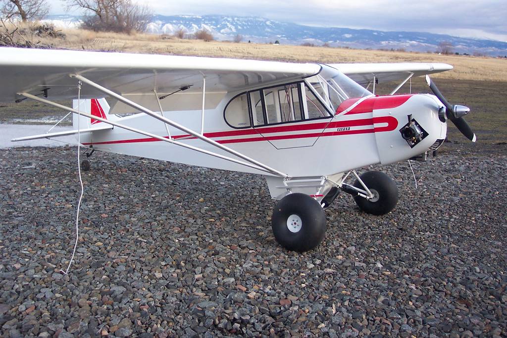

Old 01-07-2010 | 12:20 AM
Joined: Mar 2008
Posts: 28
From: La Grande, OR
Khelsea, my plane is a 1/4 scale sig kit. The tires are 6" dubro big wheels , i believe you can still get them from tower hobbies. I was looking for bigger tires but i guess this is the biggest you can get, so i inflated them to 7" and they still work great. Hope this helps
