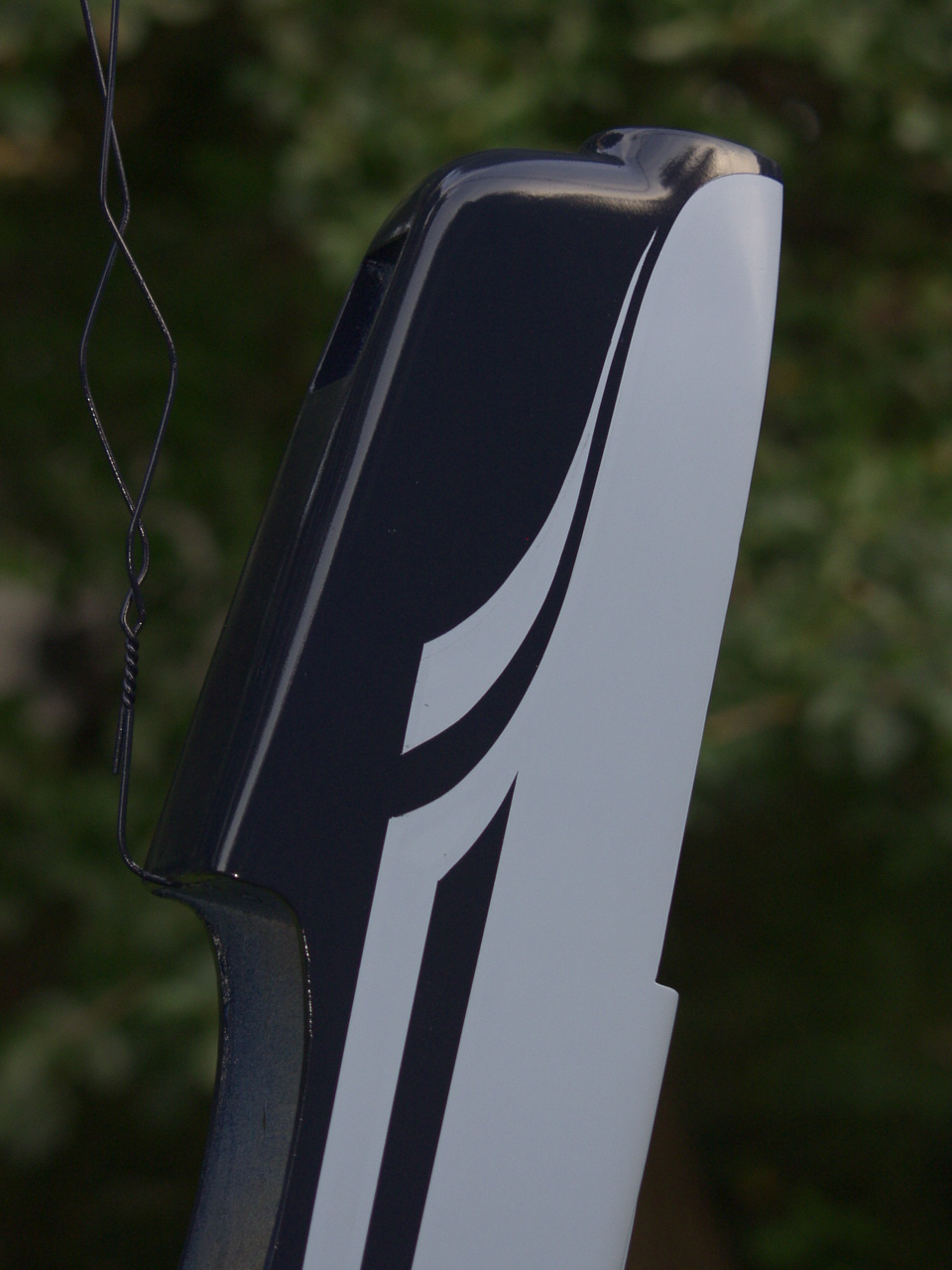

Just on sheeted areas. If you use water base polyurethane (WBPU), you should first apply a couple of coats to the bare wood first. Otherwise the balsa absorbs the WBPU very quickly. Using WBPU is quick and easy, no smell and water clean up. Here's a pic of the nose of my restored Perigee, 3/4 oz cloth and WBPU. It went around the curves like they weren't there.
FB

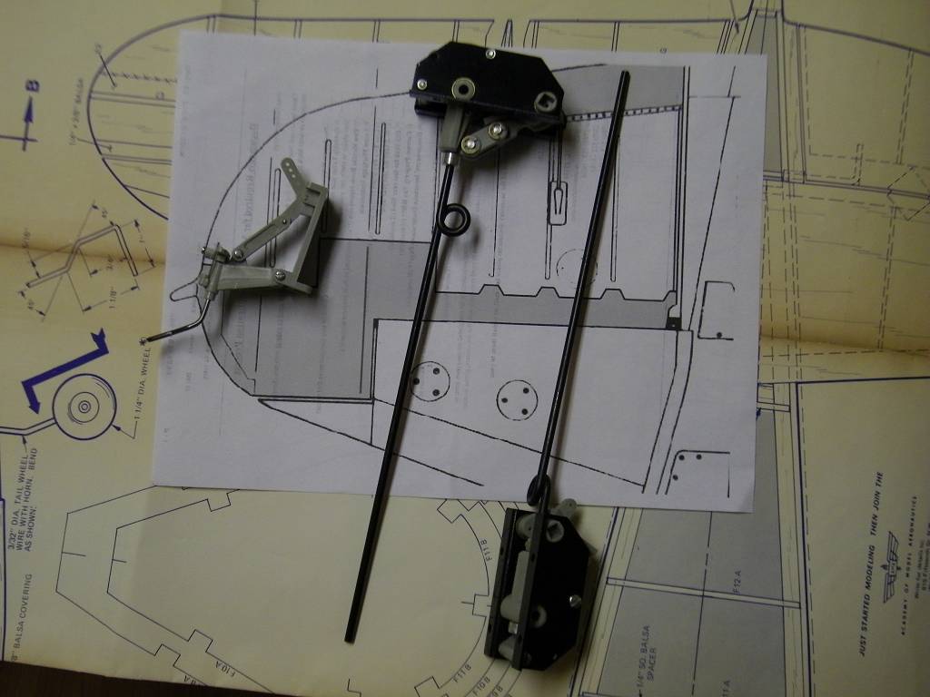

Tuff, Maybe these (pictured) with Robart robo struts and retractable tailwheel which are also Robart. These were part of my deal on the NIB kit.
Also, this is how I hope to have my finished Aircraft look when completed.
Tom
