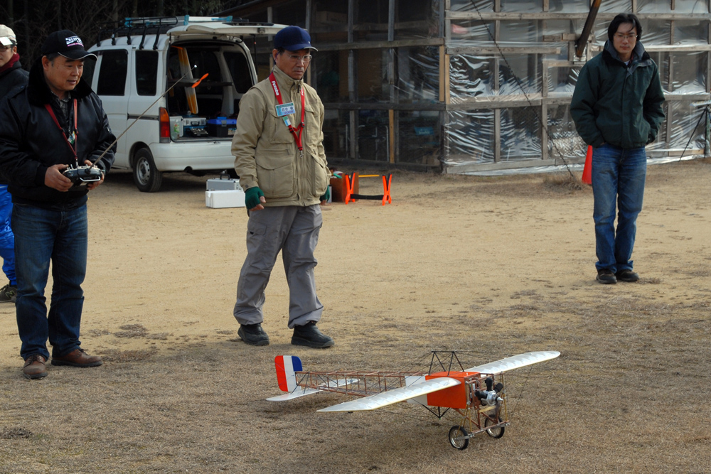

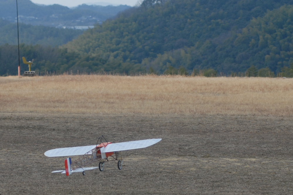

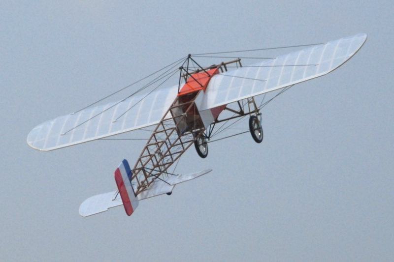

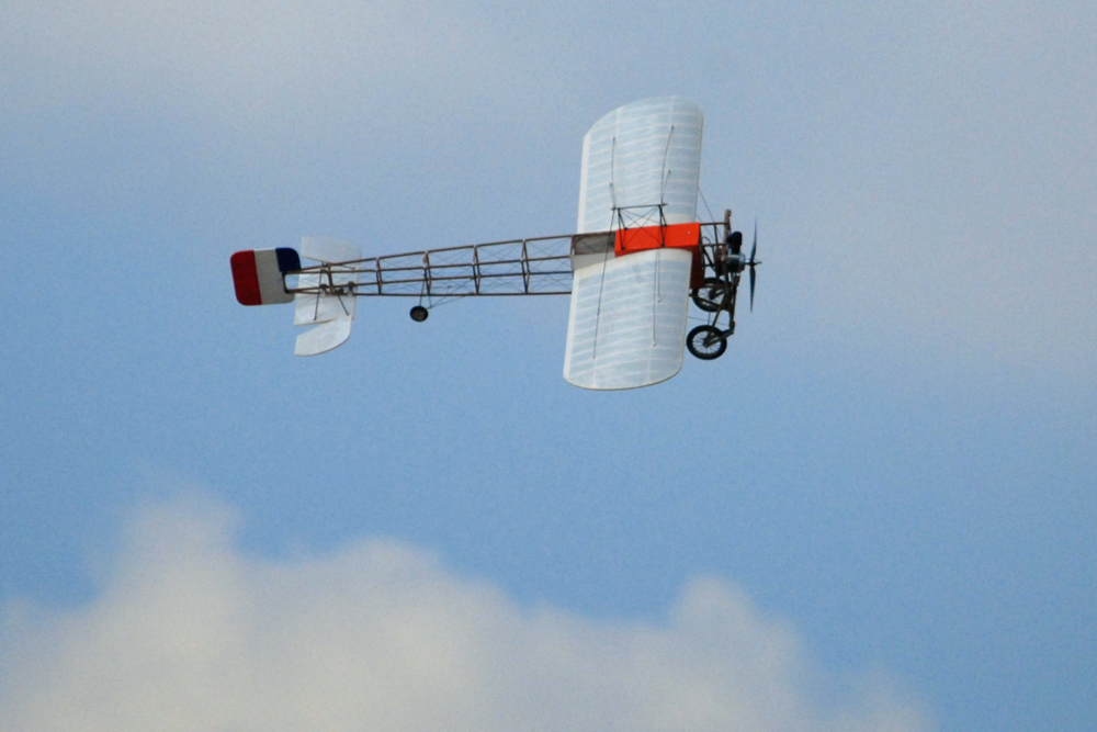

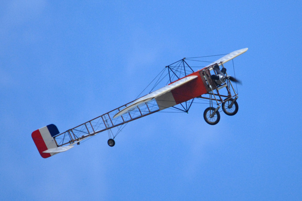

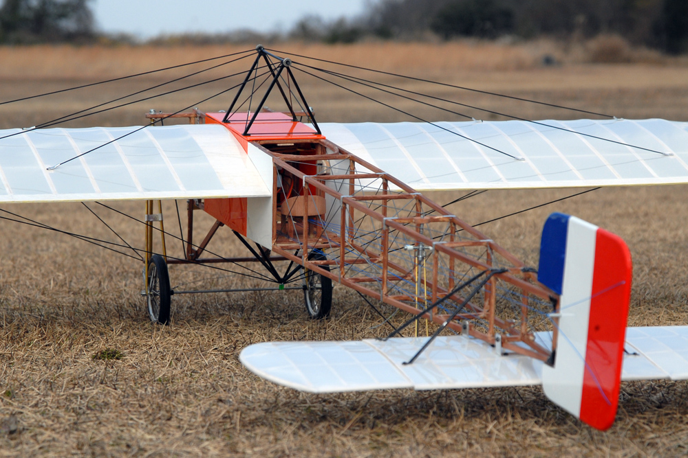

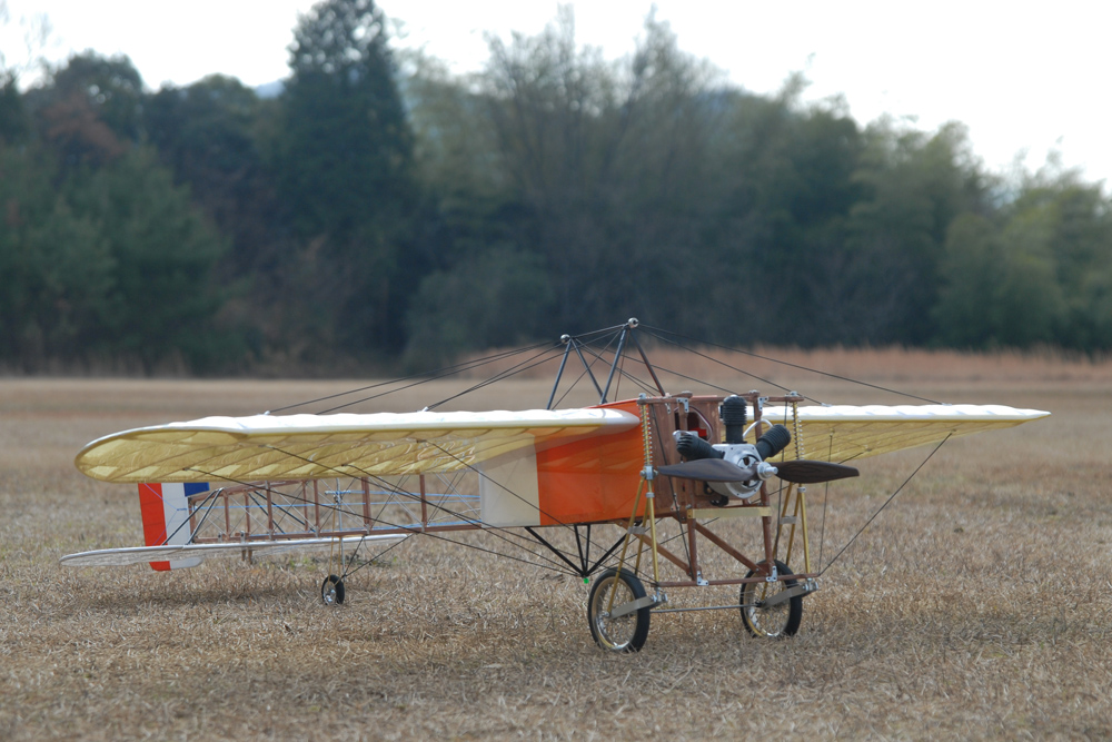

Looks like I might finally have a fellow scale builder at my field! Today, the same guy (Ikeda-san), who had scratch-built an EIII a while ago, had a scratch-built Bleriot to maiden! Based on 3-views from the internet he did some CAD drawings and built from those. I was particularly impressed with his solutions for the functional suspension. The model included rudder and elevon (?) control. No wing warping. On take-off, it climbed like crazy and the test pilot had a heck of a time bringing it back around with little yaw control, but did well to accomplish a rough landing that took off the undercarriage but left the rest of the model intact.
Anyone else got a Bleriot...or Bleriot photos to post?

That is a very interesting solution to control. Many of the little electric jets use that. It is actually called Ailevator or taileron. I had an F18 with that and I was actually able to do very quick rolls. It did feel different though.
Nice airplane.

What did he use? Again with the WW1, and climbing. I bet there was a rigging issue. Positive incidence in the wing.

Some monocoat-type covering in white and orange! As far as I know, Ikeda-san has only just begun to build scale and this model is a huge advance in both scale and complexity as compared with his EIII (which also used white and orange monocoat). In one of the photos above you can see him in the yellow/green down jacket in the far right corner.
The rigging is just elastic. But, if I understood him correctly, he said that mounted the wing at 2.5 degrees (whereas the original, he tells me, had 7 degrees). The model uses a fairly thick, slightly undercambered airfoil.
The total weight ready to fly was 1.3kg.

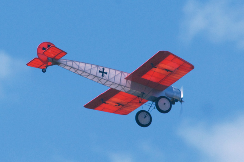

Here a shot of Ikeda-san's scratch-built EIII. It flew well, had a fairly scale shape, but if only he had covered it in solartex!

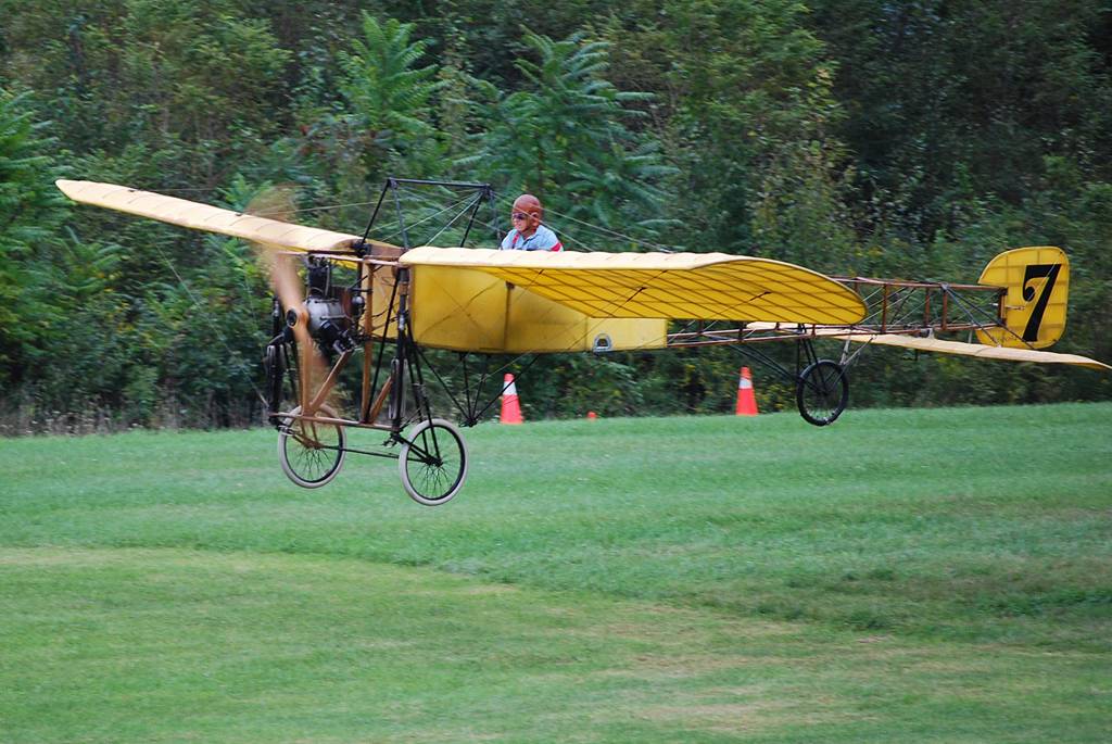

Great looking model. Thought you might like to see the 'real deal'. This is the worlds oldest, flying airplane, Bleriot XI, serial # 56. I took this shot at Old Rhinebeck Aerodrome Sept '09 at the annual R/C event. Enjoy.
Bob

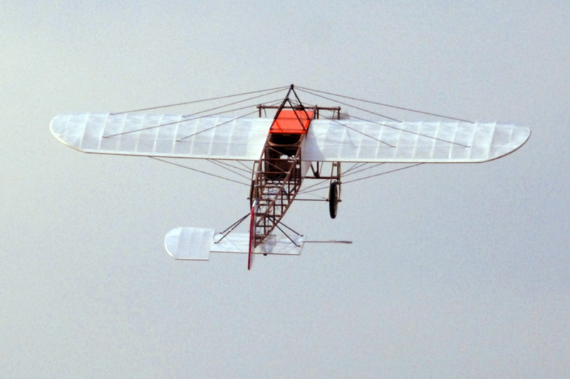

Lee, thanks for that information. Mr. Ikeda is wondering what went wrong with his model. It climbed far too much and was very difficult to turn. The balance seemed about right. I believe the wing incidence (for the non-scale undercambered airfoil) was set at 2.5 degrees. I don't know about the elevator. He was using an unusual set up on the elevator which VG was calling "ailevator" or "taileron" (as used on some small ducted fan jet models). It seems to me that a better setup would be to put the wings at either 1 or zero degrees and set the elevator up as a normal elevator and use rudder for turns. It looks like it has a good sized rudder.
What would you all recommend to Mr. Ikeda?

I believe the last version had a standard hinged elevator. http://www.theaerodrome.com/forum/re...ii-news-2.html
The wing looks a little flat; if he had a little more dihedral it would turn with the rudder without getting dangerous with the ailevators. The jets work well because the wingspan is so short; the long wings have too much leverage on the short tail. The real one turns pretty flat; rudder and elevator is the way to go.

I hadn't noticed that about the dihedral...and I think you're absolutely right. Setting it up as a standard 3-channel model is the way to go. He should be able to do this without making any major changes to the model.
As far as why it's climbing so severely I assume that's either because the incidence on the main wing 2.5 degrees) is too much for that airfoil or that he needs some (more?) downthrust on the engine.

I agree with the dihedral as well. the tailerons just will not have enough leverage for all of that span and area. Not only that, it is a constant chord wing which is not as easily rolled as the tapered variety of the little jets. Just adding dihedral might do it and then maybe mixing out most of the aileron on the stab. Using Rudder to mostly turn the aircraft. If it were me, I would put the rudder on the aileron stick, with slight amounts of taileron mixed with quantities figured through testing.
Also, I would lower the incidence of the wing, assuming the Stabilator was set properly in the first place. Also look at down thrust to keep from climbing. Maybe 2-3 degrees.

Mr. Ikeda's model is very neat! If he were to emulate the Royal kit and just have throttle, rudder and elevator as controls he would have a nice flying airplane on fairly calm days. He should build a wing warping version. He seems to have the building skills needed. Also, bigger flies better! Tailwinds, ARUP
