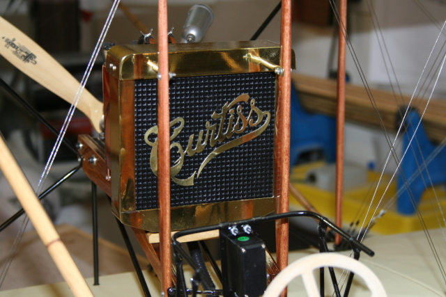

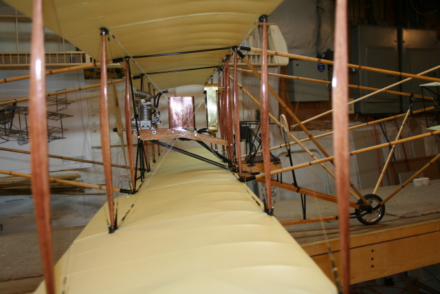

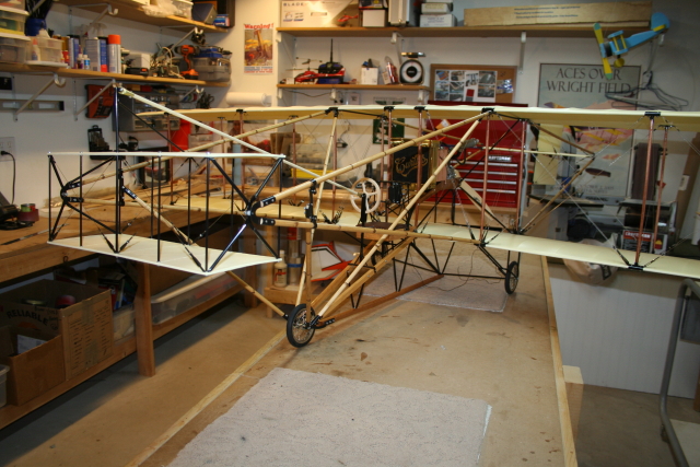

OHMYGOSH! Ican't believe Ifound this thread!!! Iam desperate!!!!!
Iwill try to make the story quick. For four years I have been working with the Glenn Curtiss museum on theirproject to build a full scale 1910 Curtiss Hudson Flier and my personal effort to build a 1/4 R/C model. The full scale flew in June (www.youtube.com/watch) and my model should be ready to fly in just a few week. Iplan to do flight testing in August and have the plan make its "official" debut at Rhinebeck in September.
Of all the work that went into the plane, Ihave no pilot!!! I have this cheesy guy that is the right size but he is all wrong for the subject. The head is wrong. The clothes are wrong. Is there anything that you can do to help me? The perfect pilot would be dressed in a white shirt, dark pants, possibly a jacket. Any resemblance to Curtiss would be a huge plus. A period hat would icing on the cake. (I have lotsof pictures of Curtiss at the controls.)
The pilot needs to be moveable. The steering yoke moves back and forth to move the elevators and the seat cradle racks side to side to operate the ailerons.
I'm sorry for barging right into this thread but I have searched as thoroughly as Iknow how for a pilot to buy but nothing has come close.
Any suggestions or assistance that you can provide would be extremely helpful and greatly appreciated.
Thanks in advance.

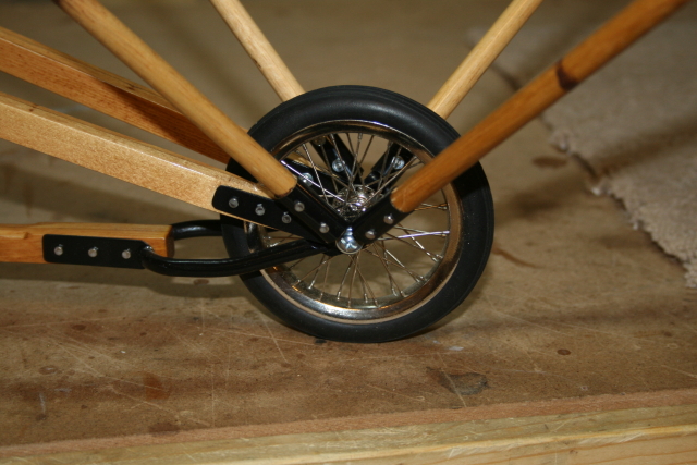

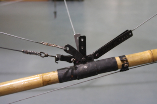

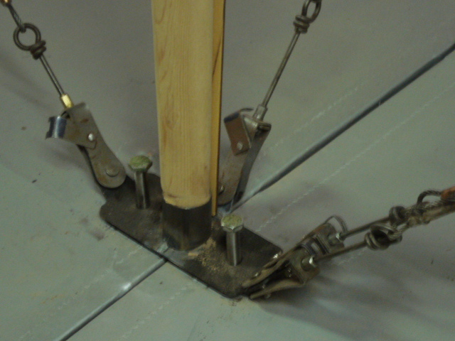

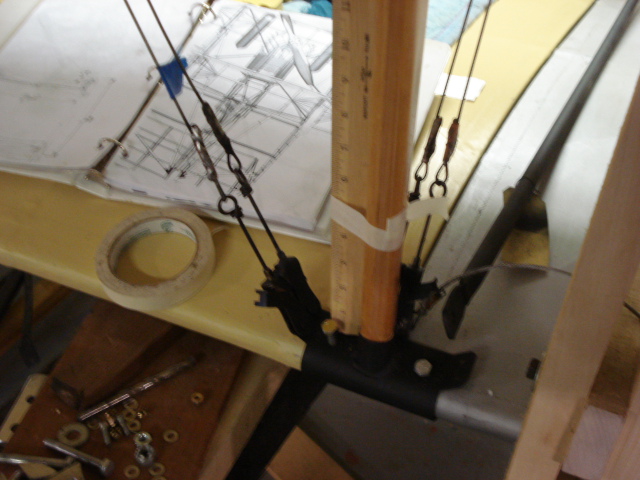

Thanks for the pilot suggestion and the comments on my plane.
I have agonized long and hard about the bracing wire approach. Ideally I would usewire attached at the ends with turn buckles but that really isn't to scale either. Turn buckles weren't invented for another two years!!!
The original (and the full scale) used a modified form of a bicycle spoke setup. (Pictures below). I designed a similar version for the model but that required using sections of 2-56 hex standoffs. It would have been closer to the original but not exactly and it would have been a much heavier method.
Although using modern parts, what I've done is actually close to the method originally used. The only other alternative is to what Ihave done is to go super original. That will require making threaded rods with bent ends and custom spoke adjusters with custom brackets.
I actually had the brackets made when I committed the order to waterjet cut the metal work. So Ihave about 200 brackets that can be bent and then rivited to the wing bracket tabs. The difficulty is making the adjuster and the "spoke rod" for lack of a better term. That would have taken considerably more time that I already put into this. I was hoping with this model, like the full scale, to have it ready for the May 29, 2010 100th anniversary of the flight of the original. Even with this short cut, Ididn't make that.
I might consider re-rigging the plane with more a more original approach over the winter if I can come up with a practical method that isn't too heavy. I'm open to ideas.

From what I can see in the pictures you have several components that need to be made separate. The first are the anchor brackets. I believe you have these made already. The second is the threaded rod. I think you can make this by using a threaded brass screw and then making the end from round stock. Solder these two together and add a nut at the bottom and you'll have the second part. The third part is the ends for the landing/flying wires. These can be crimped and soldered to some narrow flat stock. That'll give the appearence of the full size. Forthly you might want to make the "keeper" brackets that hold the adjustment nut in place. It's not necessary but it'll look good.

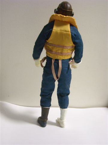

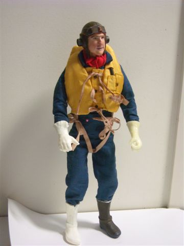

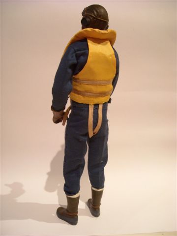

I've been working on the MaeWest and after decifering some old photos have come up with something far more convincing than my original efforts
The longer flared gloves are done but not painted as you can see, same with the new boots. Actually, I have new boots cut ready to mould and cast with better strap and zipper detail. All my good intentions of having this finished this weekend but things just take longer than I anticipate so not ready yet Brad [
] Still, we have progress.
cheers
Patti

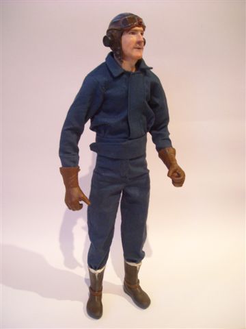

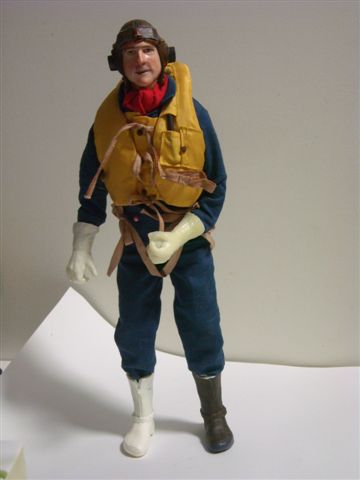

The boots and gloves are now cast and painted and I was assembling all the pieces to get ready to send when our gorgeous little puppy got hold of the right glove and chewed it up, then while I was examining the damage she managed to get the new body and has taken a chunk out of the bum [:@] She's still cute but was in fine form last night. I have recast the glove, ready to paint again and we'll pour another body on the weekend. I really will be finished then
Brad, I've filled in a little around the edges of your cheeks between the cap with dark which does give the effect of "thnning down" your cheeks a little. It's only a mm or so but can make such a difference. You could always say you'd been tucking into the ANZAC biscuit rations
It also looks different from different angles so hopefully when you get it in your hands it will be OK.
I've also had a play with a Glen Curtiss head and have attached the screen capture of the 3D model. It has been cut in wax and if it wasn't for the DOG, it would have been moulded last night as well! Still, I've got the weekend ahead.
cheers
Patti

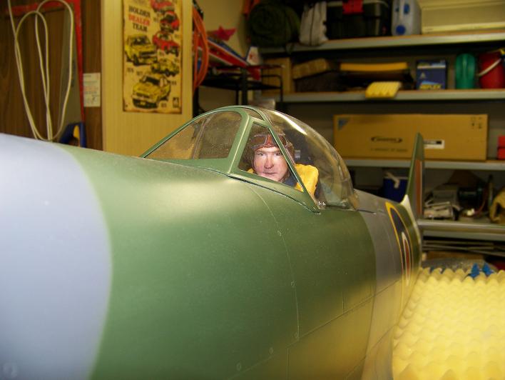

Well Brad, your Spitty pilot is FINALLY winging his way to you! It's been a journey and lucky you're a patient guy
I'm going to redo the uniform as that was a first draft and it always needs refining but it's a start, not the end!
Now that we've done the Spitfire goggles and made a good start on the RAF MaeWest and uniform I'd like to do a 1/4 scale pilot with a recognizable American face. There's Ben Affleck from Pearl Harbour but whenever I mention him I get groans of disgust because guys seem to hate the movie because of the soppie story line and apparent bad acting. However, in the movie he did fly a Spitfire, a P-40, a B-25 ....... and a Steerman too. So any other suggestions then for an American, Battle of Britain era pilot???
Here are a few pics of the 1/5 Brad Spitfire pilot in it's steps to creation.
Cheers
Patti

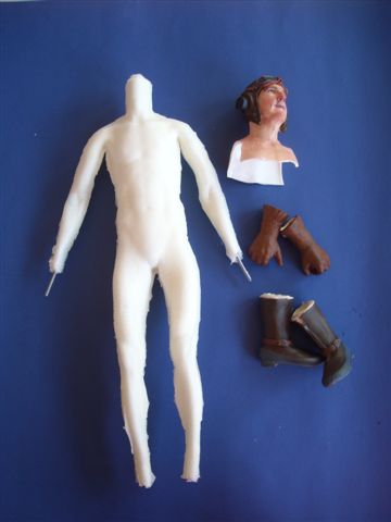

Now for the next project which is underway. A Glen Curtiss which has now been moulded and a very rough first casting done. I'm always so impatient to see the first results that I don't take enough care and I've ended up with a couple of air bubbles, but ignore that as it's a first go
We made this body with a cord through the arms instead of wire so that the hands can attach to the steering wheel and the arms will move with it. It seems to have plenty of easy movement but you could always nick the arm foam to allow more freedom of movement if you need it Bob.
We're making another 1/4 scale body mould as this one didn't fit well together - an early version and the seams are a little thick where the gap was. Since we had to recut the plug I decided to add a "little something" to make it more anatomically correct. It just looked wrong like it was [X(]. It's not overdone now and hopefully wont bother anyone. Did it bother anyone except me with nothing there?!
The boots and hands will be cut this week and I'll be starting on his suit asap. I have the material ready to go and am dying to get into it. It's always fun to start a new project and we're getting quicker at these heads so hopefully can start doing a variety. Here are a few pics of the start of Glenn Curtiss.
cheers
Patti

I'm going to redo the uniform as that was a first draft and it always needs refining but it's a start, not the end! Now that we've done the Spitfire goggles and made a good start on the RAF MaeWest and uniform I'd like to do a 1/4 scale pilot with a recognizable American face. There's Ben Affleck from Pearl Harbour but whenever I mention him I get groans of disgust because guys seem to hate the movie because of the soppie story line and apparent bad acting. However, in the movie he did fly a Spitfire, a P-40, a B-25 ....... and a Steerman too. So any other suggestions then for an American, Battle of Britain era pilot???
Cheers
Patti
The first of many I hope to be sent world wide. (not my head though
)I'll let you know when he arrives.
Cheers,
Brad
