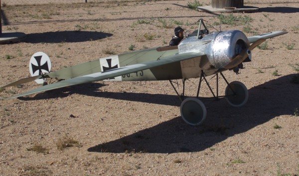

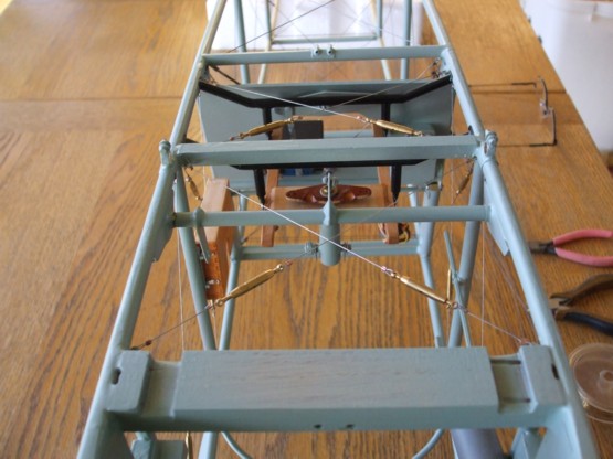

Proctor Eindecker, quarter scale, Moki 2.1 w/ 22-8 Master Airscrew scimitar, JR 2.4, Super Coverite, Randolph dope, Testors Model Masters for color. AUW is 18 lbs 6 oz. 11 month build, wonderful flyer.

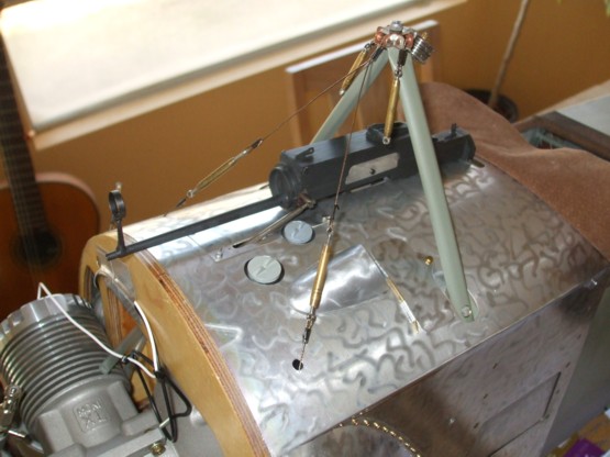

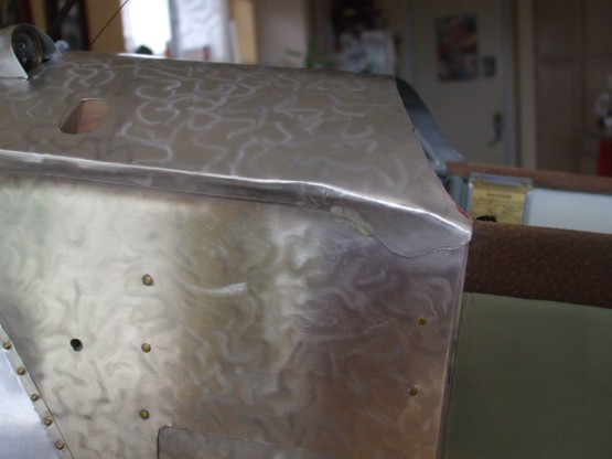

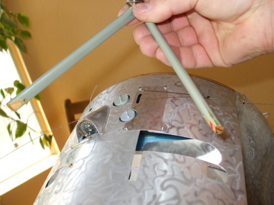

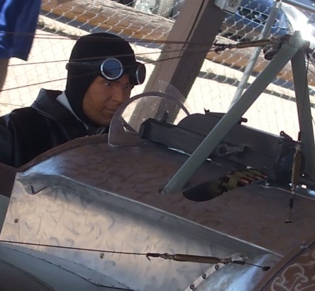

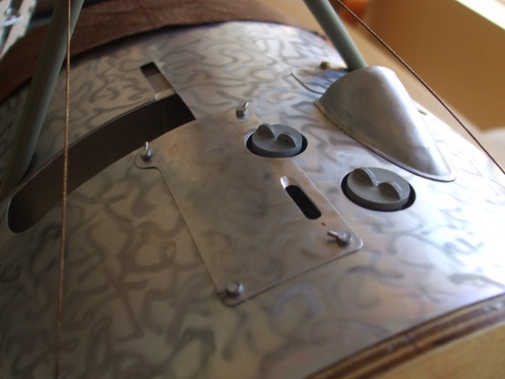

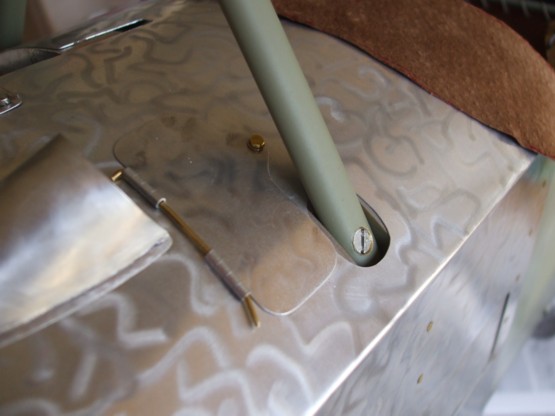

terrific,,how did you make the lines on the aluminum cowling,,?
they looks great like the real one ,,,again ,,one of the best EIII i ever seen ,,,
thanks for share this pictures ,im saving them for future reference ,im looking for one eindecker (proctor) at decent price,i want to build one ,
,,i have the n28 and n11 from them,,,

Hi Amil, and thank you!
The squigglies, or 'lines', were made with a Dremel wire brush. Perhaps this is what was used on the original (larger, of course)??
All of the sheet aluminum used by Fokker on the E-III was treated this way . It was done to help reduce reflection without having to use paint.
John
