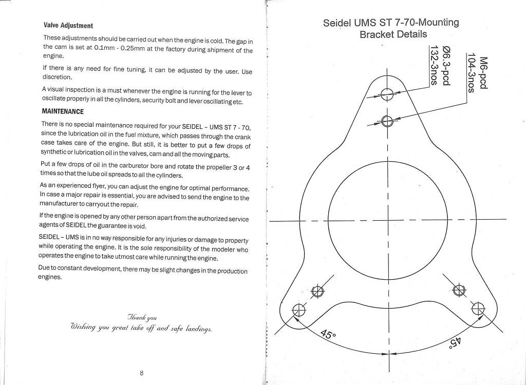

Old 07-20-2010 | 02:28 AM
Teus's Avatar
Joined: Jan 2007
Posts: 765
Default RE: Methanol?
Fuel info from the manual:
Old 07-20-2010 | 03:36 AM
Teus's Avatar
Joined: Jan 2007
Posts: 765
Here the full manual, much easier than mailing a big Pdf file.

ORIGINAL: Teus
Everything alright?
Since your visit to Holland you are loaded with the most wild ideas and plans
That scale event really lit my fire! So many things seem possible now that I had never thought of as possible before!
I've got the digital manual from the UMS Seidel 7-70, it's a 7.5Mb pdf file.
Thanks! I'm printing it out as I'm typing this!

I see that the manual suggests doing the break in with straight methanol with just a bit of oil and NO nitro. Interesting. I suppose there much be a source for plain methanol here in Japan.
