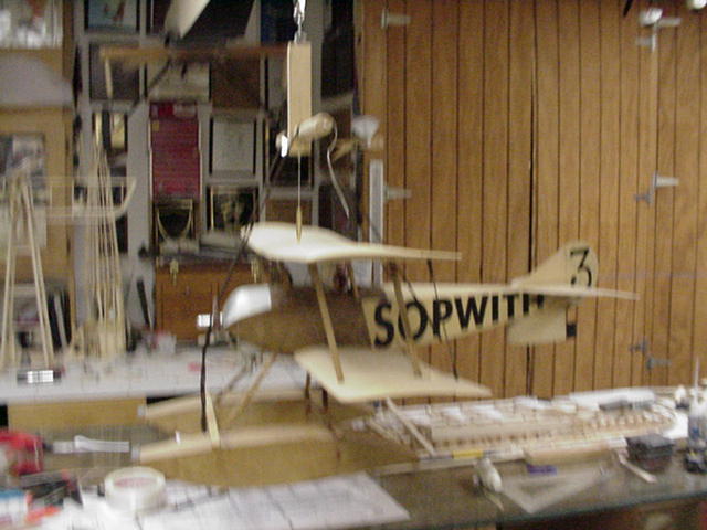

Abu a Vanessa balancing device is easy to create and will simplify the balancing process. Locate the current "true" balance point and determine where you need to go from there. May have instructions for the Vanessa rig if you need them.

I use the Vanessa to balance all my bipes. Easy and true.

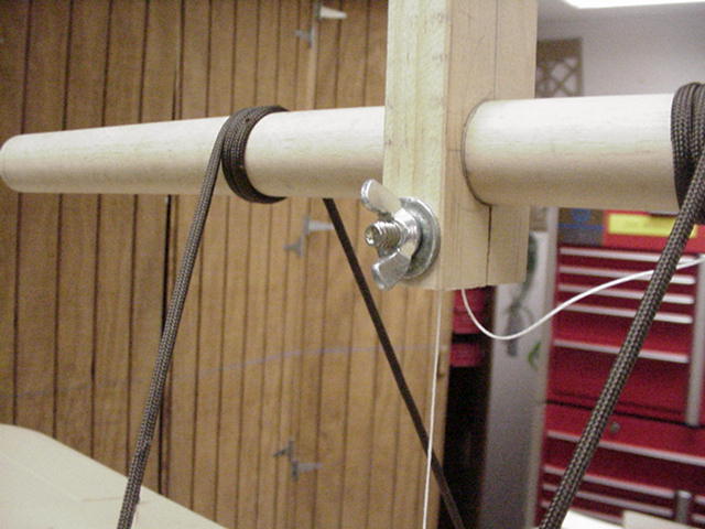

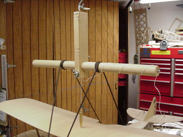

Vanessa Balance Rig
3 Attachment(s)
This is what it looks like. The vertical part is poplar 1 x 2 x 8 inches long. The dowel is 1" but a piece of a broom handle would work, about 14" to 18" long. The hole should be made to allow the dowel to slide easily through the vertical part. A slit is sawed from the hole to the bottom and a bolt hole cross drilled to allow adjusting the tension of the dowel. It needs to rotate but with some resistance. Theres a hook in the top to hang it from a little homemade block and tackle I made from hardware store pulleys so I can set it up on the bench then hoist it up easily. I use 550 paracord for the suspension harness but any nylon cord or even cotton sash cord will work fine. the suspension harness doesnt have to be any place specific, Ive moved it all the way to the tail and under the landing gear and it works the same. Make a plumb out of a sharpened bolt with a hole or find a small plumb at the iron mongers. I hang mine from the tension bolt so it is off just a tad but I can figure it out. Use at least three turns of cord around the dowel so it has a grip, you will rotate the dowel to raise or lower the nose/tail if the model and when you get it level (or a tad nose down) where the plumb is pointing is the CG. It's fool proof easy to make and accurate, balancing models with your finger tips is for trainers NOT SCALE AIRCRAFT. Build one you'll love it.

Nosing over on take off doesn't indicate anything about the c.g. The 'vanessa rig' and all of that jazz is nice but you don't need it. Just measure your MAC and calculate. Do this: put a bubble level on your stab at 'zero'. Use a triangle to measure where LE of fwd most wing and TE of rearward most wing are located on the table normal to the line of flight. It doesn't matter if your wings are staggered. Calculate the balance point at 25% from LE of the combined wings LE to TE measurement. That's it! If you have plenty of elevator throw and area then move the balance point forward a little. Short coupled aircraft or those with tiny stabs (think sailplanes) required a little more accuracy. 25% MAC is a good starting point.
