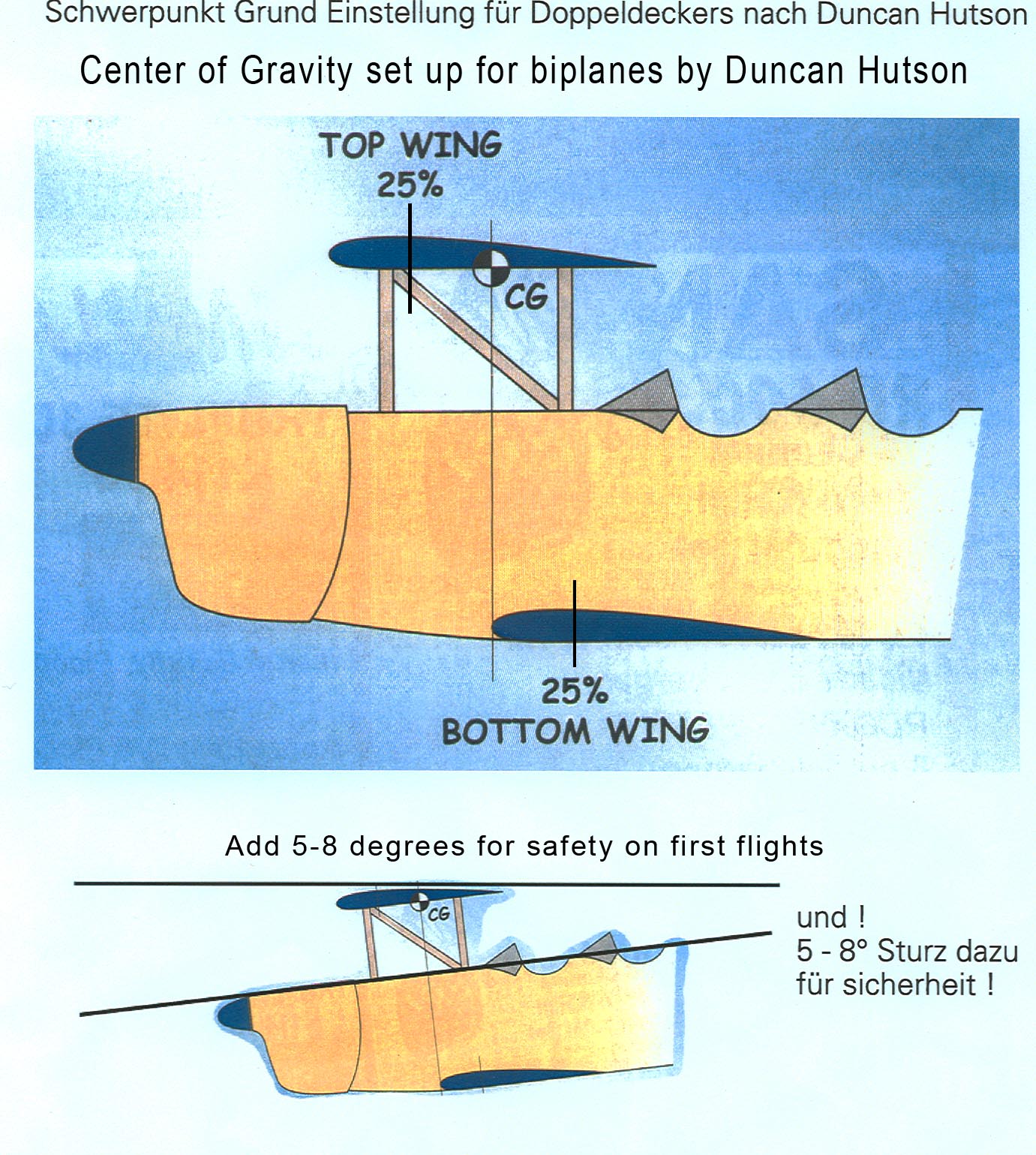

1 Attachment(s)
Hey guys...finally found this graphic I got from Duncan Hutson years ago..I have used this method very successfully for years and have never had any exciting moments on my first flights...it works very well.http://www.rcuniverse.com/forum/atta...mentid=1979771

radfordc 03-20-2014 12:00 PM
3 Attachment(s)
Originally Posted by abufletcher (Post 11763221)
Until WHAT's level? I would assume this is an "aircraft center line" (which in the case of my Snipe with its 0 down thrust would be level with the engine). If you "level" the stab, then the fuselage is pointed a couple of degrees down.
You want the plane to hang in the same attitude that it flys in normal level flight. Usually this means the horizontal stab will be "level"....but it really depends on the airplane's characteristics.
You can add lots of weight to the nose with model in the rig, and the position of the model doesn't change. The cords hold the model in position. In this sense, the model isn't balancing at all. I know the "balancing action" must be taking place somewhere in the rig, but I can't figure out where. The only thing that's free hanging is the plum bob.
Due to the way the model is suspended in a V rig the plane "must" move if you add weight to the tail or nose! Look at the attached drawings. In the first you see the model suspended in the V rig harness. The CG of the model is located directly under the dowel and the plumb bob which is also attached to the dowel points directly to the CG.
In the second view, I added 2 lbs to the tail of the model. As a result the CG has moved back drastically. The new CG must fall under the dowel also. You can see how the model moved nose up in order for the new CG to fall under the dowel.
In the third view, I have leveled the model by rotating the dowel. Although the model moved the CG did not...it's still directly under the dowel and the plumb bob is still pointing to the CG.
