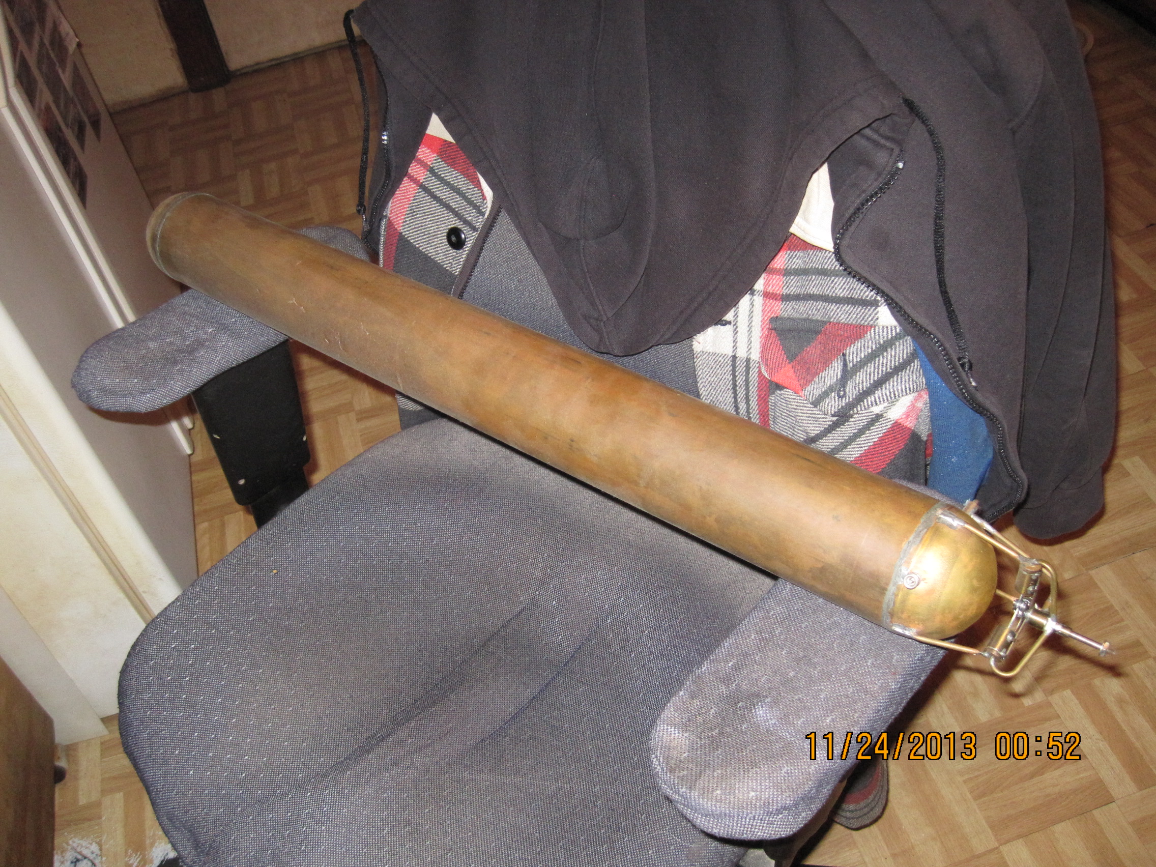

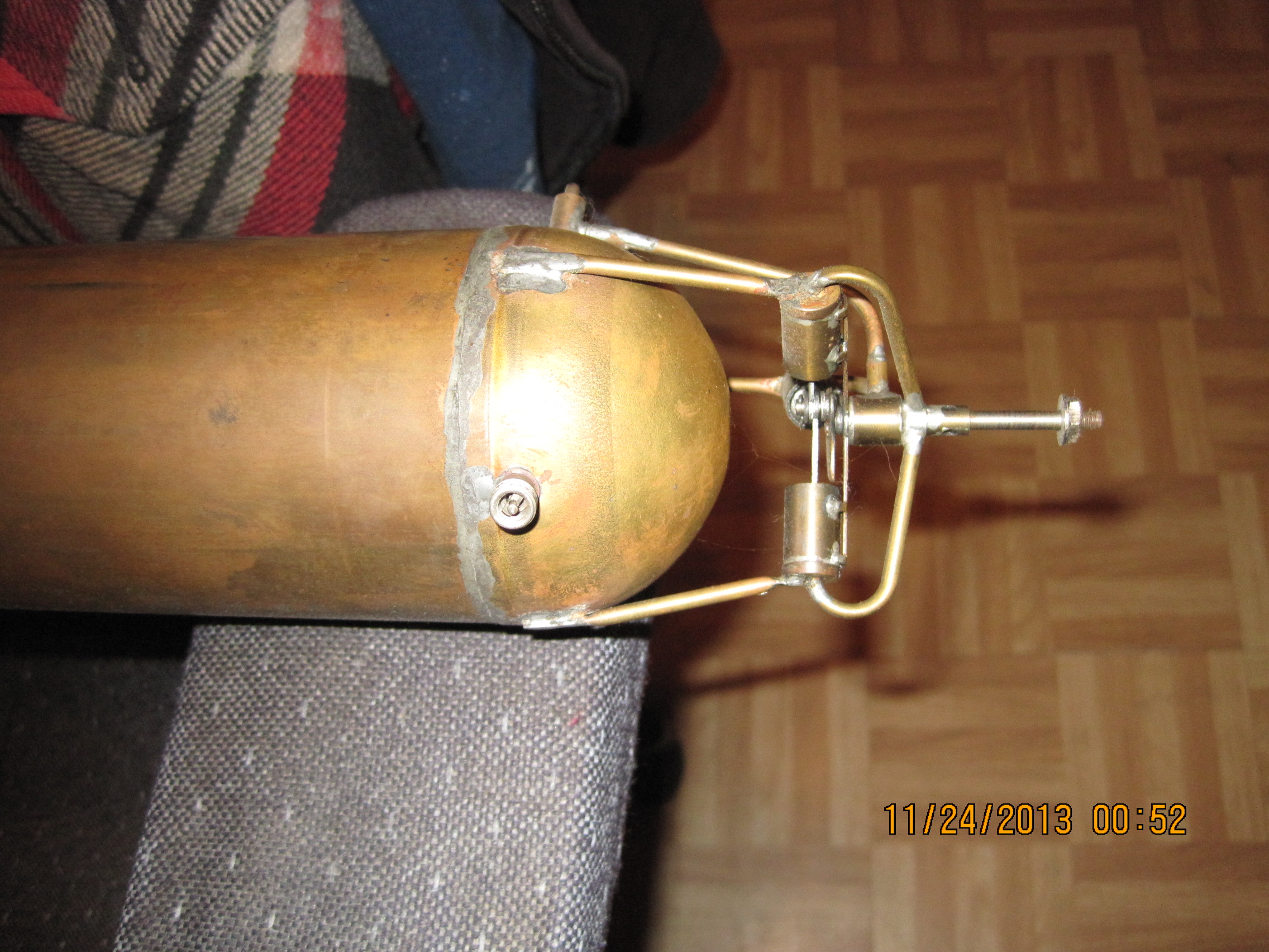

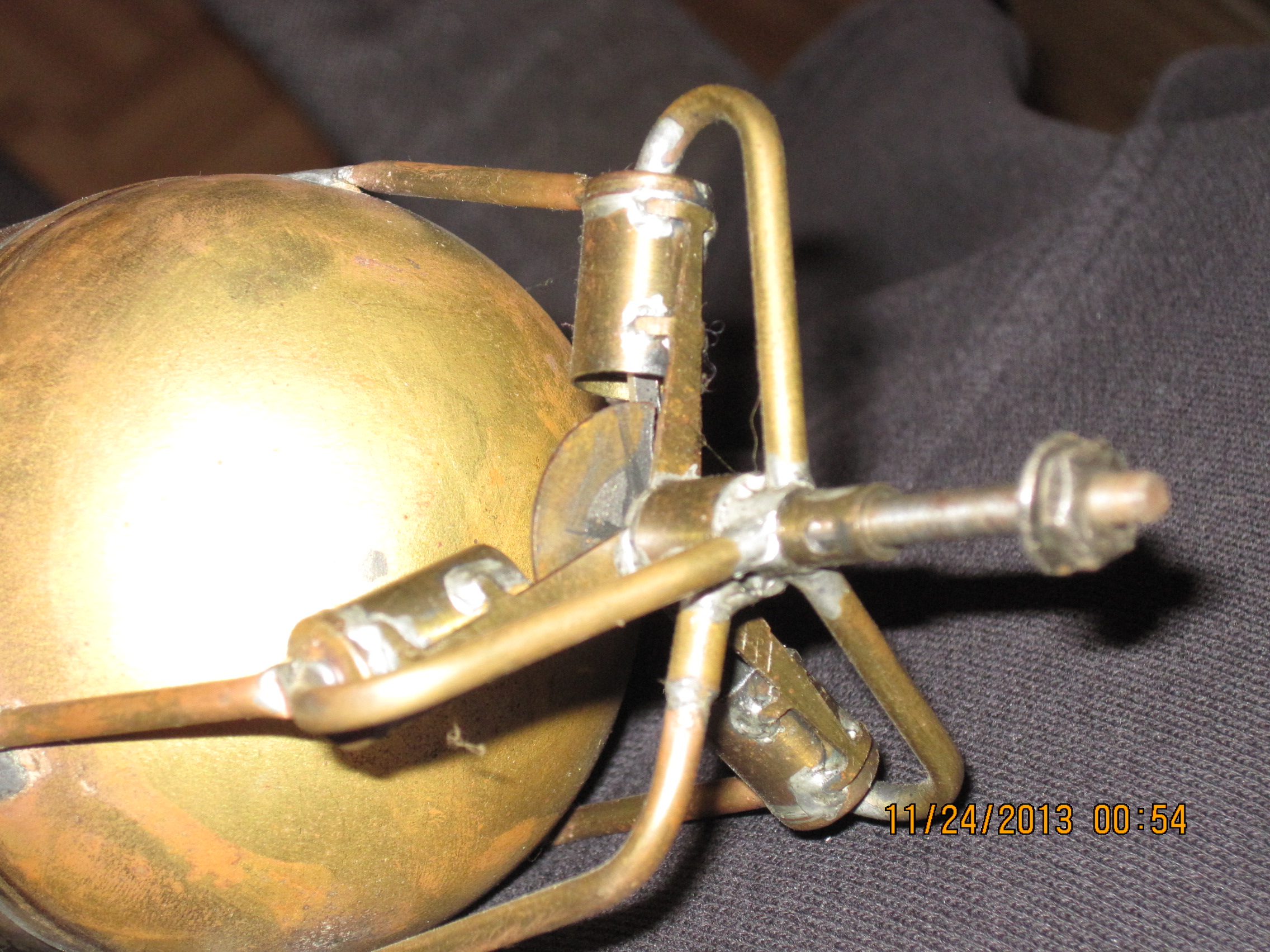

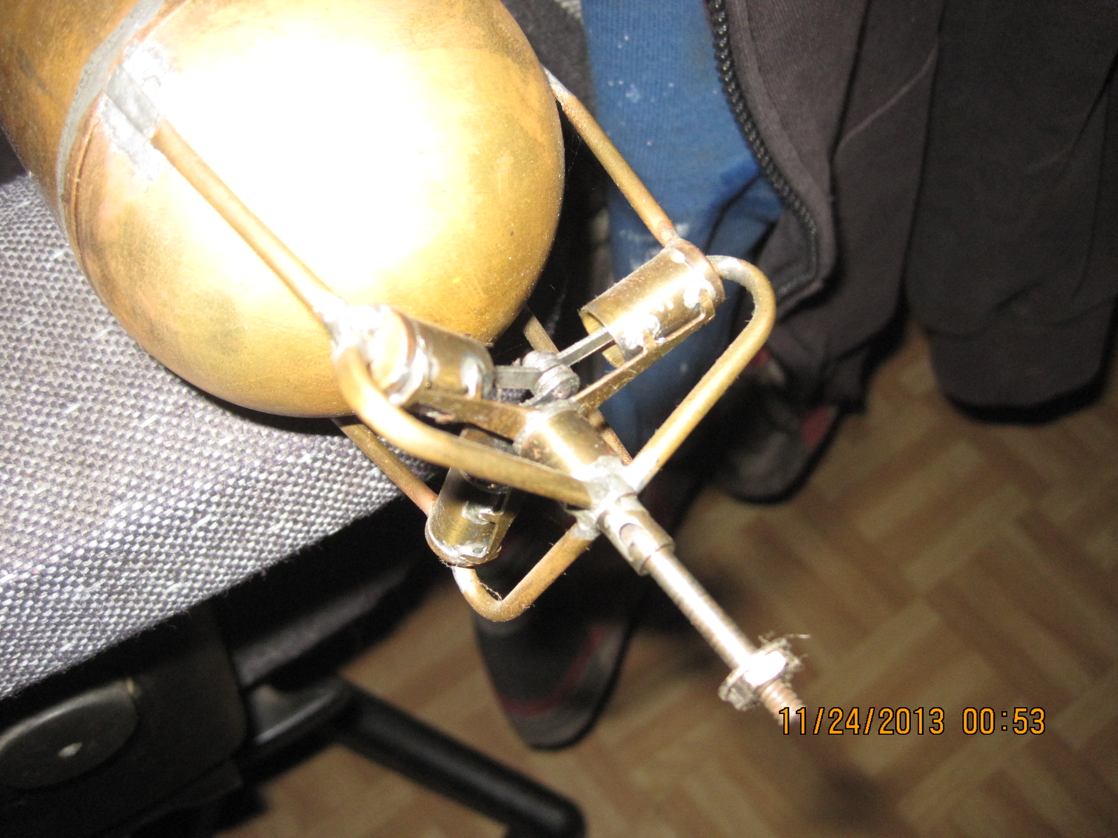

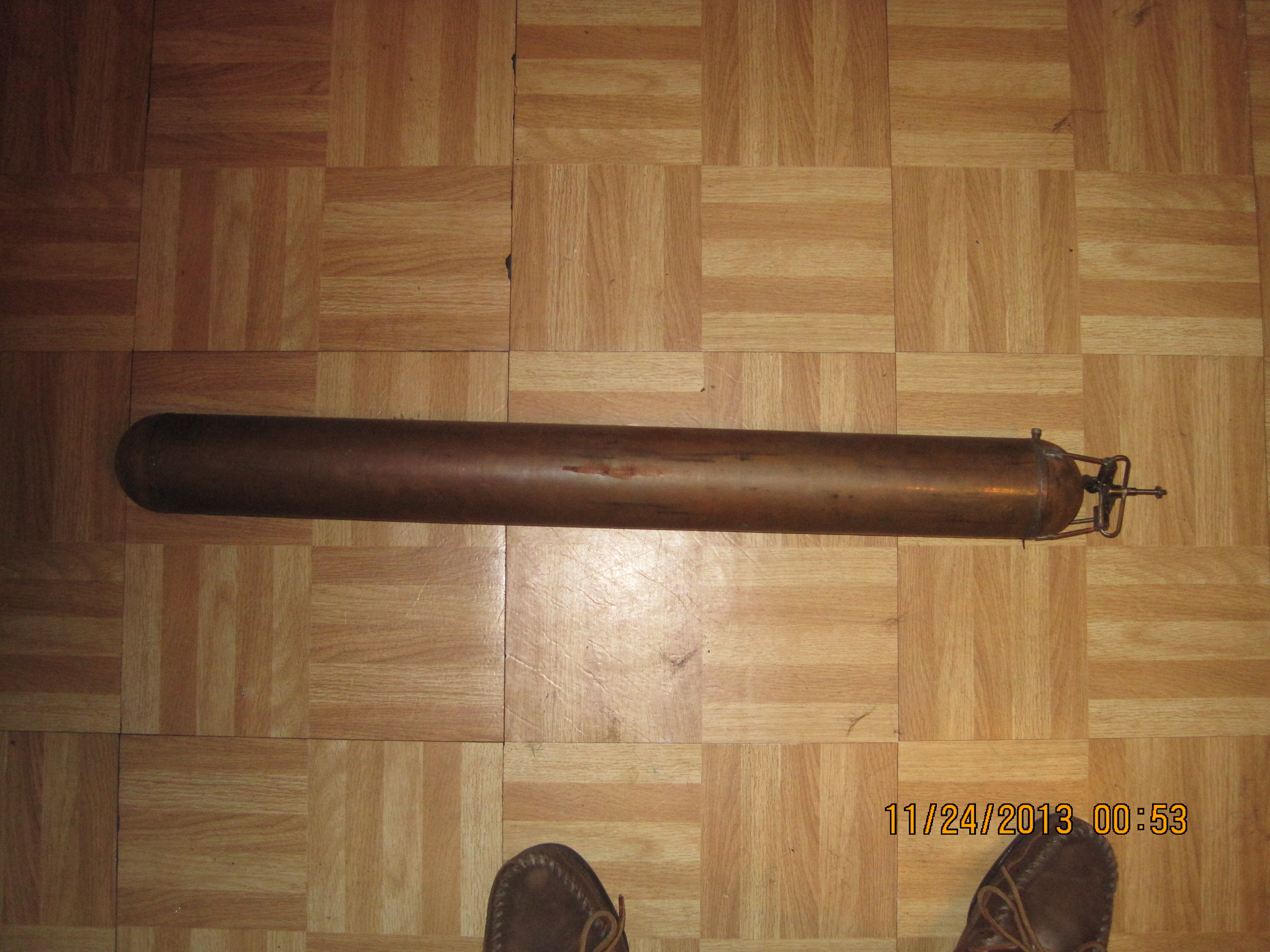

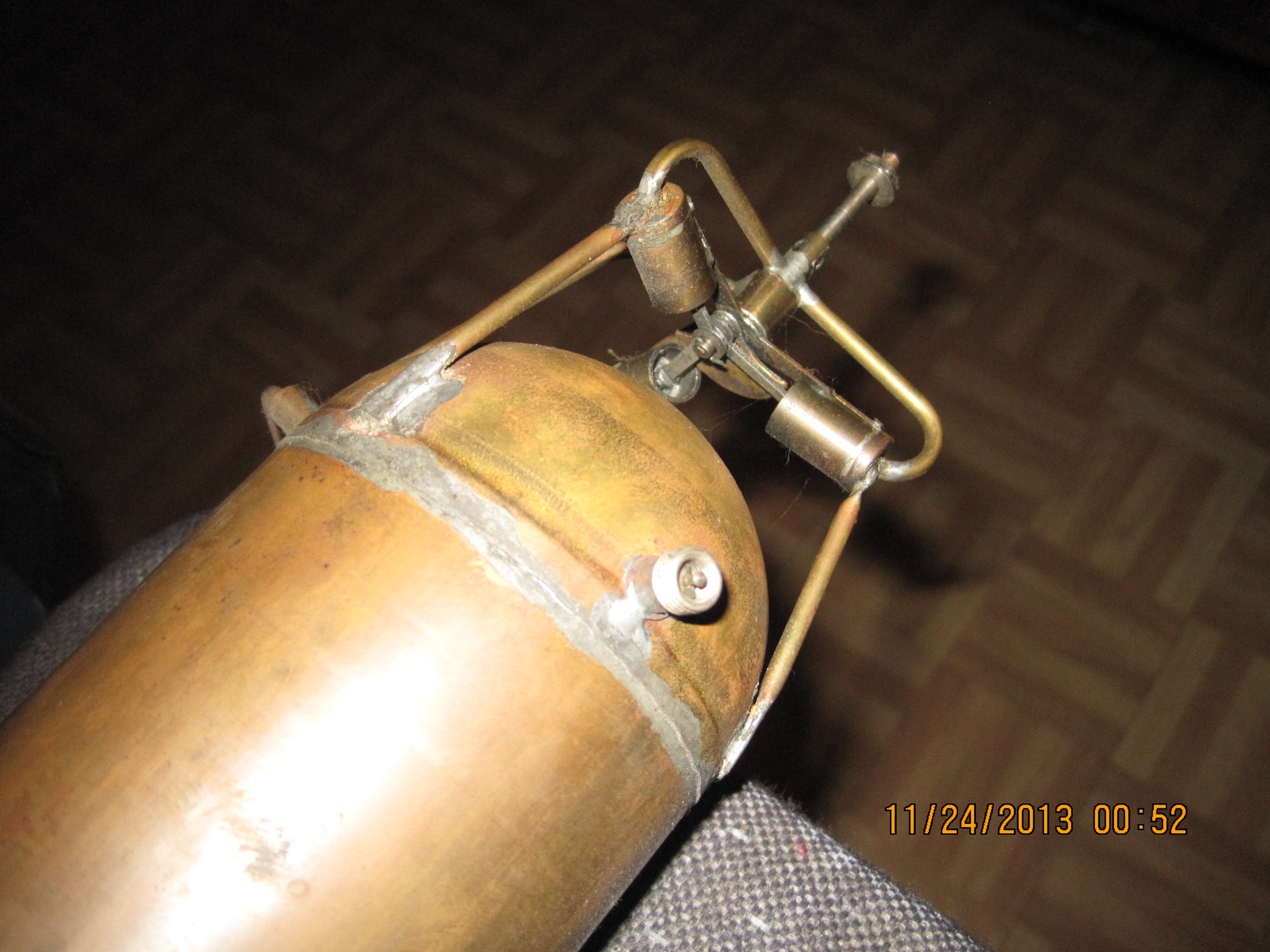

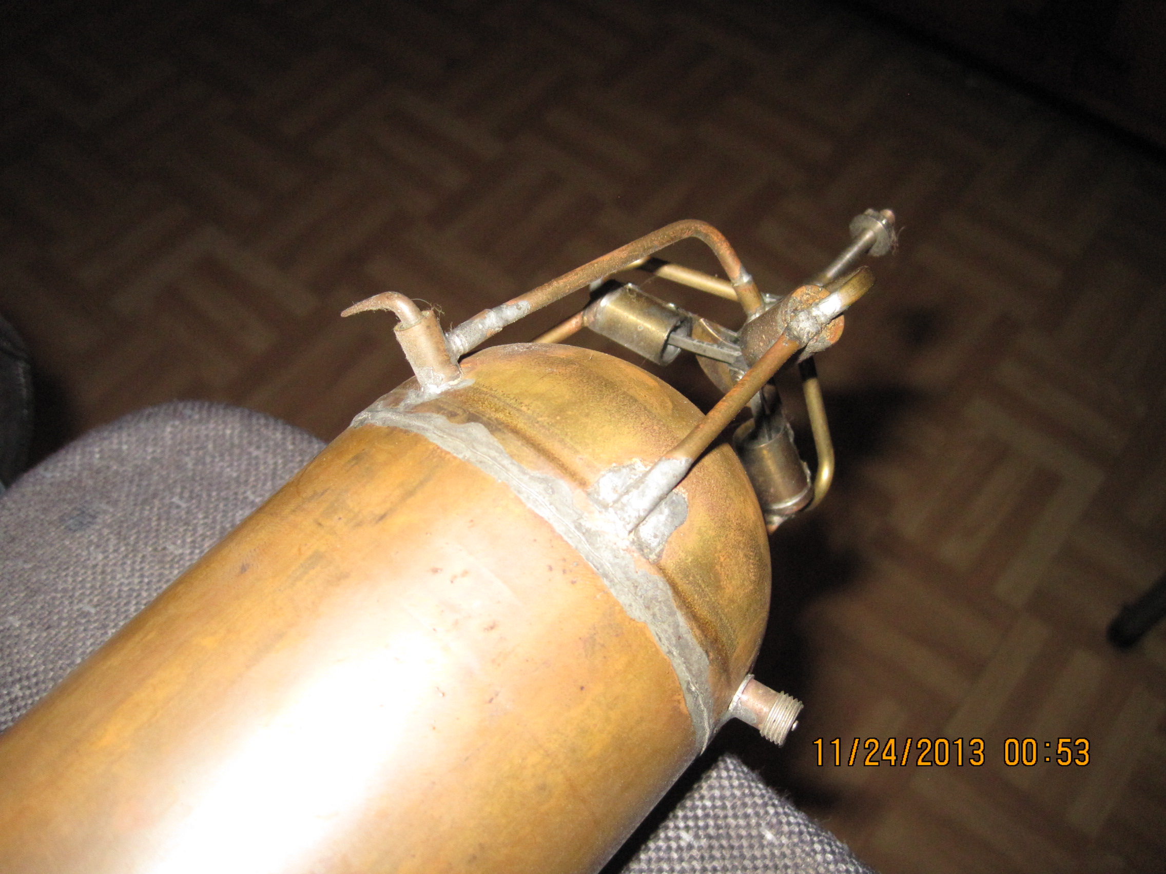

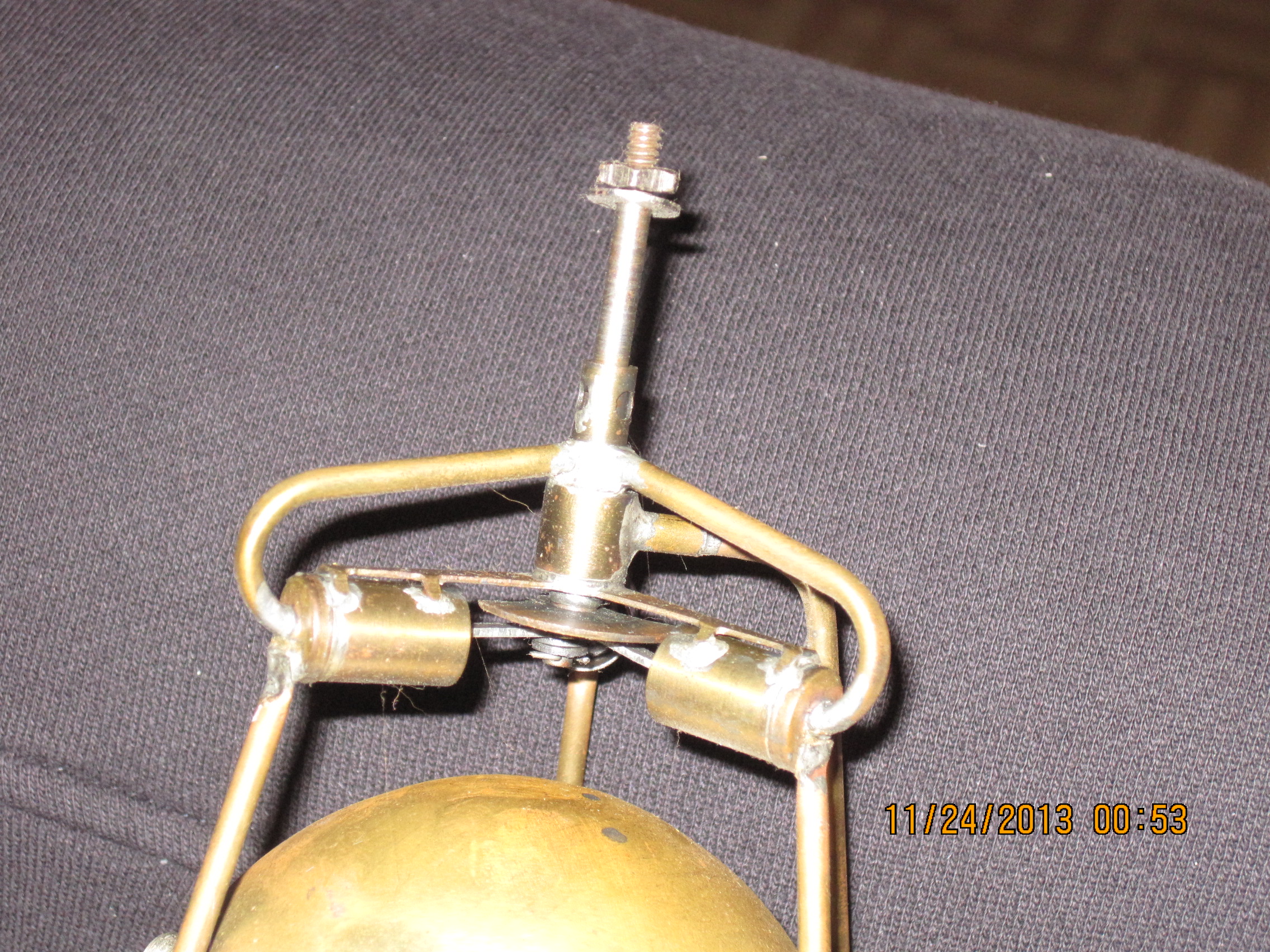

Hi, It would be interesting to see how You made these. Are the Torpedoes powered? Here are some pics of My late Dads Air Powered Torpedo that He made for one of His Larger RC Airplanes. I couldn't find the Snap on Fins or the Prop. His Basement is still full of Boxes of Balsa and RC plane stuff. The Floor Picture is to show the scale of about 2.5 Feet. There's a Fill Valve and an on and off Valve. Tim

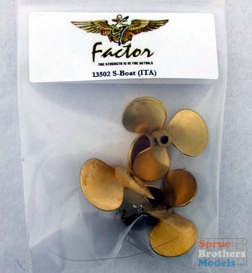

Hi, Thanks...are those the G-Factor Props (GFM13502 1:35 G-Factor S- Boat Propellers (ITA kit) #13502) and if so, are they strong enough for an RC Boat? Tim.
These are the ones in I have used as recommended by people who have already used them!

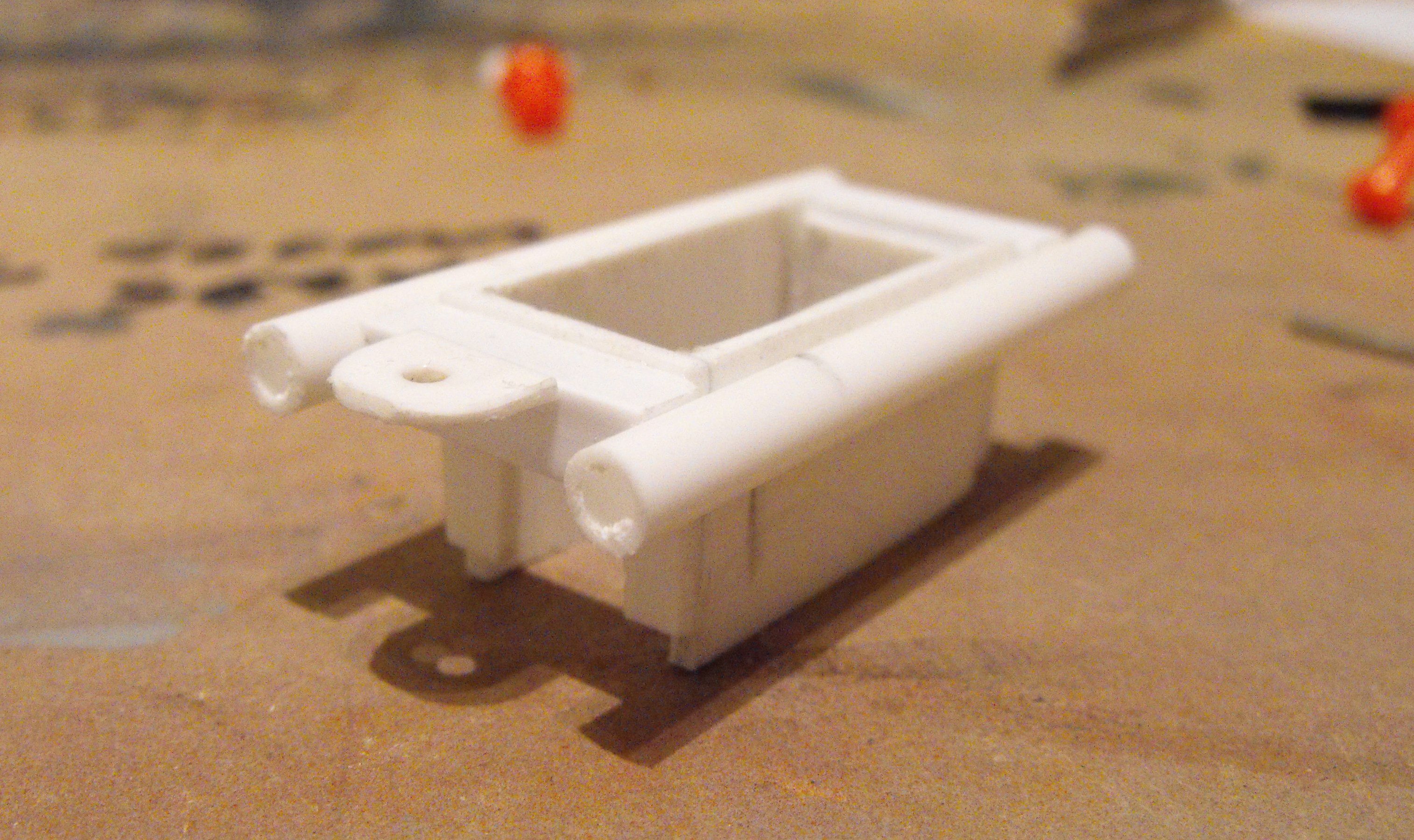

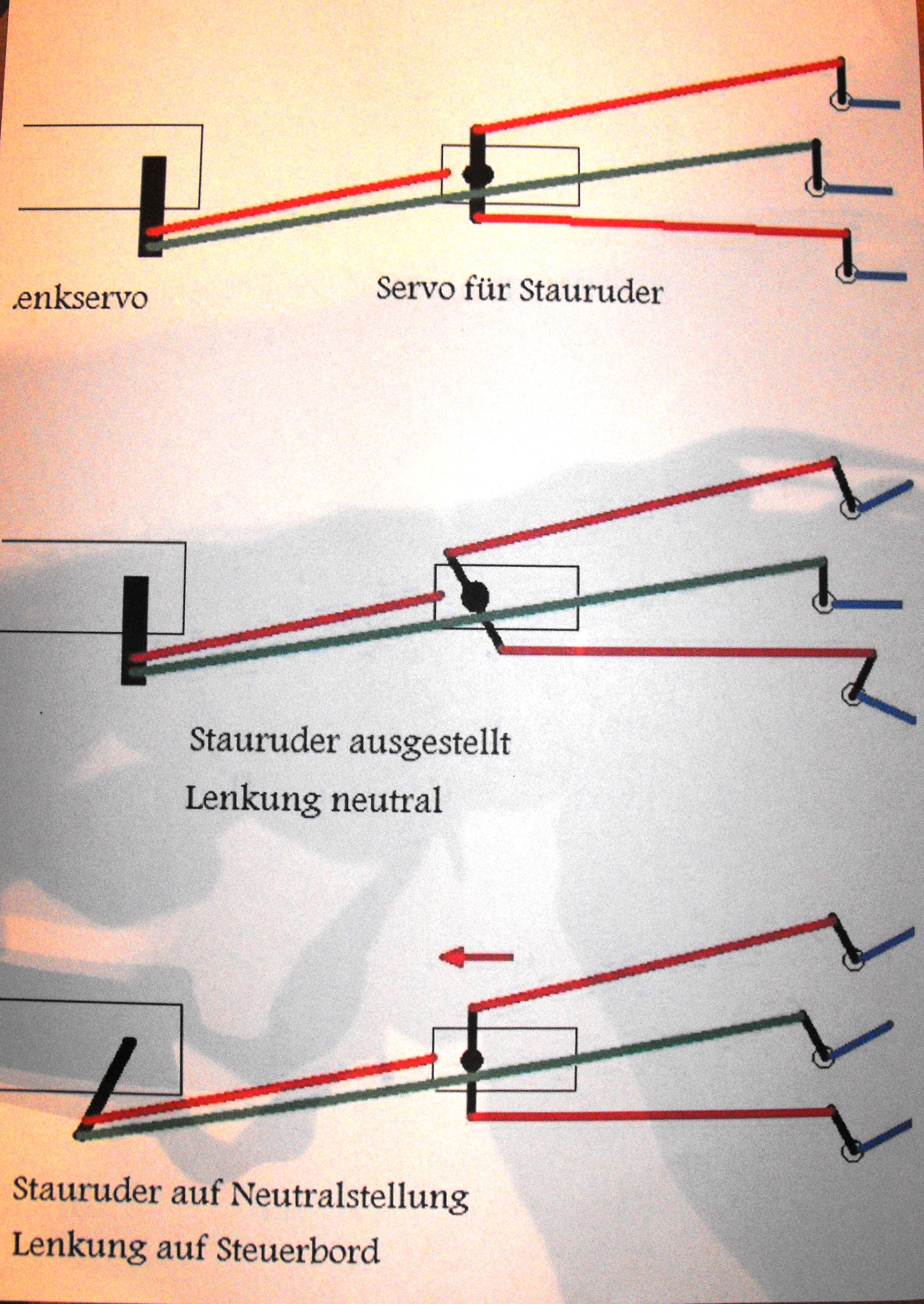

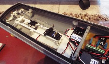

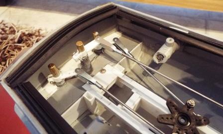

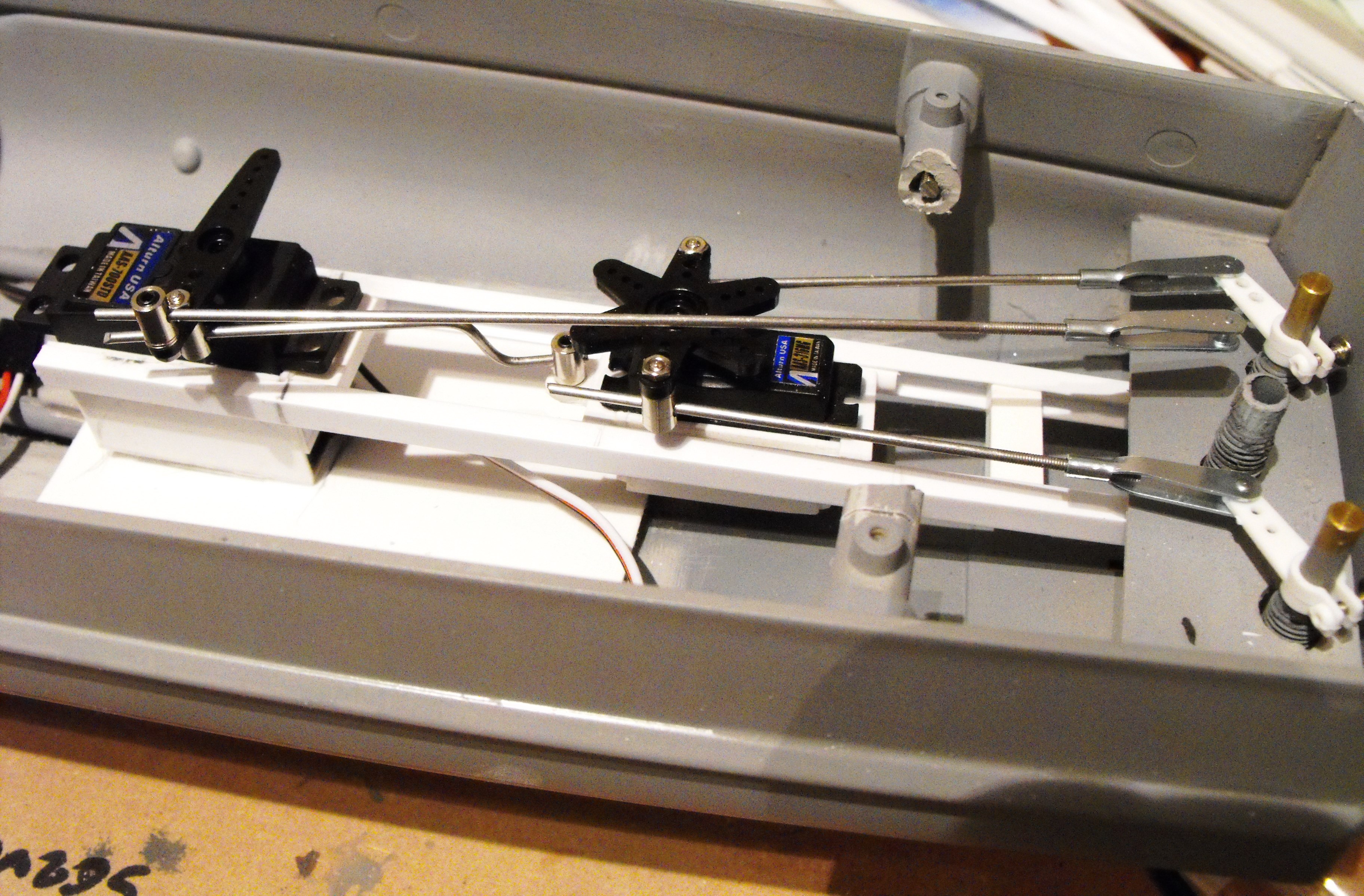

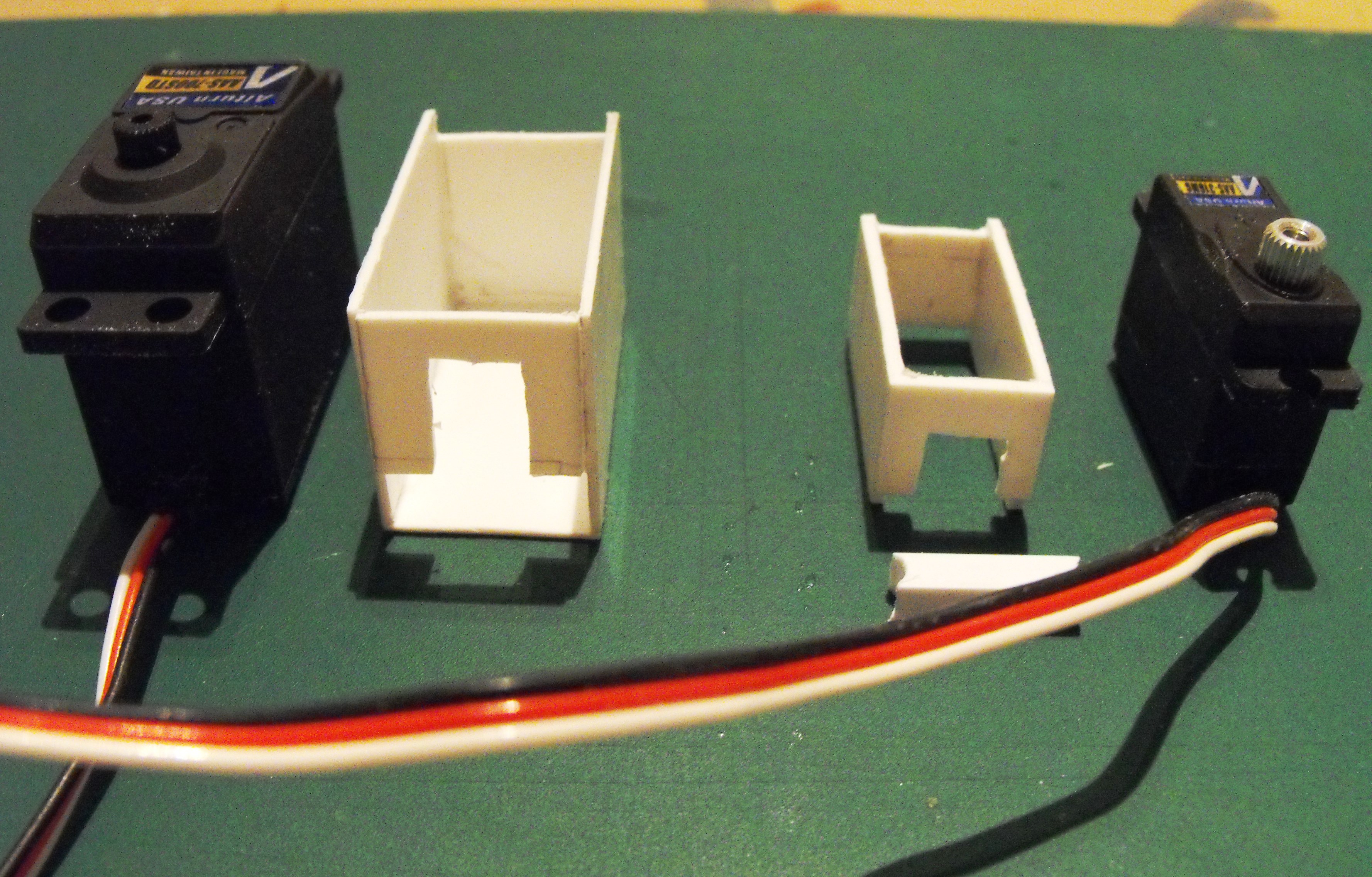

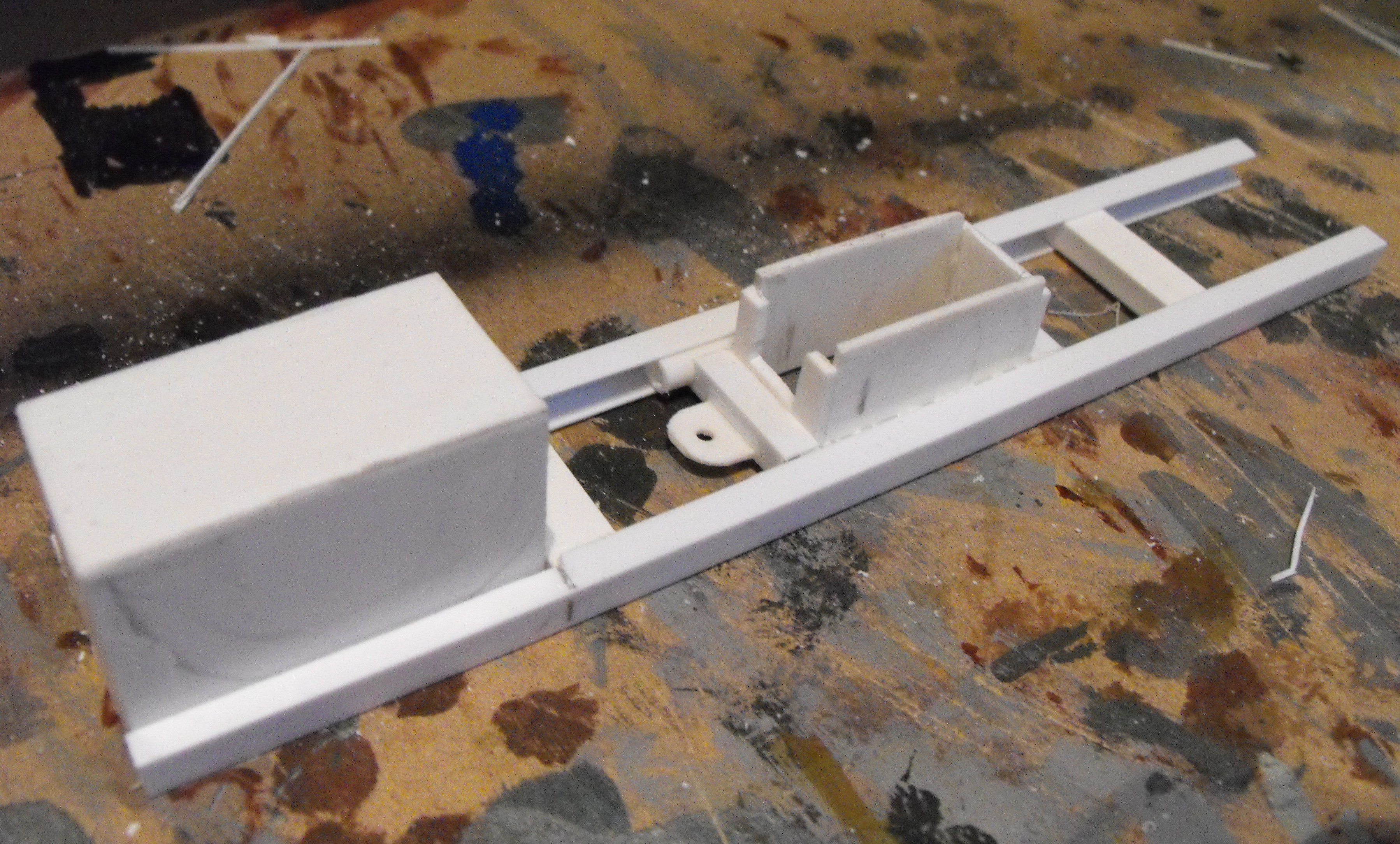

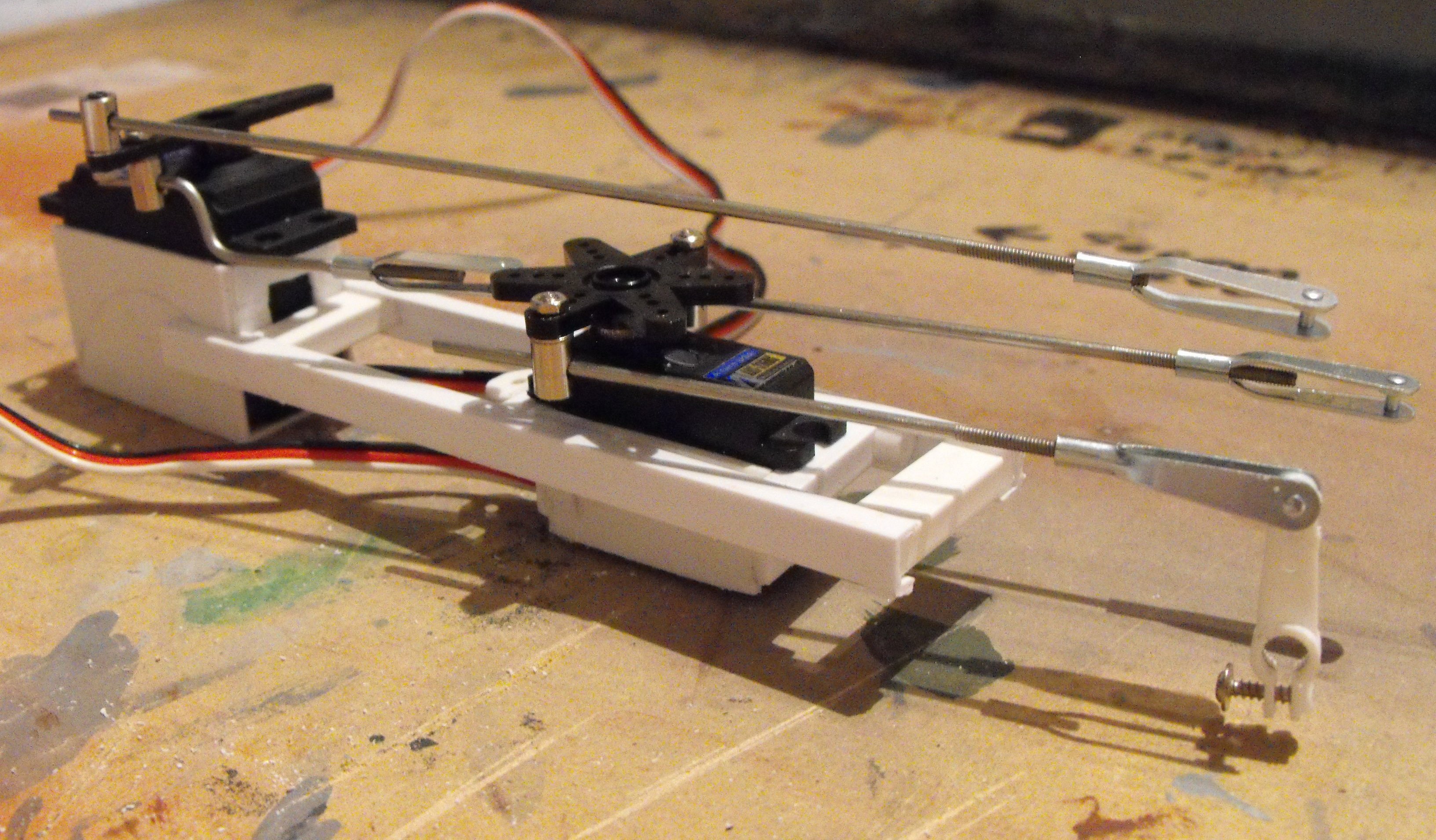

This is the module I have constructed to provide the Luurssen Efekt on the rudders!
Gregg

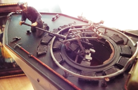

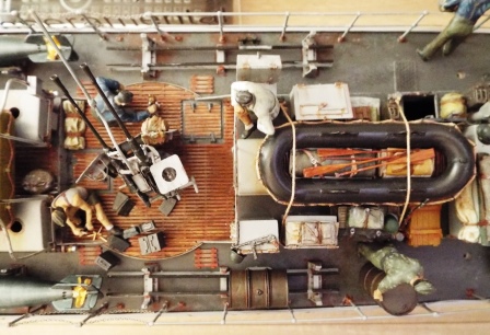

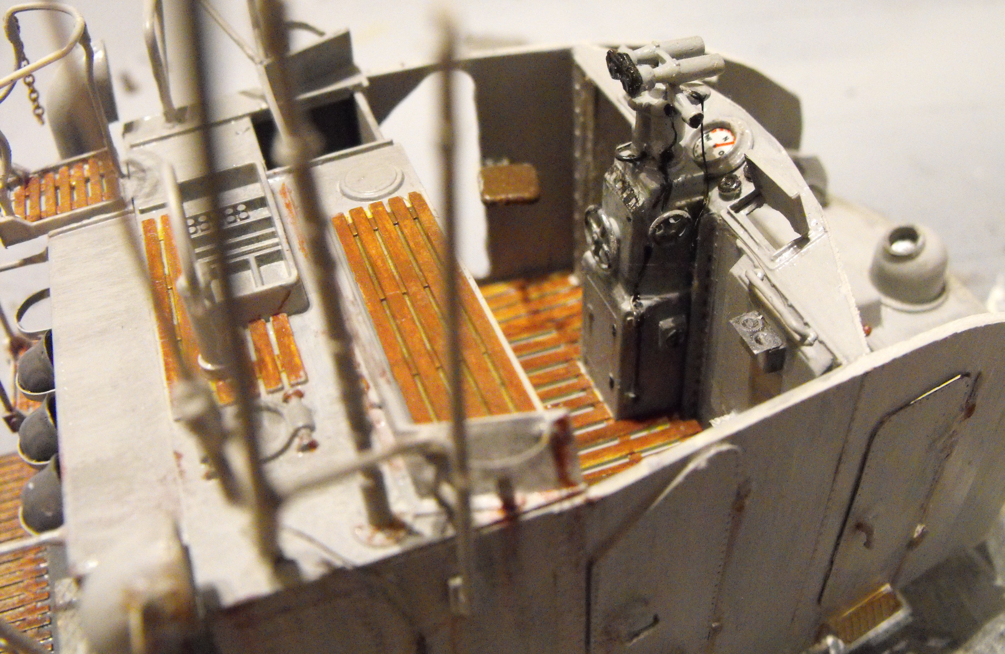

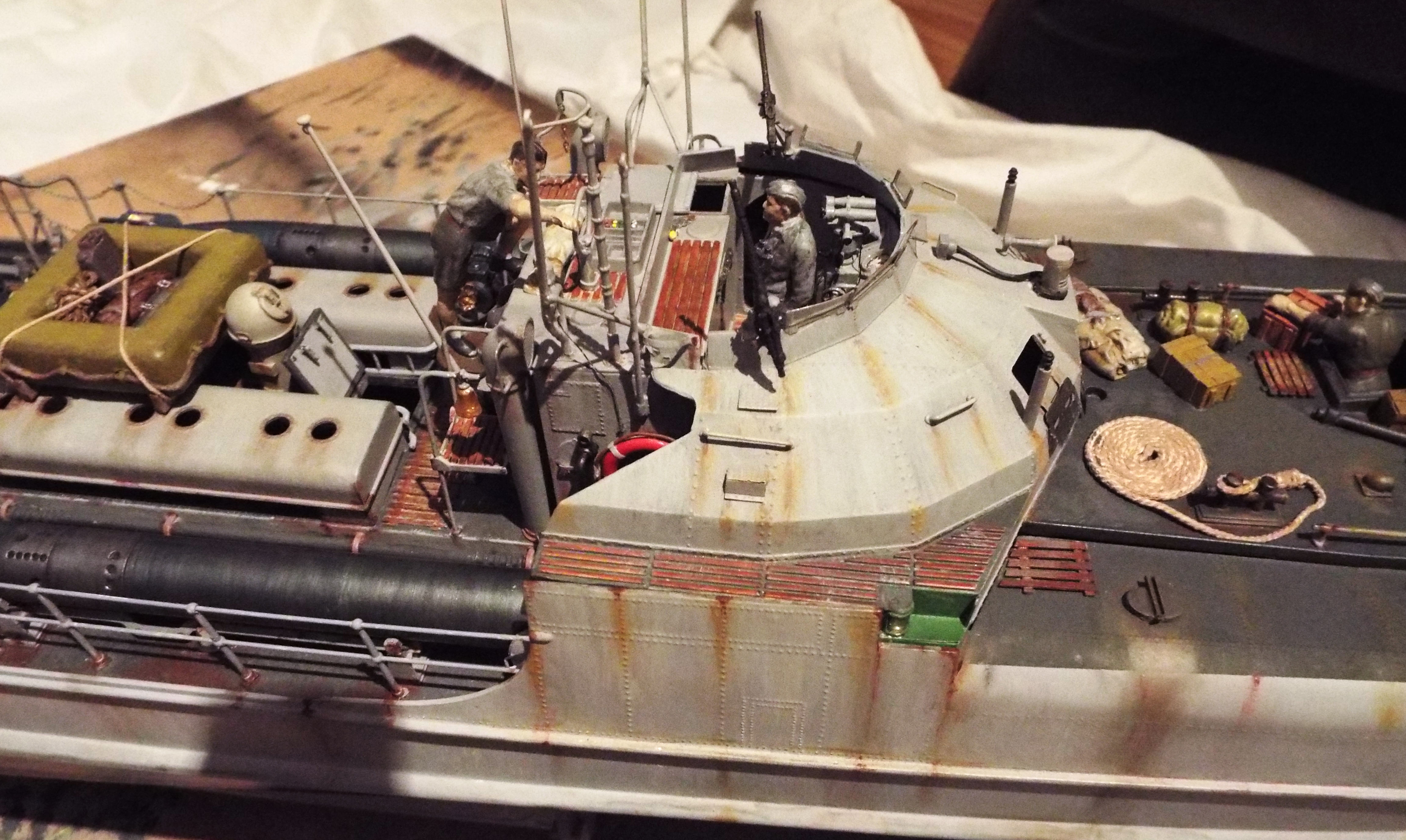

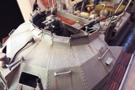

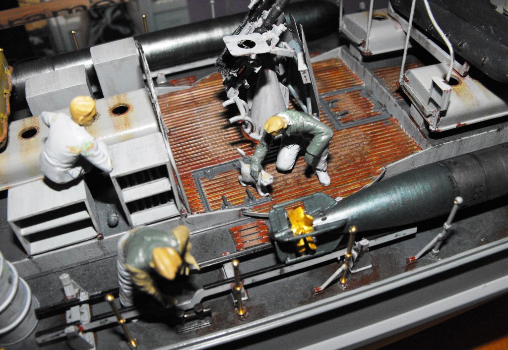

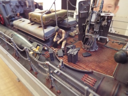

Some of my recent work on my Boote.

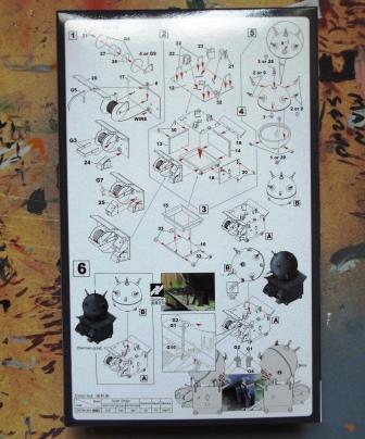

Many thanks for the positive comments, just making it up as I go along.
Feel free to contact, but remember to post on here so we can all share our experiences.

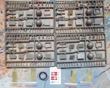

I recently acquired these from Taiwan, very cheap (including postage) and very fast delivery (6 days) from ordering.
Very detailed kit, very accurate and make the stern area more interesting I think!
Gregg

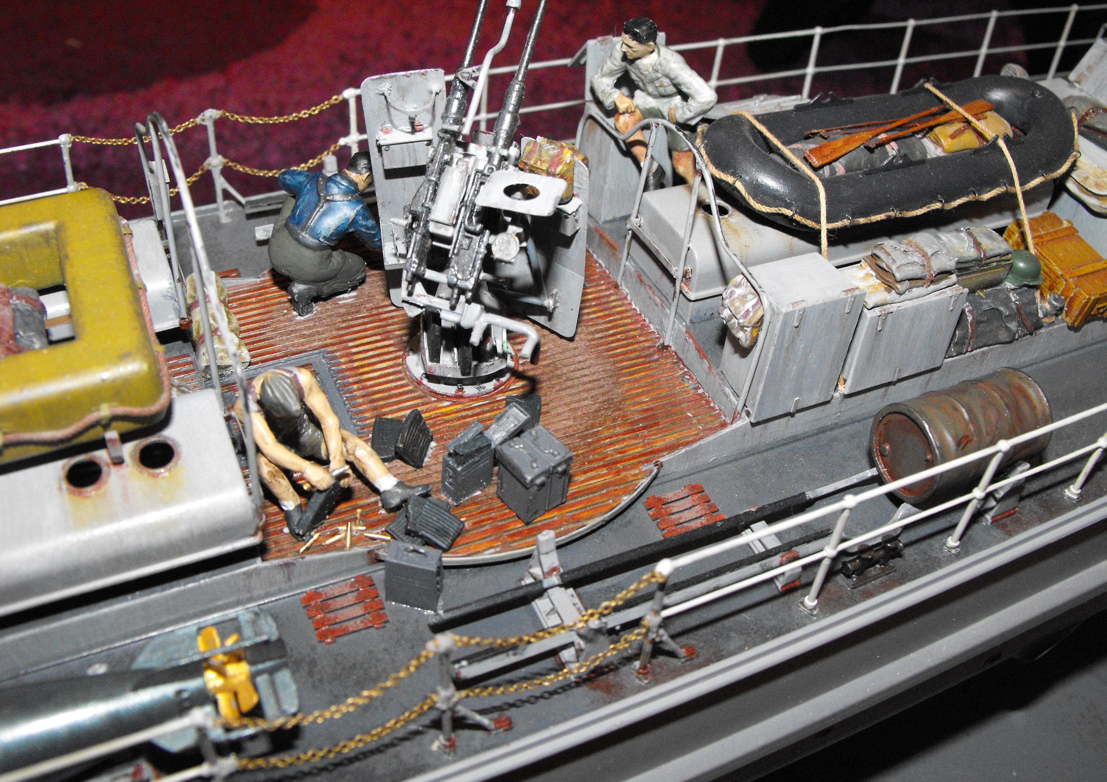

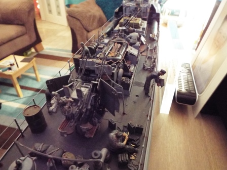

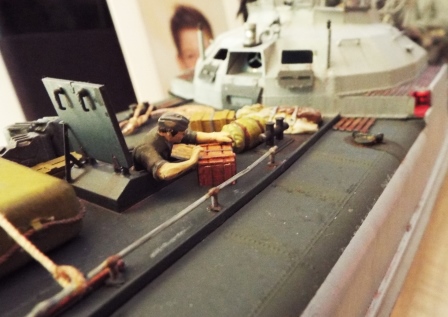

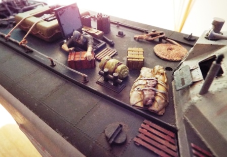

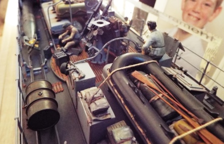

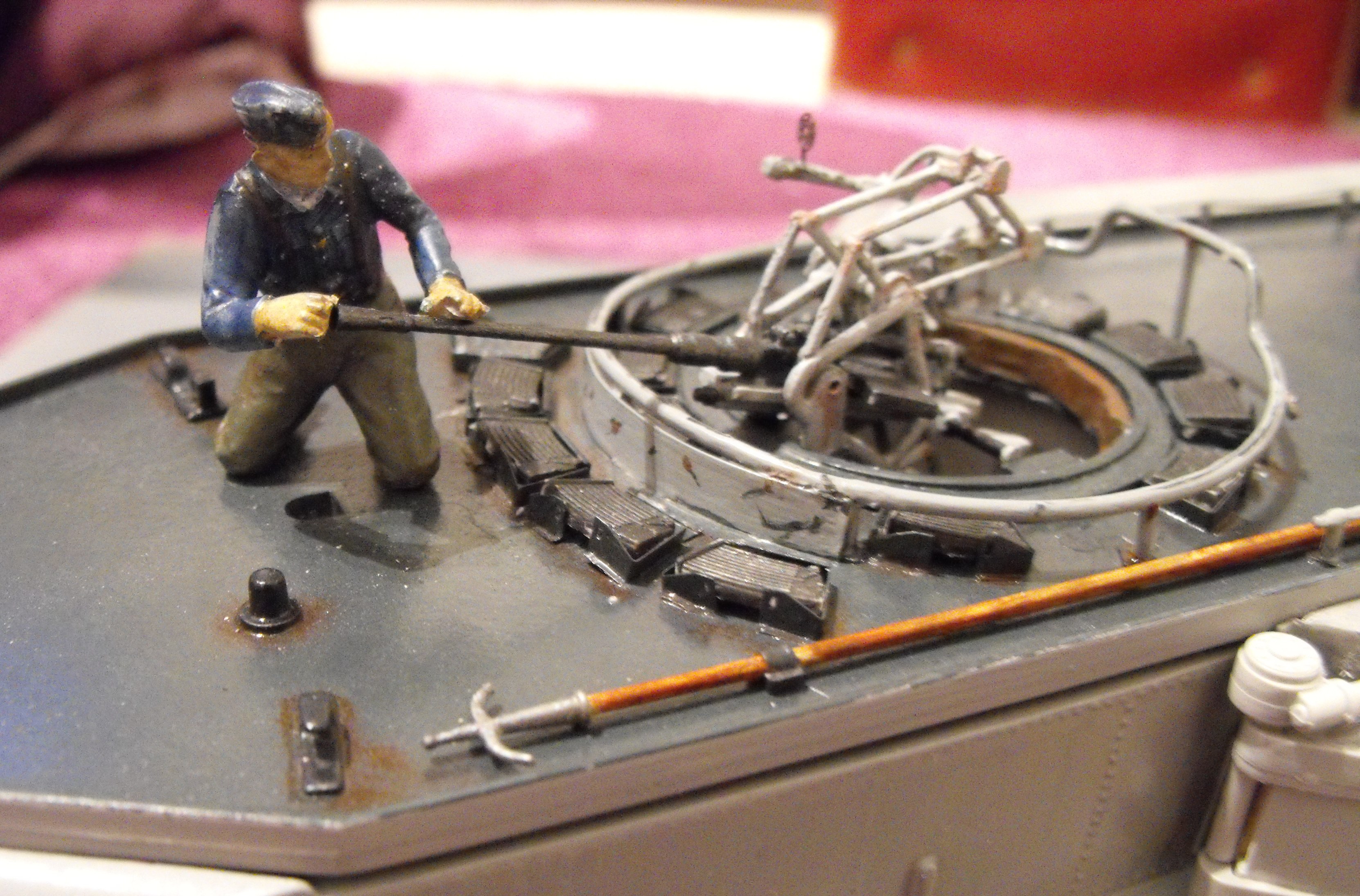

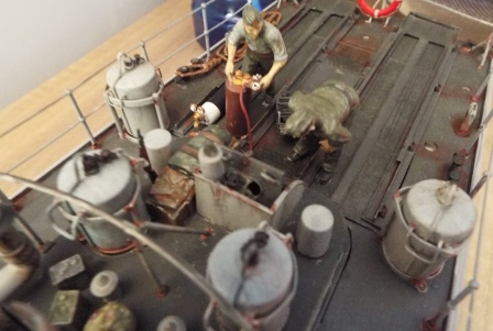

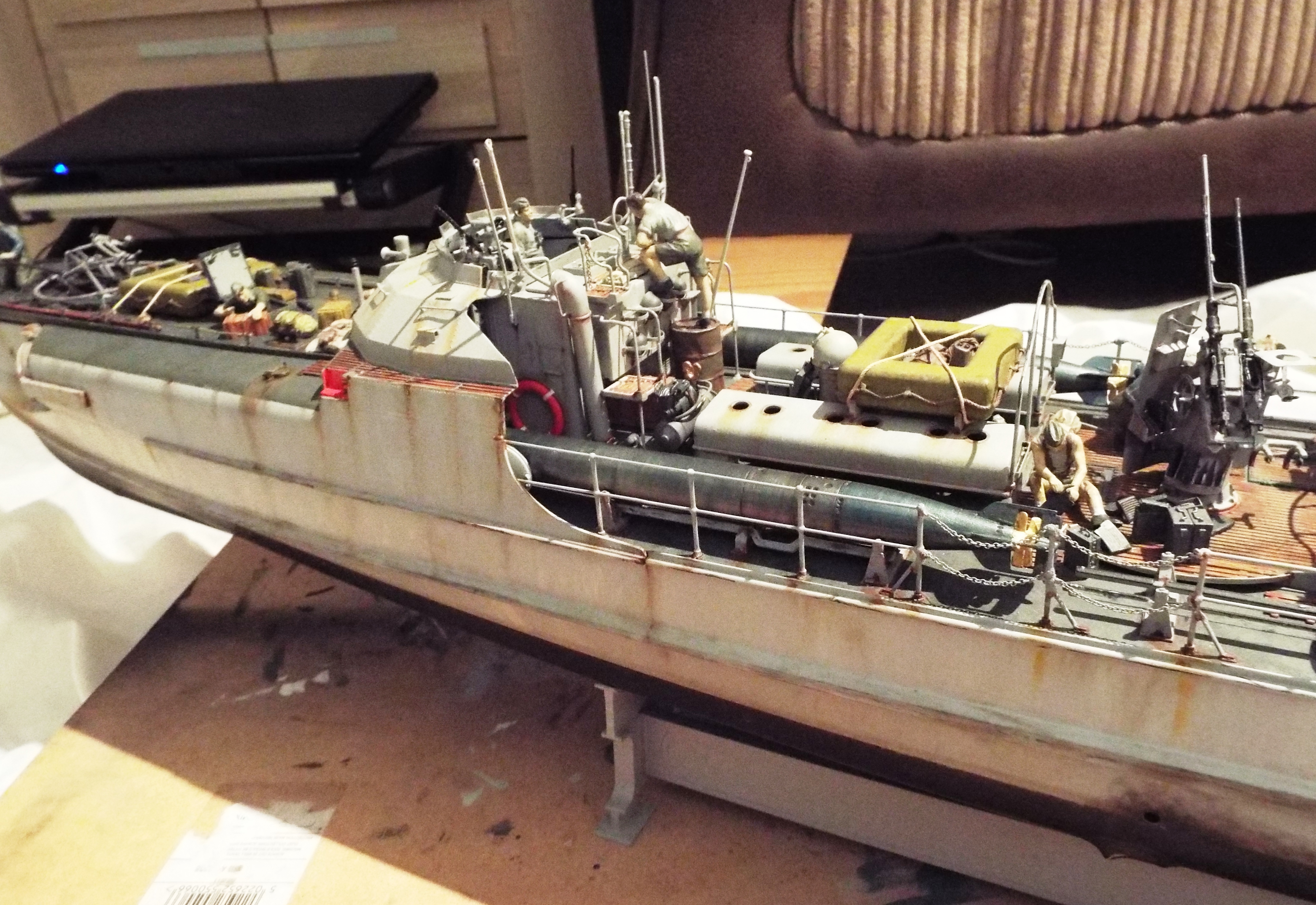

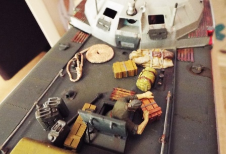

Finalising crew positions prior to sealing with final coat of matt varnish, the moving onto the hull, all 3ft of it!
Gregg

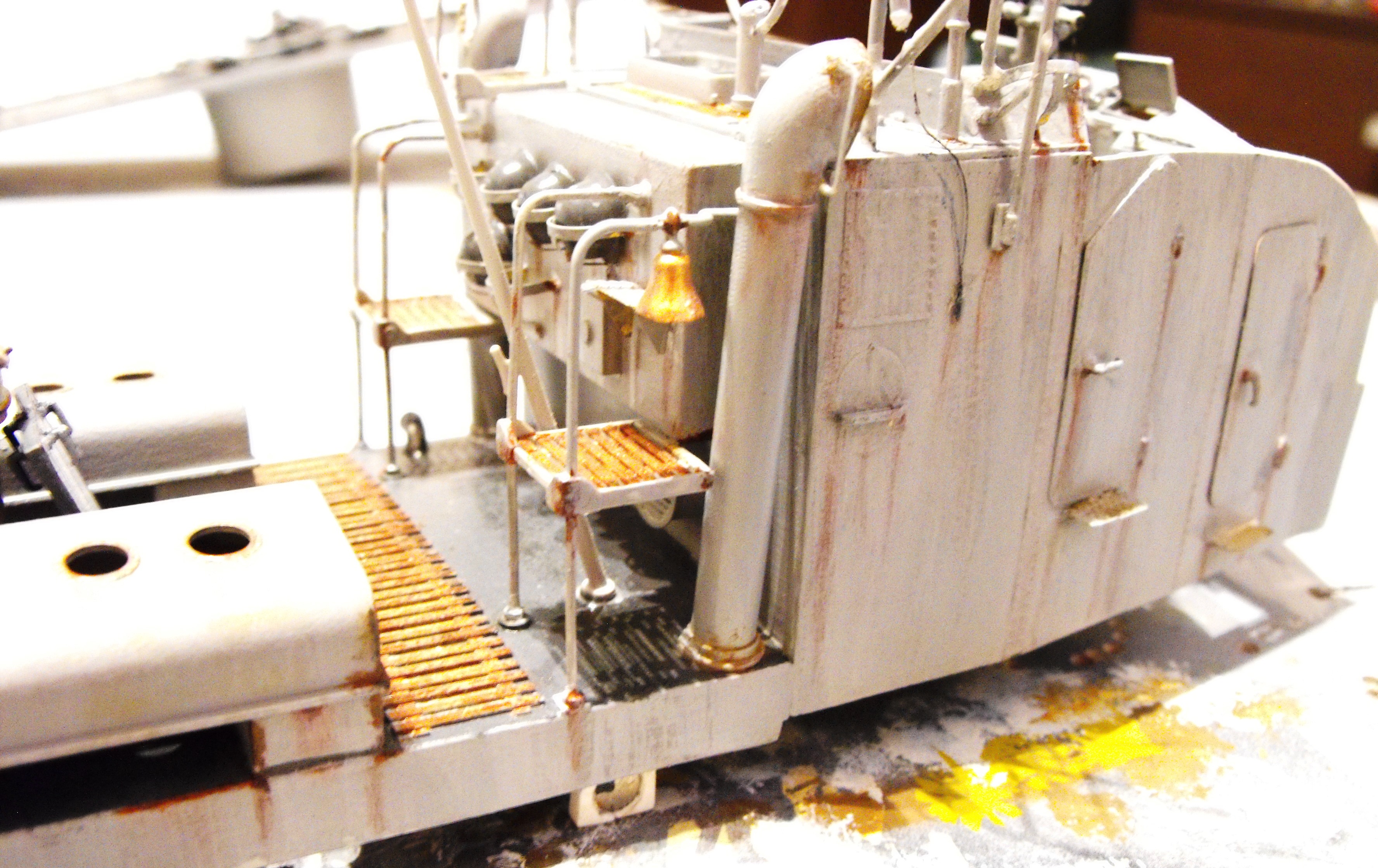

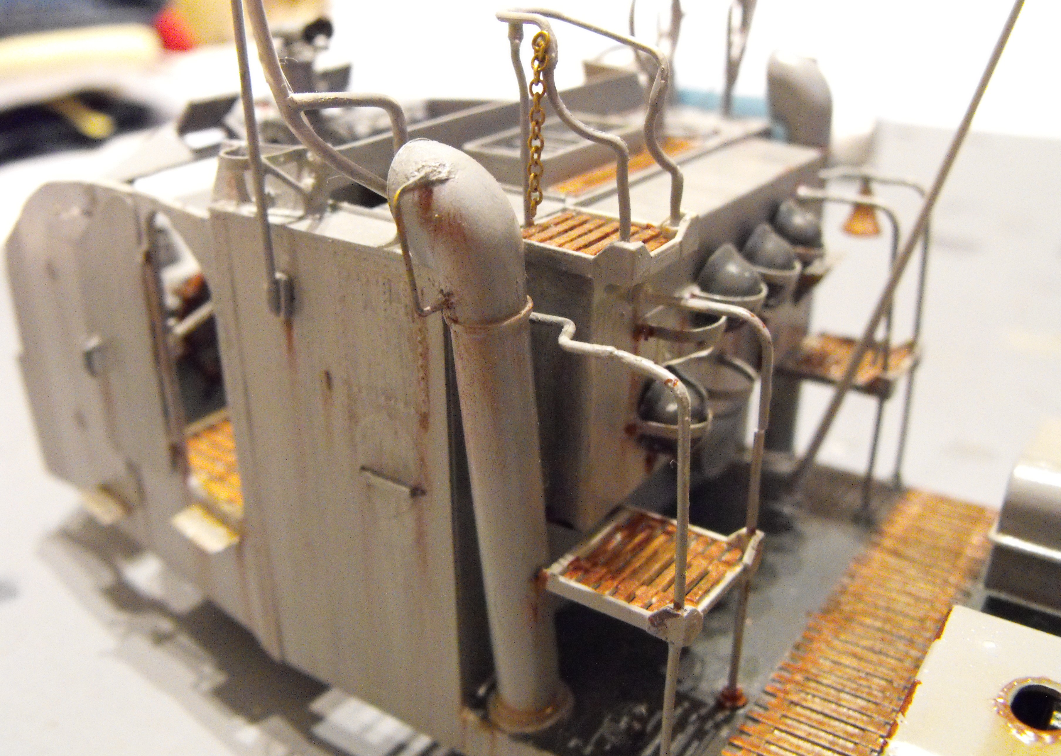

Old 02-05-2014 | 03:51 AM
  #36
Joined: Mar 2013
Posts: 65
From: Hull, UNITED KINGDOM

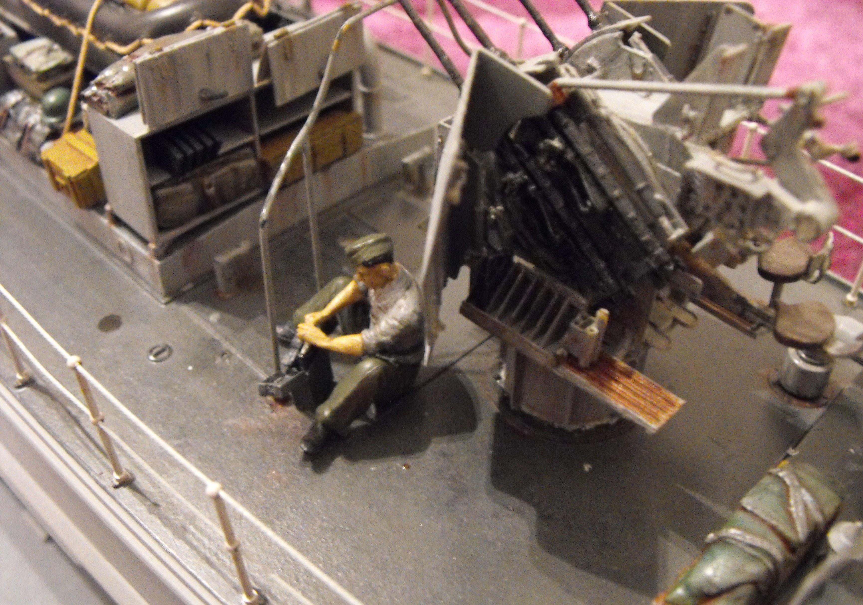

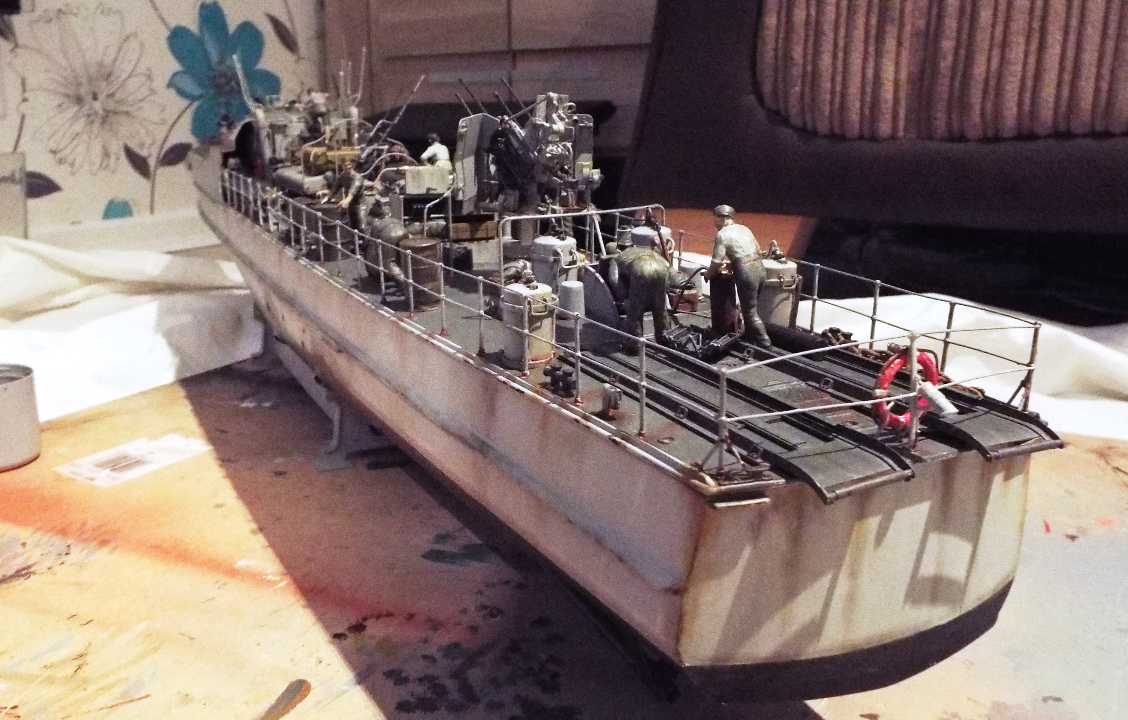

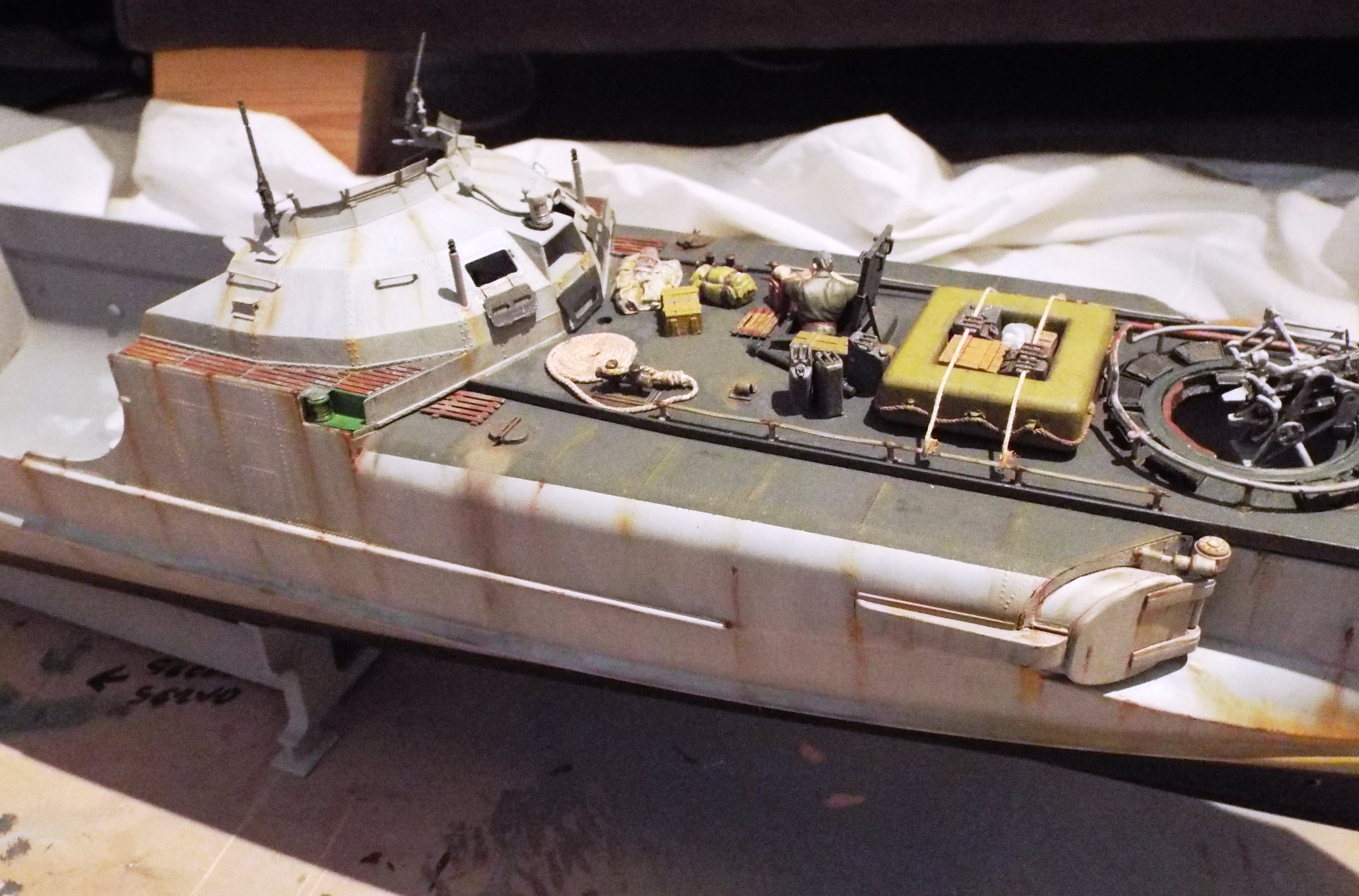

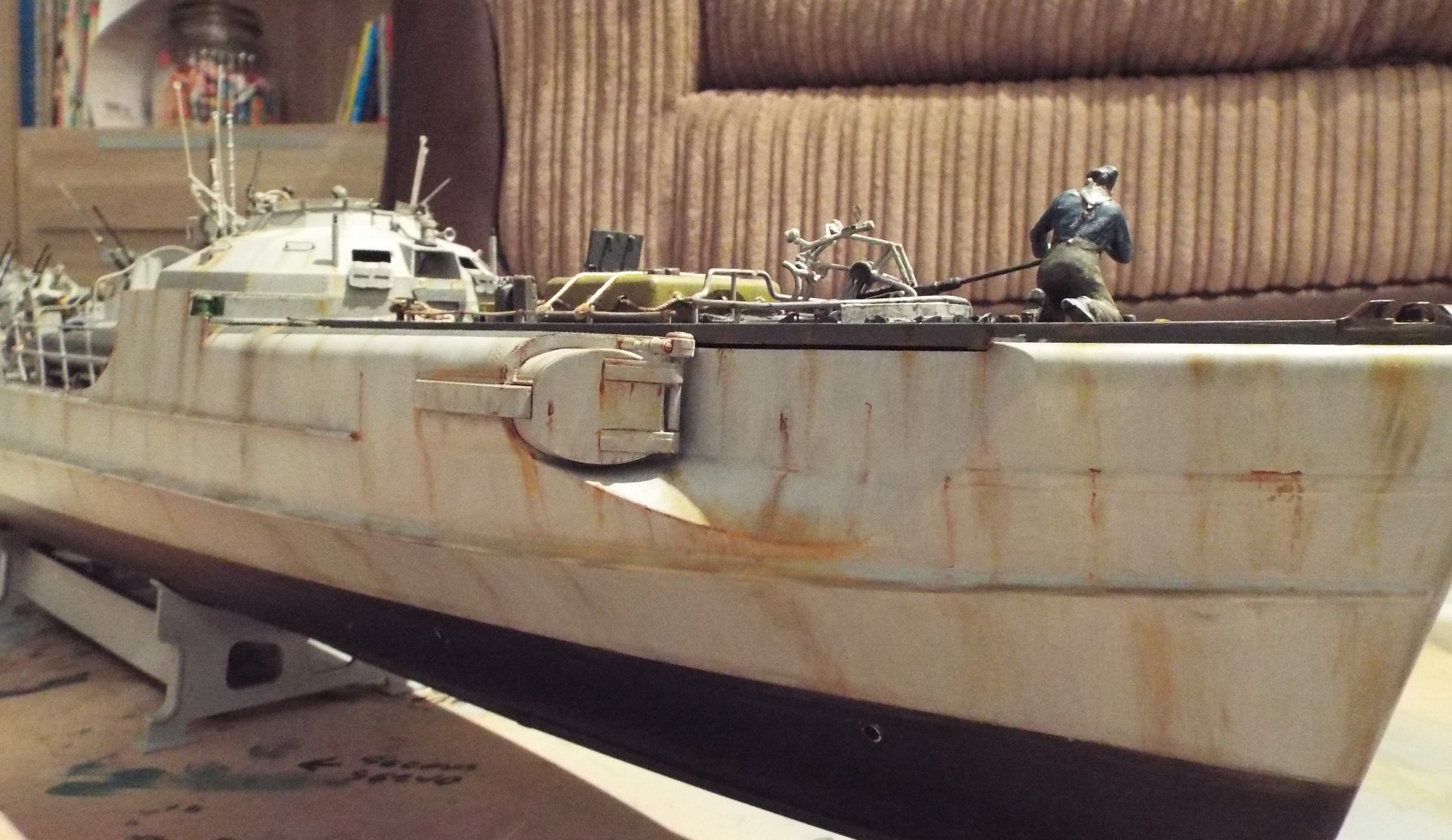

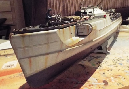

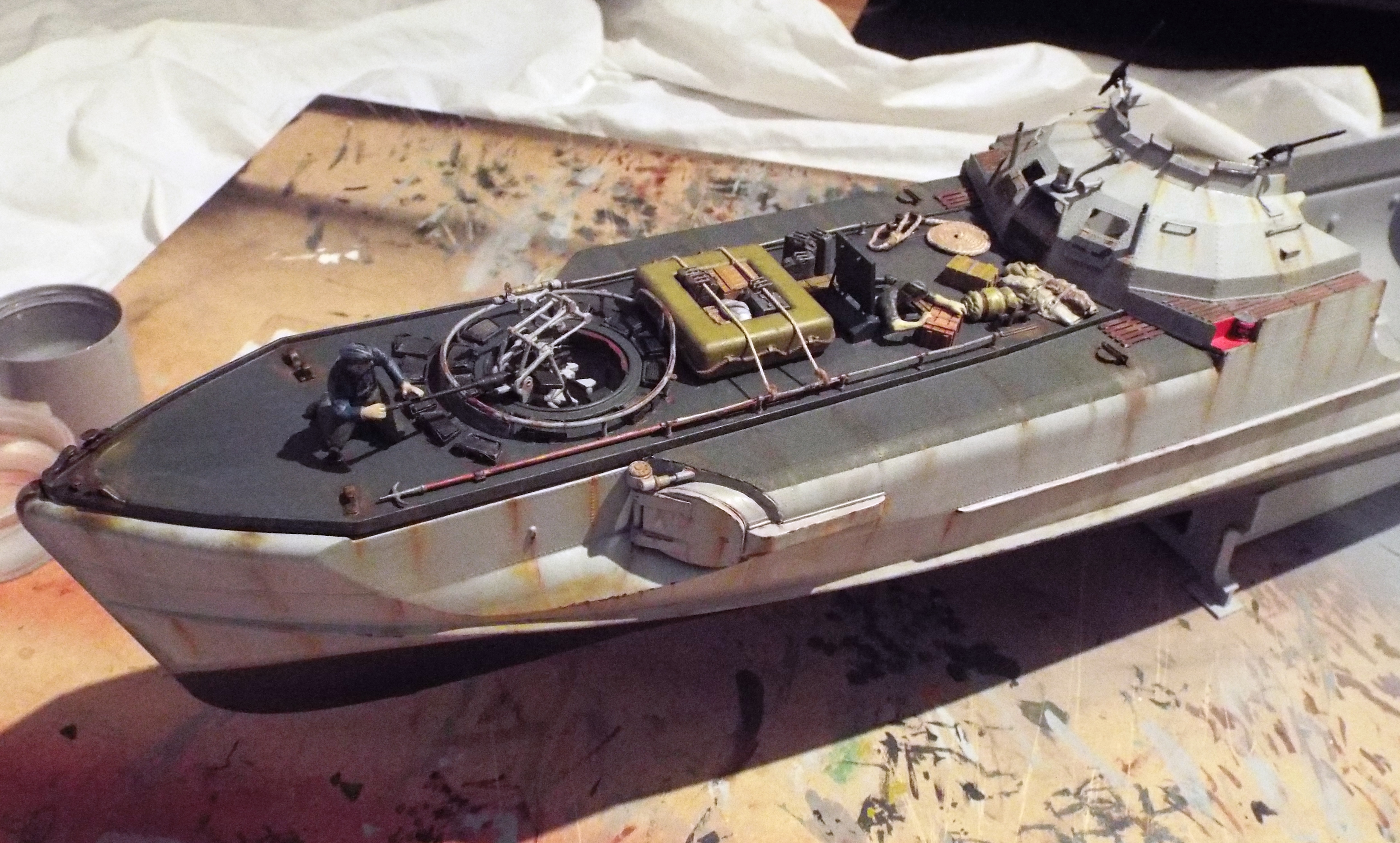

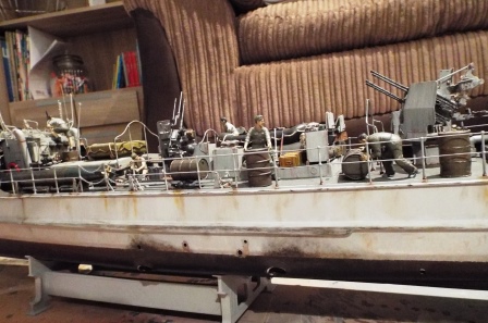

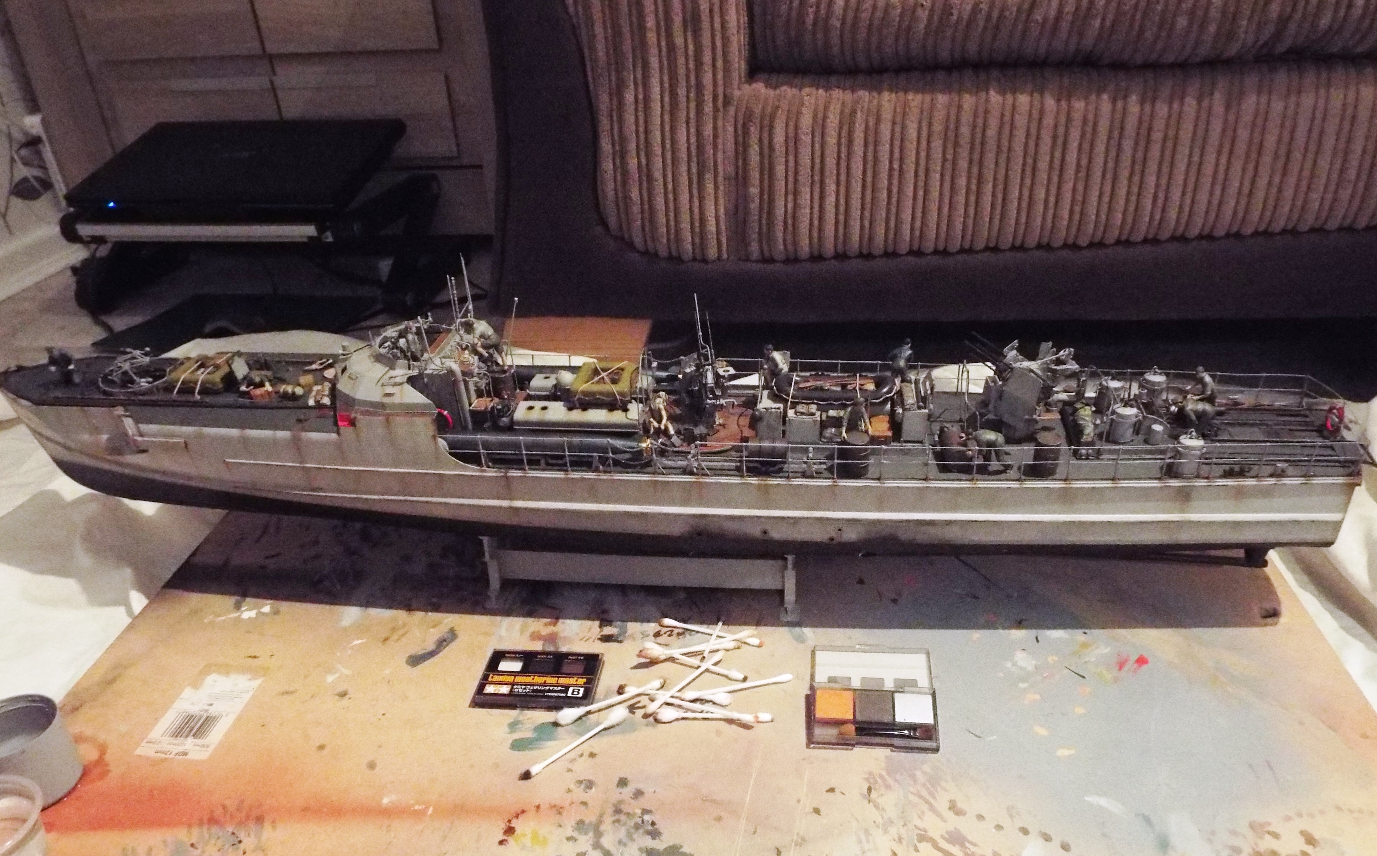

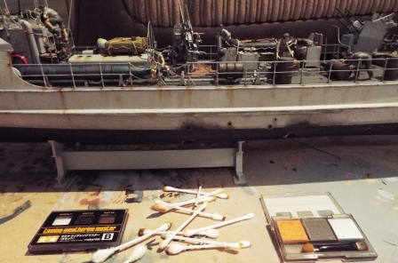

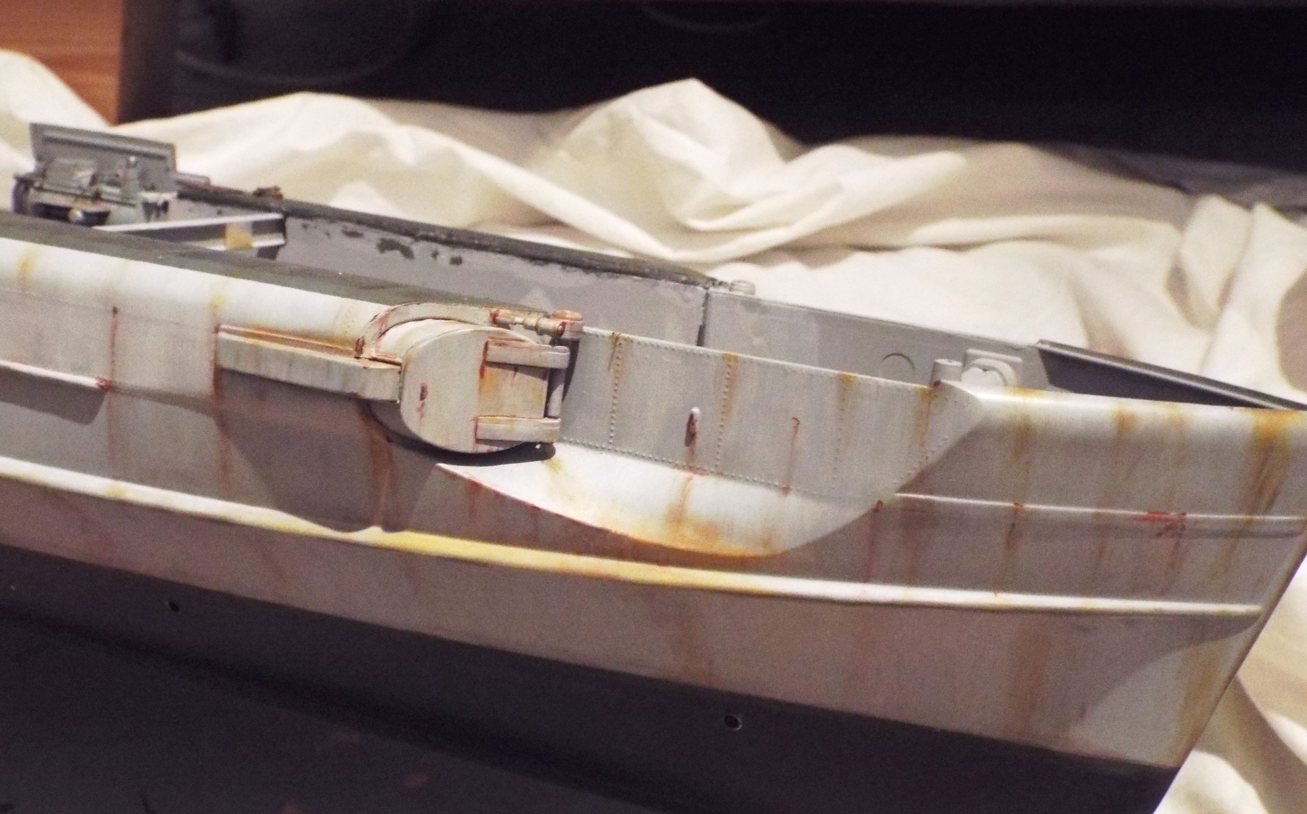

Made a start on the weathering of the Hull,.
Using photo's of well worn examples, I have tried to depict the hard conditions many of these vessels worked under.
Out night after night, no time to clean up between missions & replenishing.
All work carried out using brush, sponges, cotton buds, weathering pastels & acrylic paints.
Gregg

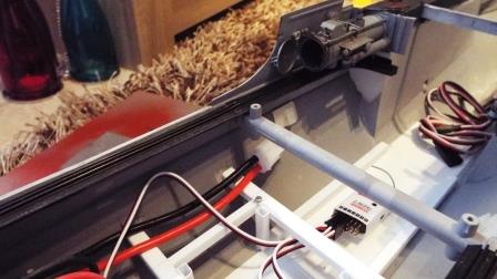

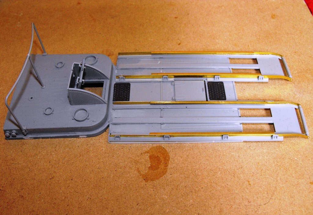

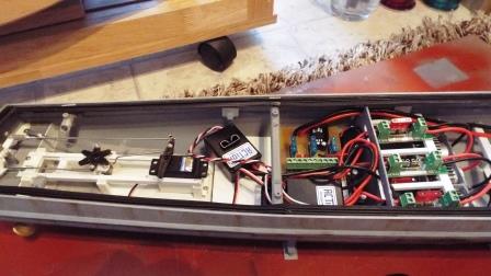

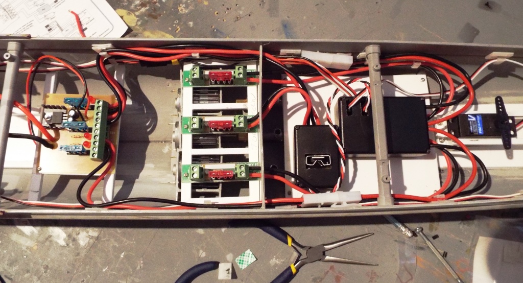

Electricals now being tackled, mixer and ESC's modules supplied by 'Action Electronics'
Temporary placings as bathtub balance test yet to be done, and receiver and cooling fans yet to be fitted.
Motors not yet wired up in case any manouvering that may be needed.

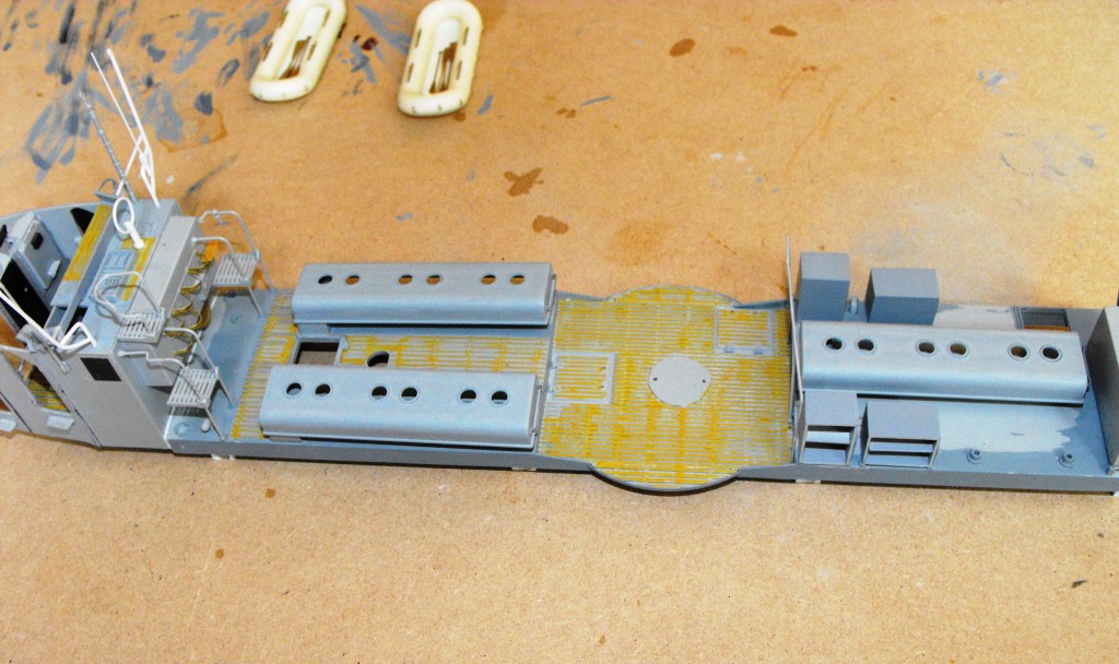

Waterproof seals fitted (windscreen wiper rubbers) Screwing the deck down compresses the blade vanes creating a seal.
Should water get past the first vane, there are two more to get by.
Almost there, maiden voyage imminent!

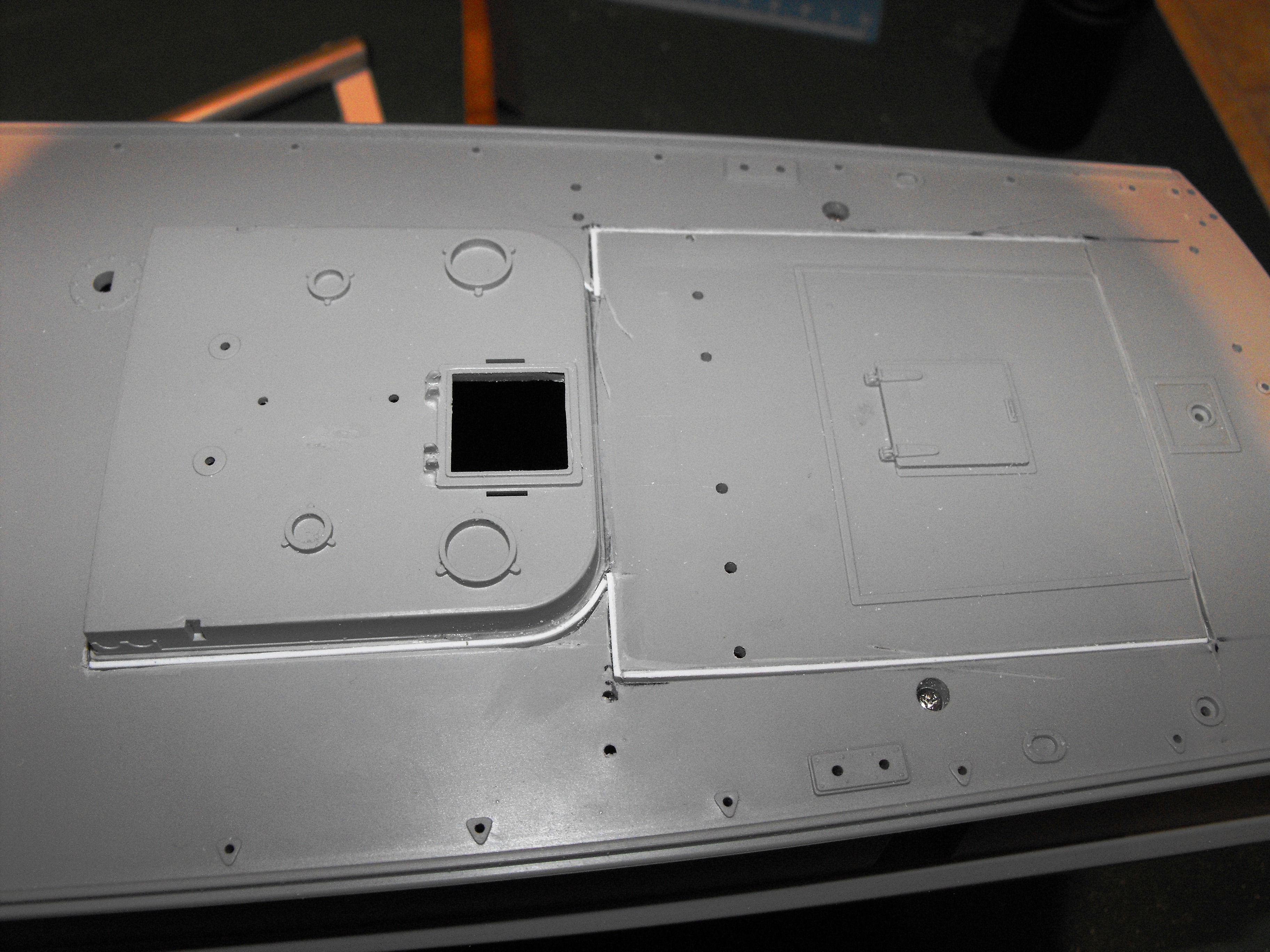

Old 07-10-2014 | 02:00 PM
  #41
Joined: Mar 2013
Posts: 65
Originally Posted by 1sgt
Ojays,
Great looking S Boat. Is the whole deck removable?? If so that would be great for getting at the RC stuff.
Jim

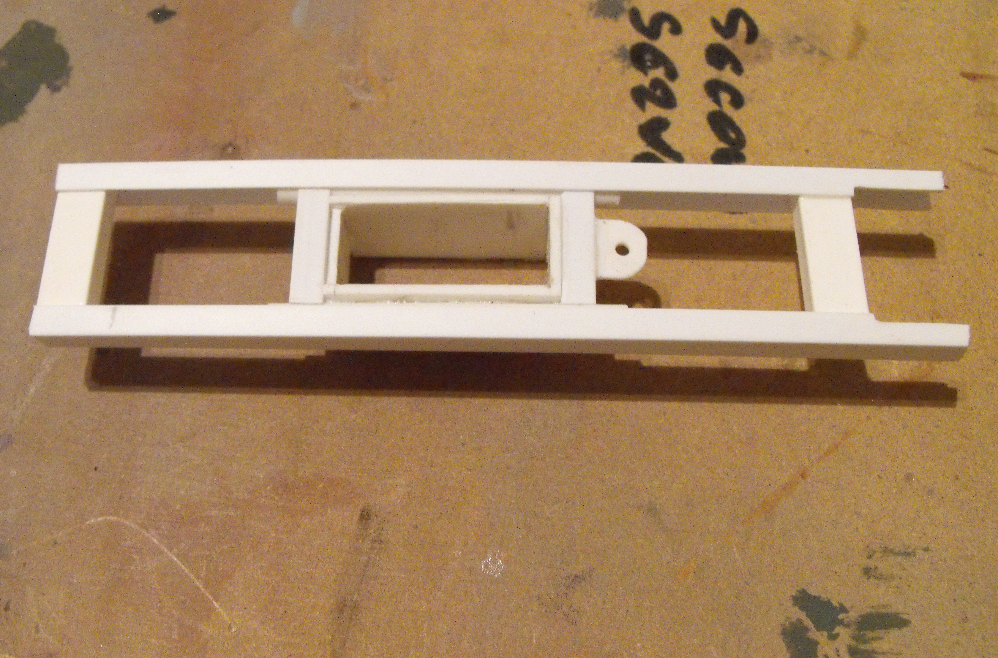

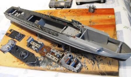

Thanks Jim,
The main deck can be removed for major work to be done, but is screwed down most of the time
Individual hatches are removable for pond side access, such as replacing batteries or adjusting servos etc.

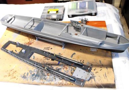

Photo's explain better!
