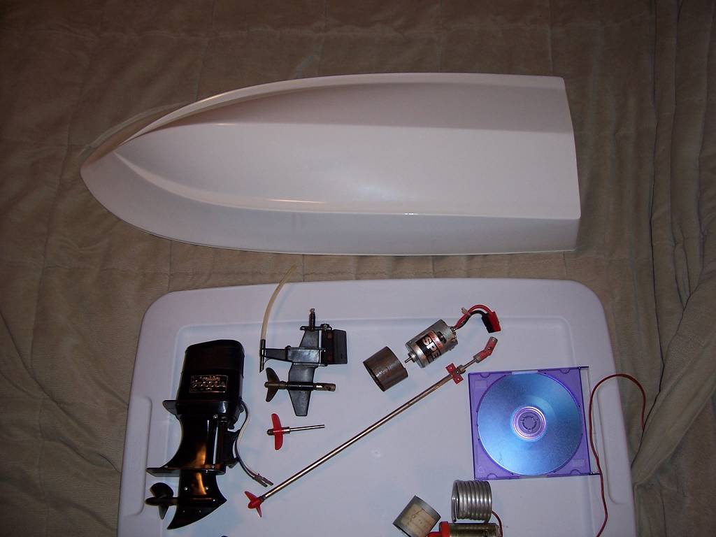

Ok guys, Help me choose. I have two outboards and two of the geared set ups. I would really like an EP-1 outboard for this hull but it's not in the budget. I am leaning away from the Roqua outboards because the videos Ihave seen of these in use leads me to believe I wont get up on plane. I won't go brushless as I am not looking for ultimate speed and Idon't like burning batteries.
DVDincluded for size reference

Here are the specs:
26" Fiberglass Epoxy Hull
Length: 26" inches
Beam: 9 1/2" inches
Deadrise: 15 Degrees
Weight: 1 pound

Speed 500, direct drive, possibly the larger red prop.

Bob you feel direct drive is the way to go on this one? I can change the motor itself and prop to whatever if need be.  I was planning on running two standard size stick batteries.  Hmm, I think you might be right.
That drive set up came out of one of these. 29" by 9" Before the ABS plastic hull disintegrated.  I always felt the prop was way to small
The two geared drives are from this which is roughly 36" by 7" but not a planing hull

The direct drive and larger porp is more likely to give you the planing you desire. If it is too much, switch to the smaller prop. You can also control planing with throttle.
The plastic boat the motor,drive shaft came out of was designed to go at a somewhat scale speed, thus the small prop.
That second boat is a Police boat. When push comes to shove the real one could get up and go.
Hang on to the geared motors. You may come on to plans for a tug one day and use them both for a nice powerful tug boat.

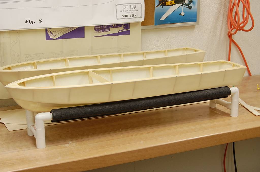

I got the hull from Tollytime over on rcgroups. He had one posted on ebay a while back and I contacted him a couple of weeks ago to see if I could purchase one. He is known for his PT hulls.

Since the boat can't go forward faster than the water being shoved backward by the prop, the prop needs to be smaller for more speed, and spin faster and/or have enough pitch.  Counter intuitive until you consider Newton's law about every action having an equal and opposite reaction.

I have to agree with "mfr02" on that point.  At least you have the two props tio work with so start with the smaller one.  Another point to consider is CoG, if the Center of Gravity isn't right the boat will not get up on plane either.  See my comment to Wayne on his Lobster boat build.
