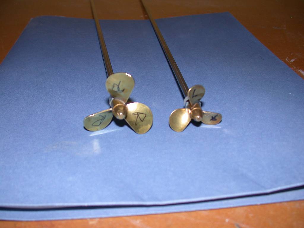

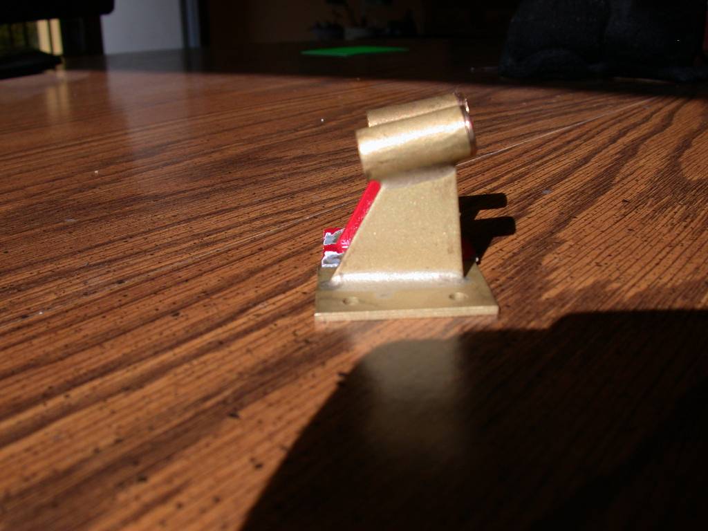

I got the 1 ½ inch prop from Dumas that I needed to complete the counter rotating pair. A new prop shaft will be used to replace the one with the gouges. Hopefully, that will do the trick, along with the new strut, to stop that screeching noise from the left drive group. You can see how much smaller the prop is compared to the 1 ¾ inch prop. Maybe it will help the performance and run time. I also included a shot of the old Ace cycler I use to monitor my NiCad’s health. Since I don’t run the boats that much, I cycle the battery pack for the R/C once a month. When they loose 20% of their original capacity they get replaced or are about 2 ½ years old, whichever happens first. Check out the difference in drop angle between the old strut and new one. Dan.

Even though it may seem 'counter-intuitive', many times I have seen that going to a smaller prop improves performance significantly. I'm sure you know Dan, but for those that may not, prop size is like the gearing on a car. Too tall a gear ratio, and the motor lugs, overheats, and speed suffers. (It's an inverse relationship. 2.56:1 is 'taller' than 4.11:1) Going to a smaller prop is like going to a lower ratio gear in a car. Of course, it's possible to go to a too small prop as well. And go nowhere.
There is a sweet spot that will be the ideal situation of speed, run time, motor temps. And it really helps if you have a box full of different props to test. That's an expensive proposition when using bronze or brass props. Thankfully, there are inexpensive plastic props that can be found, used for testing, and then a suitable bronze prop substituted for it when the sweet spot is found.

Tom, I took the Corvette up to the lake to give the new configuration a try. First, it was nice and toasty, 103 to be exact. The 1 ½ props worked just great. Performance was a little better and the run time went from a little over 10 minutes to about 14. The epoxied strut joint held as expected but is definitely not removable without a lot of grinding on the mount base. I’m going to be busy for a while so it will be a long time before I get a chance to get up there again. I’ll certainly check the weather prediction before I plan on it. I will send you a PM. Dan.
