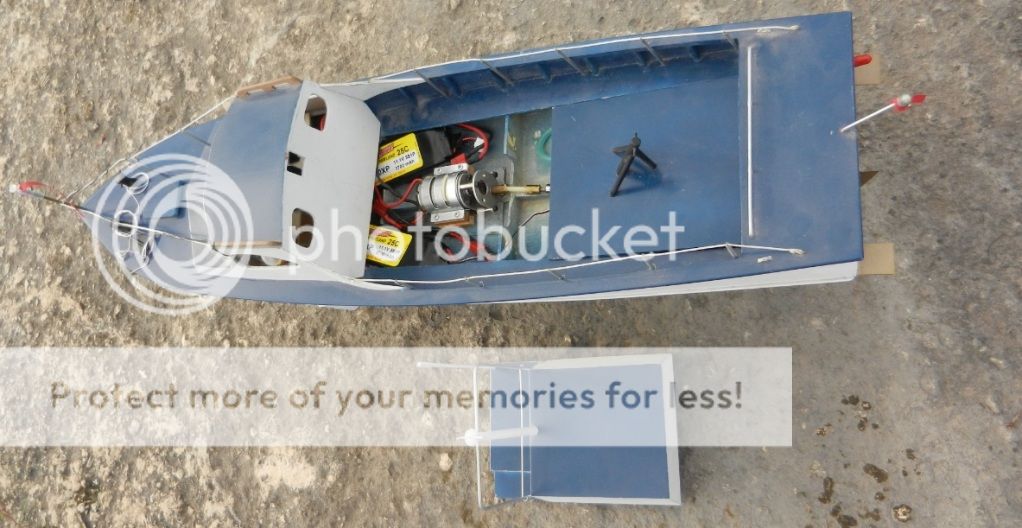

My good friend, Tony Lombardo of Titusville, Florida gave me my 2nd RC Scale Electric Boat yesterday. According to Tony it is his very first "Kit" RC Boat and I must say Tony did a great job on it.
Length of Hull: 32 1/2 inches long
Width of Hull: 9 1/2 inches wide (Widest Point)
Power System: Upgrade 600 Brushed Motor in gearbox
Motor Pinion Gear Count: 18 (Brass Metal)
Gearbox Spur Gear Count: 38 (Nylon Composite Material)
Therefore, the motor has to turn 2.11 revolutions for each complete rotation of the Spur Gear (Propeller).
EDIT: On 10-10-2012 the Great Planes Electrifly GD-600 Gearbox was installed giving the power system 2.5:1 ratio (Motor will spin 2.5 times for every Propeller Revolution).
ESC: Traxxas XL-5 Brushed ESC with Reverse
Radio: Traxxas 27Mhz 2-Channel

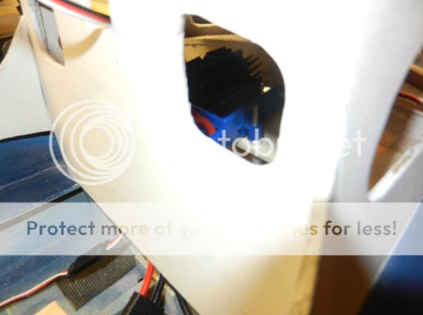

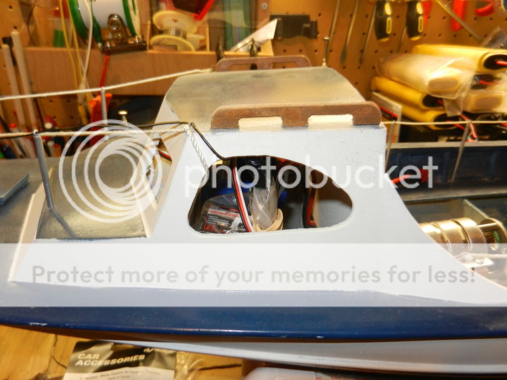

Here are a few pictures during the night in getting a large 600 size Brushed motor and Traxxas 15XL ESC inside the Model.
Terminator connectors, I decided to install 4mm Bullet Connectors to match up with the Traxxas XL-5 ESC.
Since the Traxxas XL-5 Brushed ESC is Air Cool with the Large Heat Sink, I made up a Lite Plywood Decking that sits inside the Control Bridge of the model for maximum Air Flow over the Heat Sink and it worked flawlessly!!!
I got really lucky as the ESC went in without any trimming of the side windows as this was the largest opening into the Control Bridge! You had to just be patient and in it went!
As a result of placing the ESC, the location of the Receiver was easy and used a plastic bag just in case water gets splashed on the unit as it is right at the window area!!!

During the third run of the model at our Moon Port Modelers RC Club in Titusville, Florida and for additional Photo Shoot session, Tony gave me back the controls and I noticed the motor did not have the Punch it exhibited during gradual throttle run ups so, I brought it to shore quickly. Yeap, the motor was very HOT to the touch and you could not keep your fingers on it.
I disconnected everything and turned off the radio system and fortunately the motor did not exhibit the "Burn" Smell yet and I blew on it continuously (like if that was going to do anything....).
We went back to Tony's place and wasted no time and Tony once again exhibited the Master Builder that he is and quickly made up a new Motor Bracket such that will allow Coiled Water Cooling for the motor.

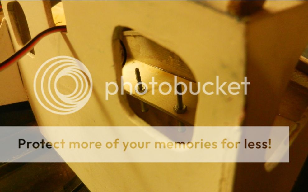

A few items that really bothered me during the Current Measurements while the model was in the Bath Tub. Ordinarily, one does not see the actual workings of the Power System while it is in water since the model is covered and moving away from you. Well, last night I had the opportunity to really watch and hear the power system and concluded the following:
1. The "No-Name" gearbox had to go since spare parts just could not be found and because the Gearbox Spur Gear was really worn and it vibrated the entire assembly at moderate speeds and including high RPMs.
2. I looked all over my hobby drawers and found a brand new Airplane Gearbox known as the Electrifly (Great Planes) GD-600 and I believe it is the 2.5:1 ratio.
3. The Rudder travel was fixed as reported earlier using a new Rudder Servo Arm and located the push rod assembly at a farther hole and that did the trick.
A few pictures of the new GD-600 Gearbox with the Stock Brushed 600 size motor.
Installed the NEW PINION Gear that came with the GD-600 Gearbox:
Carefully adjusted the Gearbox Mess:

Bob,
This is exactly what I covered in my Video of the "Dry" Test run from this morning.
I carefully angled the motor/gearbox assembly several times until the motor/gearbox and Universal Joint could spin at effortless manner without any hard points spots of stiffness. I did not start the Video until then.
The noise is just normal vibrations coming from the Dog Bone as it is in there somewhat snug and not tight so, it maybe creating some vibrations as it shifts a little.
As a matter of fact, the motor/gearbox assembly was at a higher angle with the previous Gearbox with the ruined Spur Gear and the angle was even more at a critical angle.
I hope and suspect that the up-and-coming "WET" Current Measurement in Bath Tub will exhibit even lower AMP Draw, not only taking account of the better angles but, realizing the more gearbox ratio of 2.5:1

Okay guys,
All I had to do is place a small folded up double sticky foam tape and keeping the adhesive cover and placed it underneath the bottom end of the plastic gearbox frame (part does not get hot) and the motor was raised enough to keep the Universal / Dog Bone straight like an arrow!
Of course the Bath Tub was filled once again and this time I allowed the water to go up a few more inches and testing began while Video Recording.
Just a few Still Pictures before the Video....
[b]TEST RESULTS:[/b]
1/4 Throttle: 3.3 AMPs, 38 Watts
1/2 Throttle: 6.0 AMPs, 73 Watts
Full Throttle: 15.0 AMPs, 172+ Watts
[youtube]http://www.youtube.com/watch?v=VbD5qhjN9Lg[/youtube]
