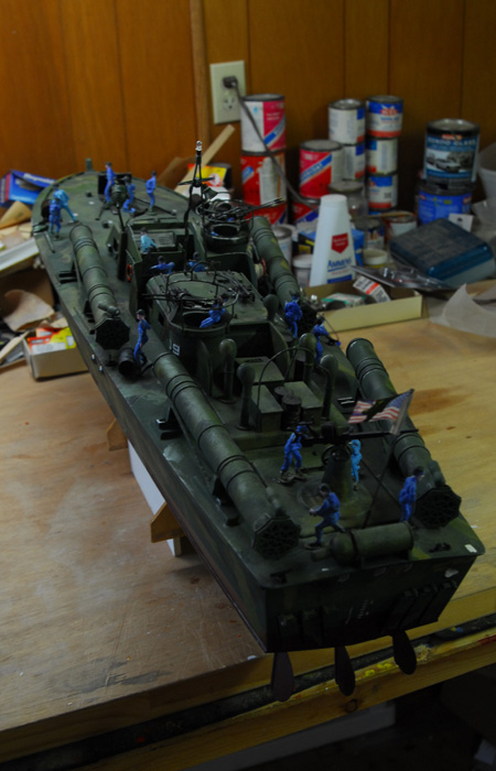

Someone doesn't know anything about PT boats as they were never painted like that in combat areas. In the Solomons in 1942/3, when a new boat showed up with OD green and brown scheme, it was repainted grey and the large white bow numbers were not redone due to visibility issues. The boats survived by stealth and having huge white numbers on the bow would make the boats easy to see, even at night over a long distance. My advice is to strip the boat down, repaint it in a proper grey and lose all the army men. If you need to put a crew on board, make them more scale appropriate as what the person put on are way too small

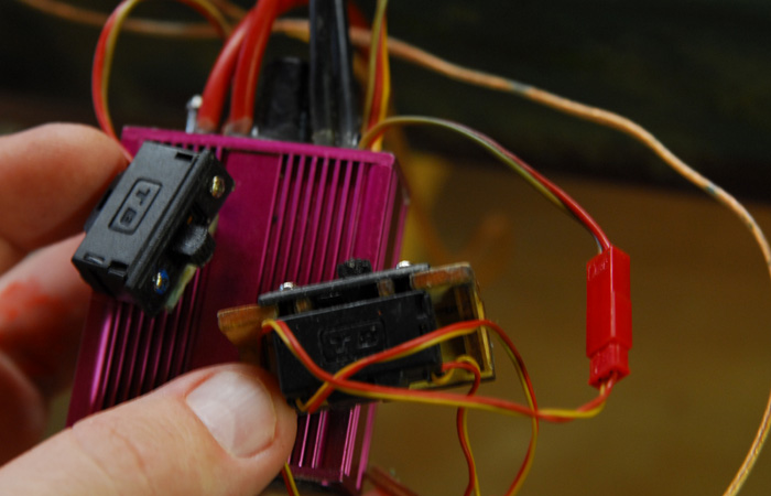

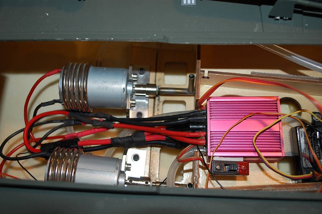

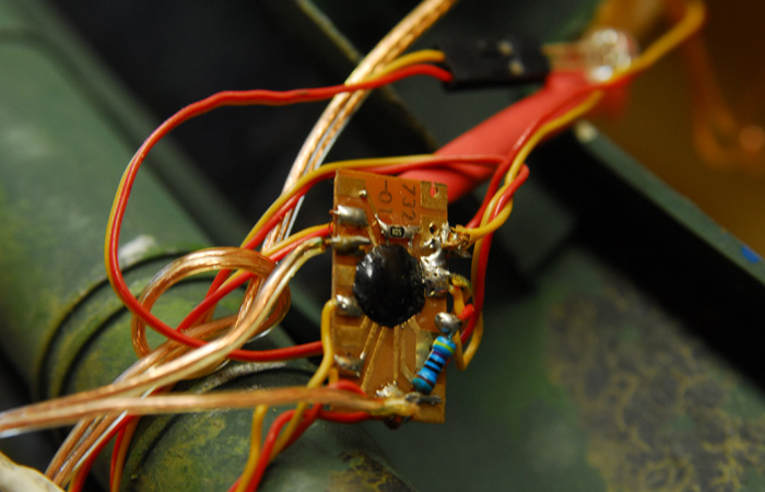

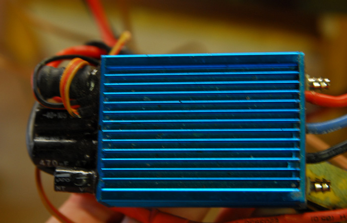

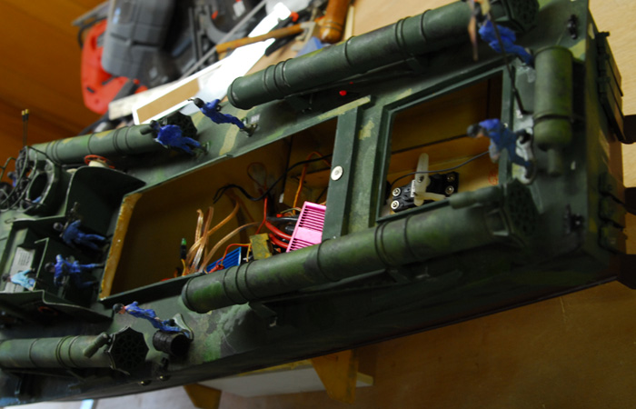

You have a brushed esc there (red one) and a brushless esc from a Miss Geico cat (blue one). Very different in what they will run.
I'd personally get another brushed esc, if you can find a match, rip out all the wiring and start from scratch.
The motors are antique technology but good enough for a scale boat.
I'd stay away from the dumas crap, over priced and not very high quality at all.
Could probably run a pair of car esc's as well if they have cooling fans on the heat sinks. Should be a pretty low amp draw setup.
Nothing wrong with the graupner motors, be better than Dumas that's for sure. Not worth replacing all that stuff unless they don't work.
I think you just need a pair of matching brushed esc's, a Y harness to connect them both to the RX, and batteries.
Looks like a nice boat, just about everything there to make it run.
BTW you could get about 50$ for the blue esc used.
Please Do Not waste money on that dumas speed control, antique technology! For far less you can get a modern esc with many more options and better amperage ratings than that old 70's POS!
For about 5$ you can get a 20 amp brushed esc from HK, need a heat sink added but it would work.

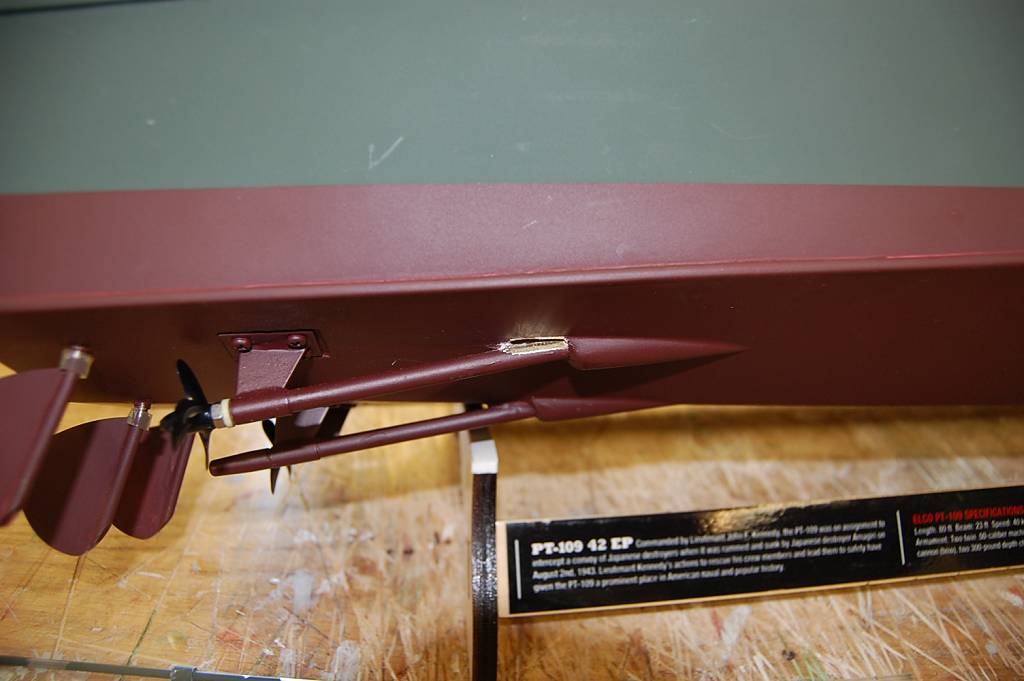

SERVICEBULLETINALERT!!

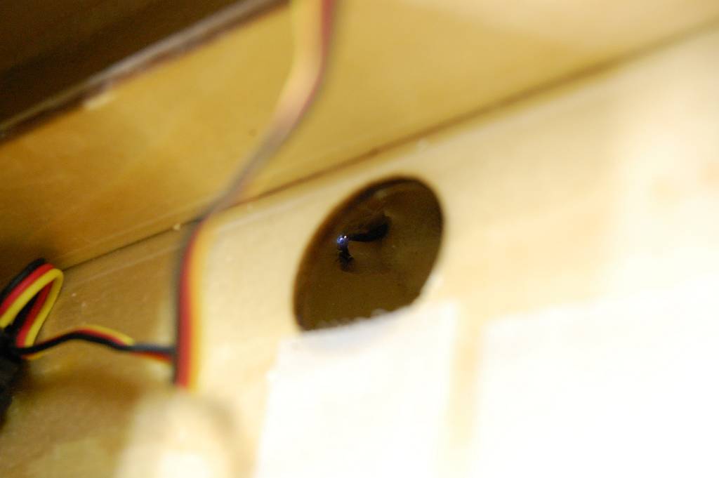

I purchased a ProBoat PT-109 "AS-IS"that was previously returned to a online hobby distributor. The boats electronics were tested and functioning at the time it was purchased. There was some broken parts on the deck, but nothing that couldn't be fixed. I dropped in the batteries and took her out on the pond for cruise. She got on plane and handled well for a boat her size. I stopped and noticed the stern was low in the water.
It was sinking!! Yep, she was goin down!! I hit the throttle and grounded her in a soft patch of weeds. After draining out the bildge, I didn't see any sign of holes. I brought her into my work shop, turned off the lights, and stuck a high powered LEDflashlight in the bilge. The flashlight revealed some careless mistakes madeby Chinese slave labor camp that built her. There was pinholes all around the stuffing tubes that were letting plenty of water in. Not enough epoxy to make a good seal.
I picked at the epoxy and it just flaked off all aroung the stuffing tube.
I'm pretty sure this is something you should check.
I plan on converting this boat to brushless this summer.

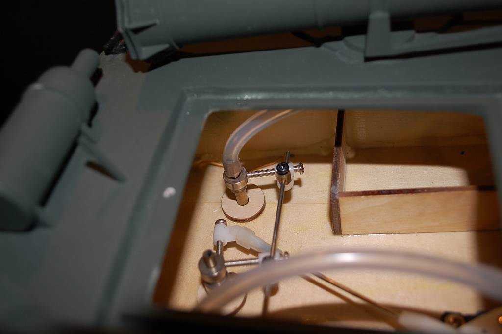

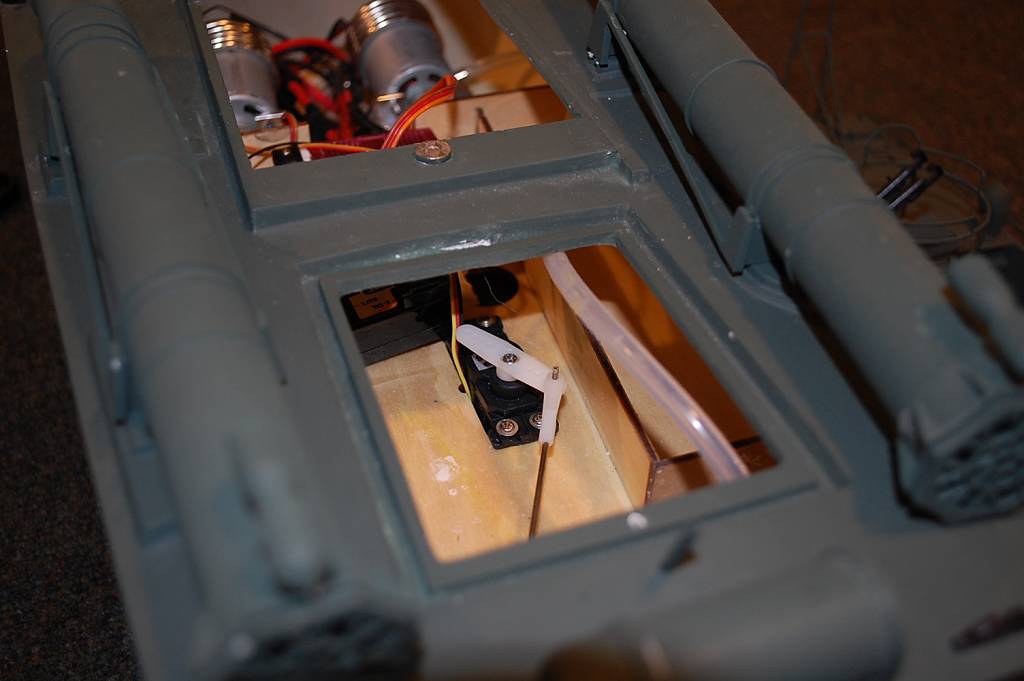

Here are some more pictures of the inside.
What's missing from the drivetrain?
(2) 550 motors: (PRB3105)
(1) SSDriveshaft kitwith motor couplers (PRB3605)
(1) Cooling system kit (PRB3607)
(1) Motor mounting Kit (PRB3608)
(!) Propeller kit (PRB3621)
I'm not sure ife you need new stuffing boxes or not.

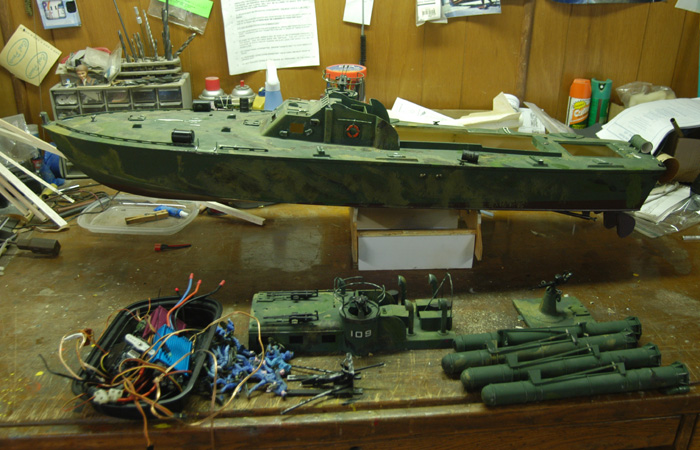

With winter still holding on tight I got out the water bucket and wet/dry sand paper and went to work. I didn't bother to go all the way to the surface as I wasn't worried about weight, I just got it smooth enough to make a nice paint surface. I then got out some Model Master flats that I already had and sprayed. I thought about going with grey but I already had this and have seen some PT boats in this color. I'll be doing a good bit of detail hand painting the next day or so and then I guess I'll start ordering some running gear. Hopefully it will be in the water in a week or two.

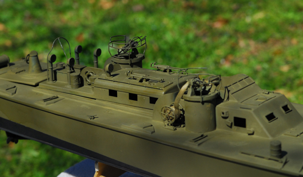

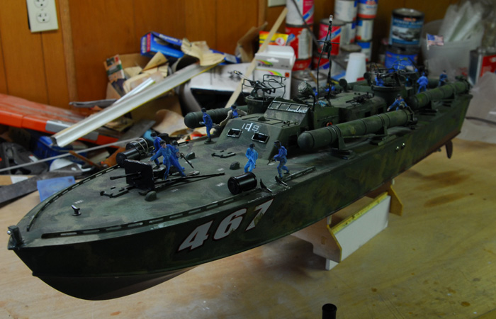

Let me throw some some fuel into the fire. Here's info on the boat from the first picture:
Laid down 17 June 1943 by the Electric Boat Co., Elco Works, Bayonne, NJ
Launched 4 September 1943
Completed 16 October 1943
Placed in service 22 October 1943 and assigned to Motor Torpedo Boat Squadron TWENTY NINE (PTRon 29) under the command of Comdr. S. Stephen Daunis, USN
PTRon 29, assigned to the Mediterranean, based at Calvi, Corsica, and Leghorn, Italy, and had action along the northwest coast of Italy and southern coast of France, operating under the British Coastal Forces
"Hairless Joe" was transferred to the Soviet Union 7 April 1945 and reclassified TK-434
Fate unknown.
Specifications:
Displacement 56 t.
Length 80'
Beam 20' 8"
Draft 5'
Speed 41 kts.
Complement 17
Armament: One 40mm mount, two 20mm mounts, four 21" Torpedoes and two twin .50 cal. machine guns
Propulsion: Three 1,500shp Packard W-14 M2500 gasoline engines, three shafts.

That all being said, there is documented orders to repaint boats completely grey IN THE SOLOMONS to make them harder to see. In books about the boats serving in the Solomon Islands I have read, a camo boat was considered a liability. The boats were out in the center of the chanels between islands where camo would not be as effective . As for PTs in the Med, they were used differently as the environment was different. I do know they were used in conjunction with British F-lighters to combat the German steel hulled torpedo boats and may have used the camo to hide inshore until the German boats were sited but that is a guess as I'm not as studied in that theater. As for the last picture, it was taken just prior to Japan's surrender and would probably have been used close inshore to combat Japanese barges as there wasn't a larger target left, thus the camo would have been usable. The middle picture was an early 77ft Elco, PT-20 class. Could have been one of the boats sent to the Phillipeans with Ron 3 where hiding during the daylight hours would have made the camo helpful against Japanese aircraft and surface combatants as they had no real base to operate from after the first few days of the war. I saw a picture of the six boats on a tanker taking them to PI that shows them completely grey as well so it could have been something the crew did trying to survive. It is also possible that shot was taken in the South Pacific with Ron 3(2) in the Solomons or New Guinea , as some of the 77 footers were used in those areas until 1943 when many were pulled due to being obsolete.

For batteries, a pair of 7.2v 4200mAh Duratrax NiMH is what I use. Duratrax makes a 8.4v 4200mAh NiMH with 7 cells, for an extra boost in performance.
I have only used the factory battery trays near the rear of the boat since I've owned it. The battery trays are actually a part of the boats inner wood structure just in front of the rudder shafts. 7 cell battery packs will fit.
I have never tried ballast, but I haven't run it that much yet.
ProBoat seems to have run into a motor mount shortage. A PRB4211 should work just fine. You can find them on Ebay.
The is shaft coupler is 4mm on one end and 1/8" (3.175mm)on the other. You have an M4 shaft (4mm) and the motor is 1/8" (3.175mm). You have to buy the shaft kit to get them (PRB3605)

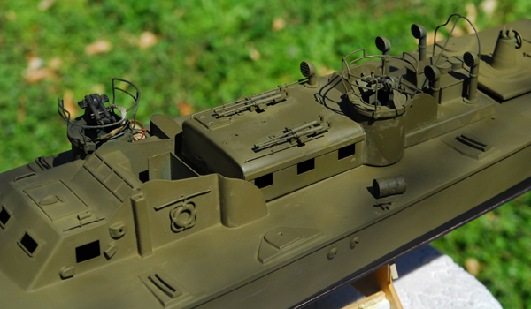

It runs! I had to wait on a few parts, the couplings from engine to drive shaft were unavailable so we found some others that worked. I took the motors that were sold to me with the boat and removed them from the gearboxes, brushed motors very similar to the originals. It took less time to form some sheet metal into motor mounts than to search the web and order them and although I'm not much of a sheet metal mechanic and they aren't pretty, they work. I also had to sleeve the output shafts to fit the couplings from the motor but again a simple matter. I put new factory props on it. Before I put it in the pond I floated it in my bathtub. It sat well but was leaking from the back. I had already plugged the hole a previous owner had drilled for a center prop shaft and suspected a leak around a skeg and painted resin around all three to be sure. Then on to the pond.
It looked good sitting still in some calm water. The winds had died following a storm yesterday. Nothing to do but push the throttle forward and it really took off! I tested steering and throttle response and was pleased. High speed runs look to be around 12 to maybe 15 mph. I think the nose was a little high at speed and will ballast the front before running it again. I brought it in after about 10 minutes and found it was still taking on water. Dumped it out and saw nothing obvious but I'll inspect it more closely. Put it back in the water as the batteries weren't anywhere near exhausted. I was dodging a couple of floating branches when the boat clearly struck something at speed, either a fish or my dad thinks a snake. Whatever it was was undisturbed and I saw it continue to swim close to the surface for several more minutes. Anyway it lost a lot of speed so I brought it back in to find one of the props missing! Damn! It hadn't unscrewed but the plastic had separated from the metal inner sleeve that threades on to the shaft. New ones are on the way. Also you may notice in one of the photos an aft torpedo tube came loose from it's front mount and is dragging which occured in the collision.
As always I discovered a few problems. There is a poor solder joint to one motor terminal which will have to be re-done. The balance problem should not be difficult. I did notice that the cooling system was not working. I didn't expect a large jet of water that I see in our gas and nitro boats but there was nothing at all. Checked the motors and ESC, all were quite warm but not hot. I could probably leave it alone but since I went to the trouble and expense of installing it I want it to function. And I have to sort out the leak problem. I always expect a little leakage but this is too big to just ignore. Besides, until the new props get here what else have I got to do? I'm very pleased with this project. It was pretty rough when I found it. These boats were orginally selling for over $400 apparently but I'm into it for a $50 purchase price plus maybe another $75 in parts. That includes a motor I bought but didn't use. There is maybe 20 hours of work in it, probably less. Now that it's been tested I'll also install a light kit and put appropriate insignia and a flag. I'll do something to make the antenna less noticable also. And I still have those painted-blue plastic army men if anyone needs them :-). So where is a scale boat club to be found in Central Alabama?
